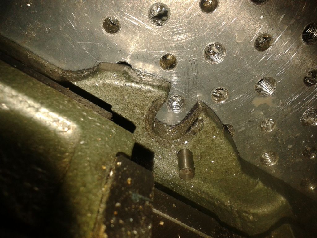

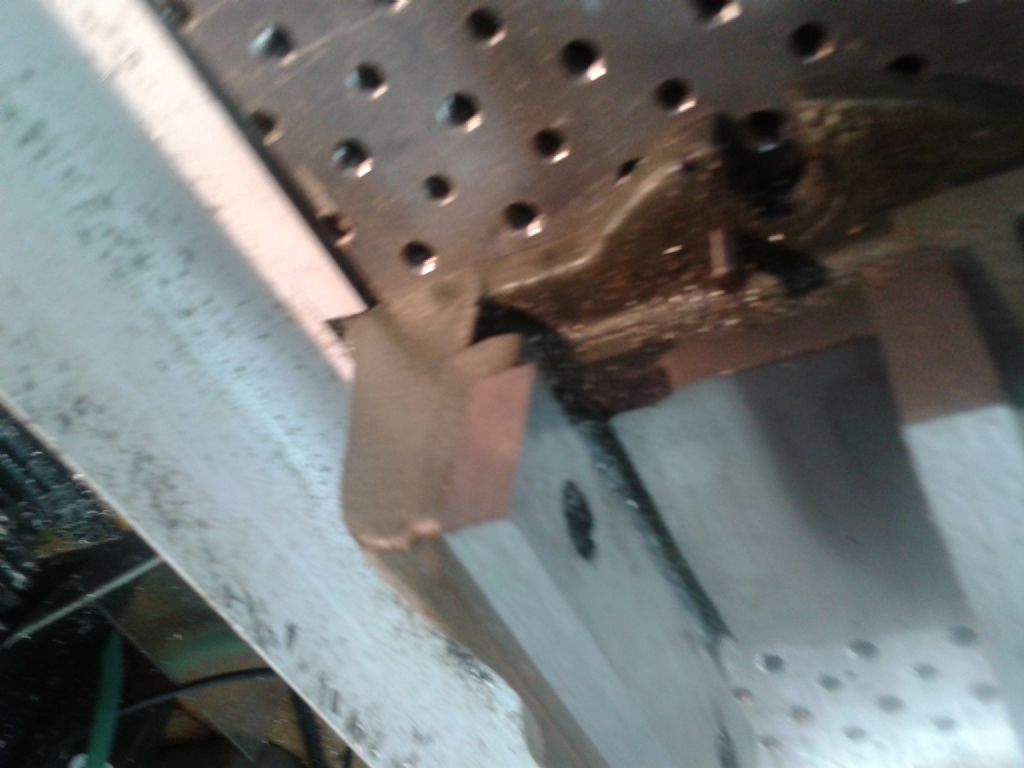

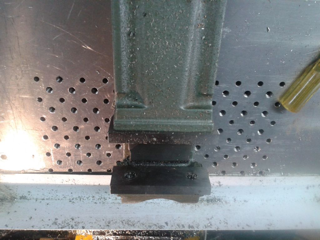

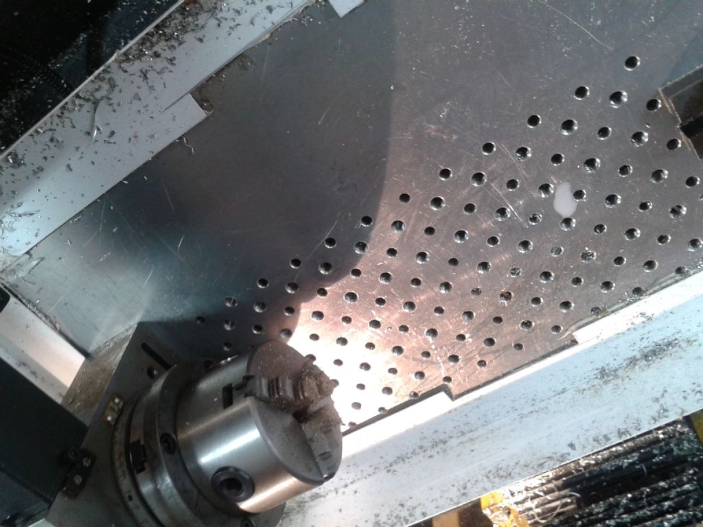

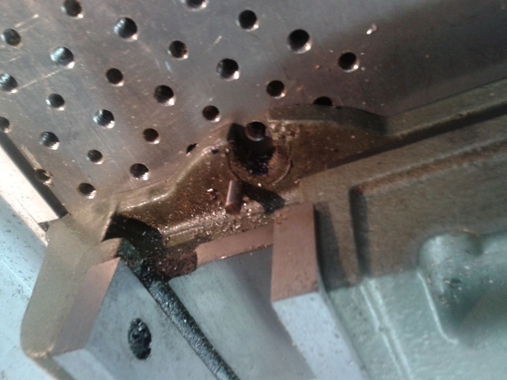

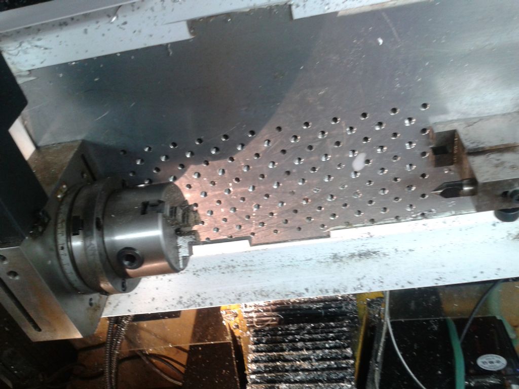

                                Hi
                                got my x4 just after xmas this year first thing i did was order a .5"x 20×10" alloy plate drilled and tapped m8
                                reamed 6mm in a grid pattern the 4th axis now sets outside the work area giving a greater working area same with tailstock
                                the vice i drilled and reamed to suit grid now no need to clock vice everytime
                                got rid of original guard and made my own all works great
                                over the moon with my machine how are you getting on with yours
                                all th best geoff

                                  geoff adams
                                    @geoffadams14047
                                    Hi Tony
                                    will post pics of my subplate tomorrow need my boy to do this
                                    learn g code he hard way back in the 70s early 80s only a calculator no computers then making aircraft instruments
                                    only just got the hang of emachineshop cad and cambam cam does made things easy
                                    been out of engineering for 30 odd years got back into it on retiring 3 years ago
                                    making model steam engines
                                    Geoff
                                    if i can help give me a shout

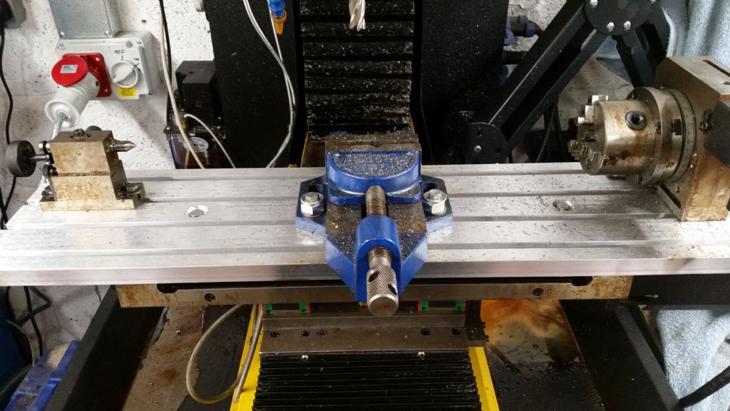

                                      Antony Powell
                                        @antonypowell28169
                                        Hi Geoff
                                        Yes I had that problem, i uploaded them upside down so that when the came online they were right side up !!
                                        no idea why I'm not big on computer problems it's mainly guesswork.
                                        I bit the bullet and ordered an 800 x 200 mm vac plate with full tee slots from the company I found on line perfectly flat both sides so should bolt on OK probably expensive by most peoples standards at £164 inc vat but i don't have the time to mill my own slots or drill a hundred holes and tap em out.
                                        Will post some pics when it arrives and i get it fitted
                                        Tony

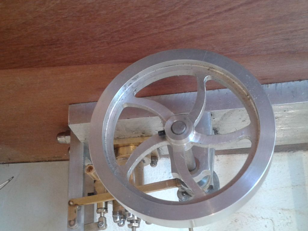

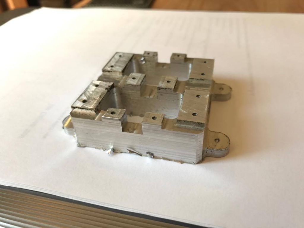

                                        #300008

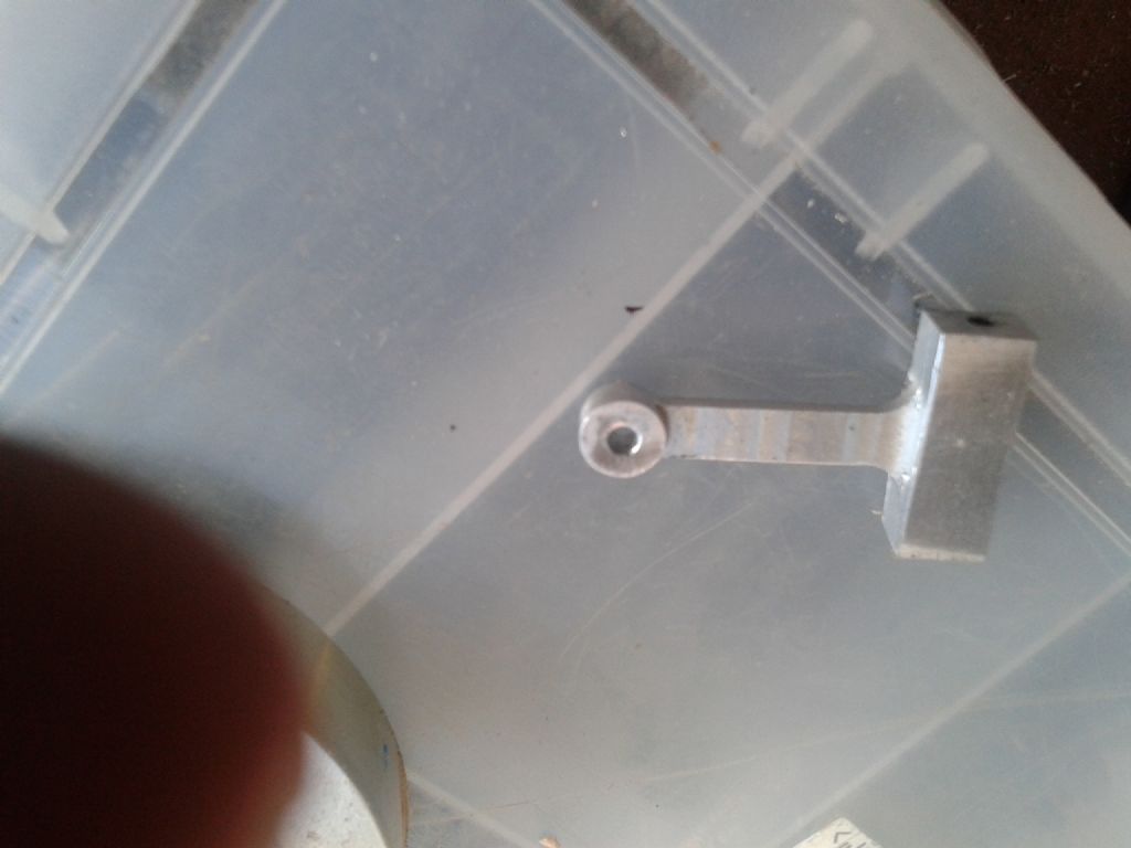

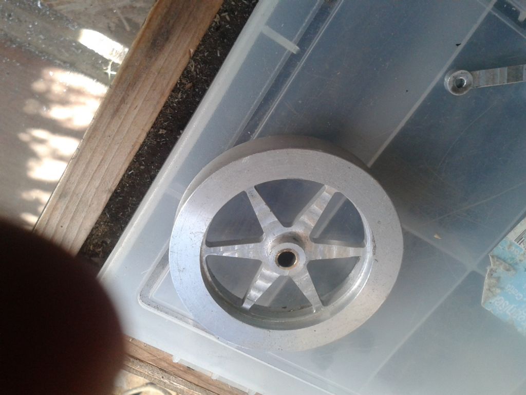

                                        geoff adams
                                          @geoffadams14047
                                          Hi Tony
                                          sorry pics still upside down one shoud be ok part i made today
                                          hope these help
                                          Geoff

                                          #302238

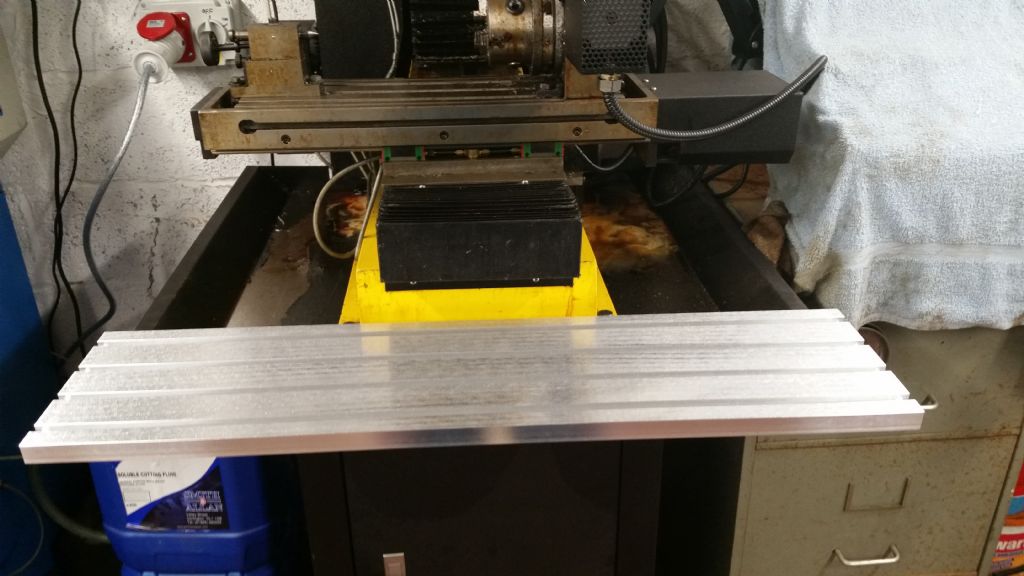

                                          Antony Powell
                                            @antonypowell28169
                                            This image shows the plate before fitting to the bed
                                            And this one after the install, makes a big difference and allows items twice the origional length to be worked on using the 4th axis
                                            Tony
