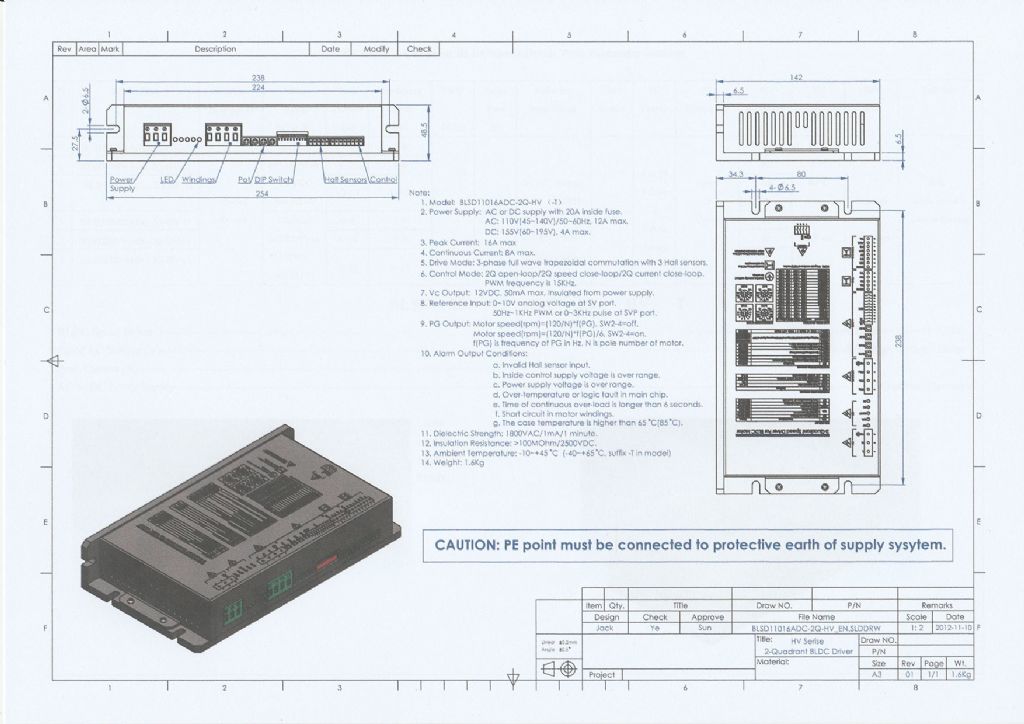

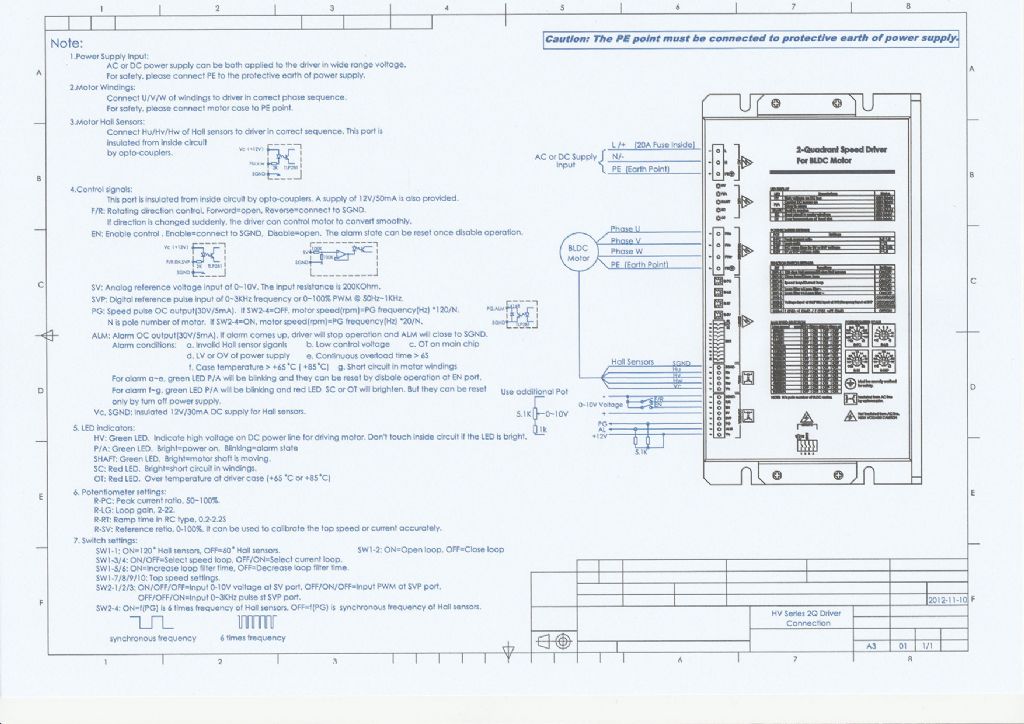

                  #428680
                  Mike Palmer 1
                    @mikepalmer1
                    I have found a motor driver suitable for the 230v DC brushless motor.
                    I connected power in to windings also hall sensors, and set various switches but no movement from spindle.
                    I have attached specs and notes, any help would be appreciated
                    Thanks
                    Mike
                    Edited By Mike Palmer 1 on 12/09/2019 12:07:11

                    #428687
                    Ian P
                      @ianp
                      I know nothing about a Syil X3 CNC milling machine but are you saying it is fitted with a 230VDC brushless motor?
                      A brushless motor only becomes a 'DC' motor when it is combined with electronics, the motor itself is driven by several windings and they need the correct AC type waveform to cause the rotation.
                      The diver you have bought might be entirely suitable for the motor you have but the wiring between the two must be correct, most likely the fact that it is not running now is either a wiring difference or some other incompatibility.
                      What details are shown on the motor rating plate?
                      Ian P

                        #428708
                        Ian P
                          @ianp
                          Mike
                          That does not give any details that would allow anyone to choose or wire up a controller.
                          Ian P
