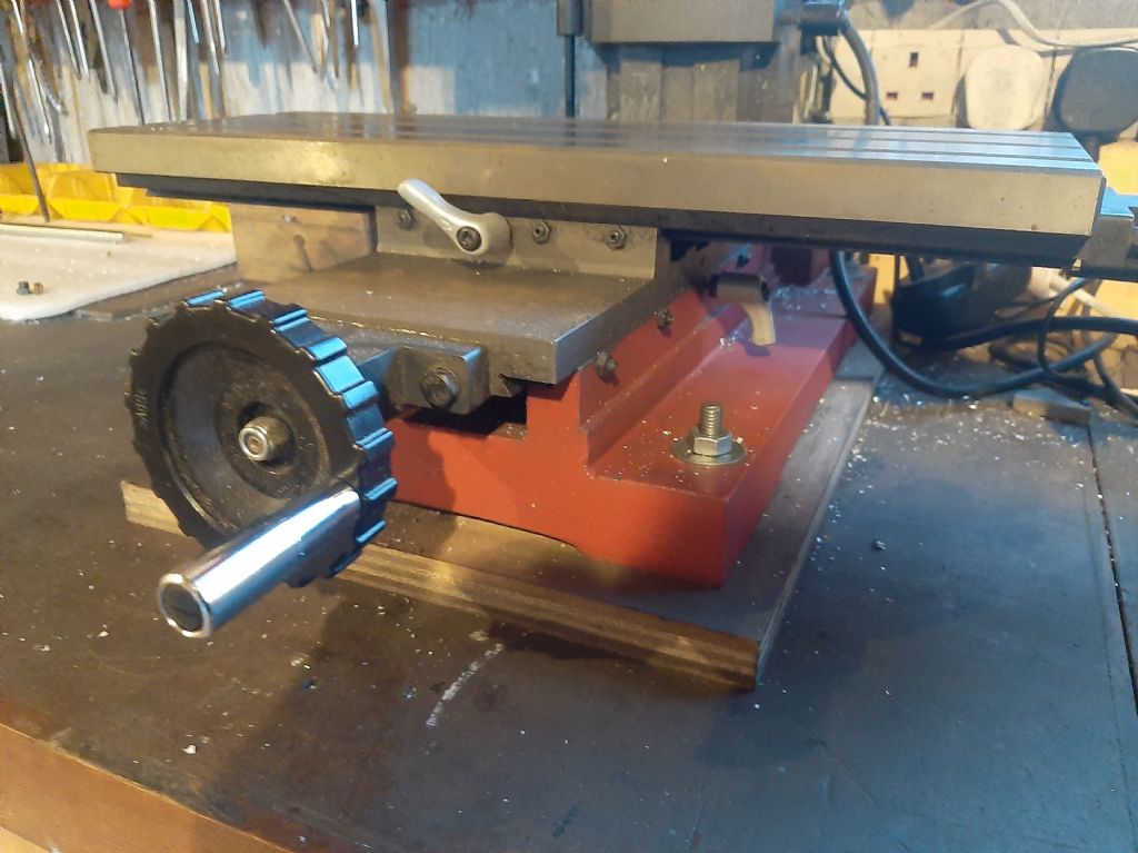

                    I put levers on mine, like Jason said saved messing with an Allen key especially underneath the slide.
                    Can't remember where I bought these but I noticed goodhanduk have 4mm levers in stock. Take care to make sure you get the right screw length.

                        Geoff, thanks for the pic (tells 1000 words) and a possible source of lever.

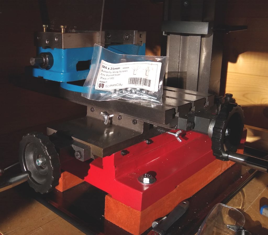

                          I've replaced the X & Y axes Capheads with Butterly Wing Screws (M4 x 25 mm from Amazon).wing screws 3 crop.jpg
                          I haven't fully tested them out on a project but they appear to be 'good enough'.
                          Moderate finger force can nip them up sufficiently to take the slack out of the table and saddle. And they are reasonably easy to reach by hand – no tools required.

                              I did also try thumbwheel screws but the finger leverage wasn't sufficient – the wingnuts have a longer lever arm.
