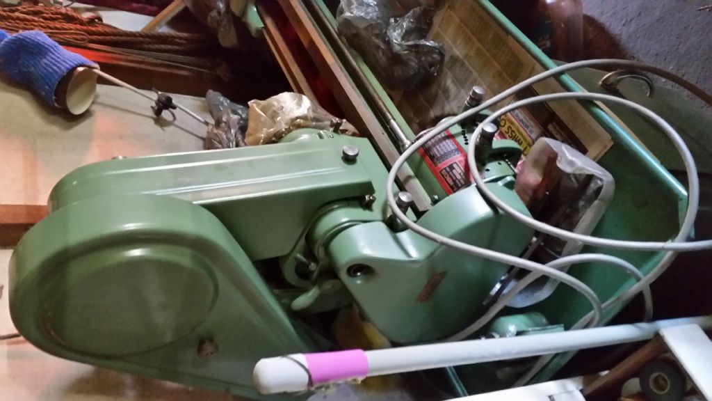

      I have just seen a lathe from a deceased estate in as new condition, with immaculate paint, etc., It has a custom make vinyl cover, and the 4 jaw was still unused in its original bag. It is a Hercus, probably 1960's. However, unaccountably, there was surface rust on the ways. At some point, it must have been uncovered for a significant period, I suspect after sudden illness or accident, as the gentleman took great care of his tools. The question is, how much of a problem is this? Will it come off with a rub over with oiled 1000 grit wet and dry or what? Otherwise this is one of those dream finds. Think Super 7, only bigger, 4-1/2 c.h. I think.

        Simon Collier
          @simoncollier74340

          Neil Lickfold
            @neillickfold44316
            The picture is not really good enough to make a call on that. I find that if the fine grey scotch brite or at most the redy brown scotch brite does not clean it up, and it is all pitted, who knows how much damage there is. I did a fixup on a Tesa comparator that has surface rust on it. The owner thought it needed to be reground and lapped again. From the tests I did, the main table was still very good. So we got lucky. But on a toolmakers vice that went rusty in my shed from a roof leak, it pitted so bad, that it took 1mm to clean up both sides, .5mm on each side that was rusted. That really ticked me off that was for sure.

            Nicholas Farr
              @nicholasfarr14254
              Hi Simon, I would have thought that a rub down with a wire brush, followed by cleaning with penetrating fluid and rag and then oiling would be OK. I would be reluctant to use any abrasive on it myself.

              Lambton
                @lambton
                Simon,
                Start with oil and fine wire wool. This will remove surface rust without removing metal. I would then leave any pitting alone as it will help to retain oil.

                Alex Collins
                  @alexcollins55045
                  You can clean the surface rust off with Scotch Brite. I'd not use anything more aggressive than that. Certainly not wet n dry …..
                  ​Give the bed a good coat of slideway oil afterwards.

                  Simon Collier
                    @simoncollier74340
                    Thanks for the replies. It is still in the late owner's workshop, not mine. All I could do during a brief viewing was find some WD40 and spray it all, not ideal but better than nothing for now.

                    Bazyle
                      @bazyle
                      If you ran the saddle up and down to try it out you will need to take it off and clean underneath.
                      Vinyl covers are a bad thing, even though they were sold by lathe manufacturers. They were intended as dust covers in a heated industrial workshop. Use a cotton sheet, not a man made fibre one.
