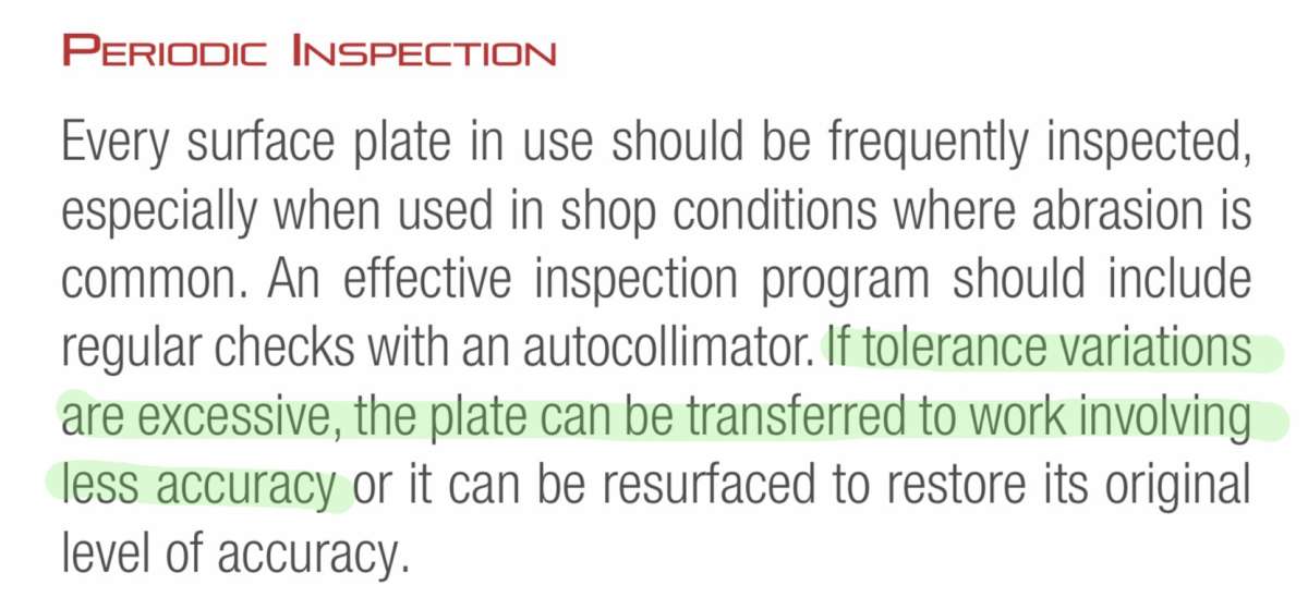

                      #740309
                        I wouldn’t argue against that at all, Duncan
                        … In fact the brief Starrett document that I linked previously is very clear on the matter.
                        .IMG_9825

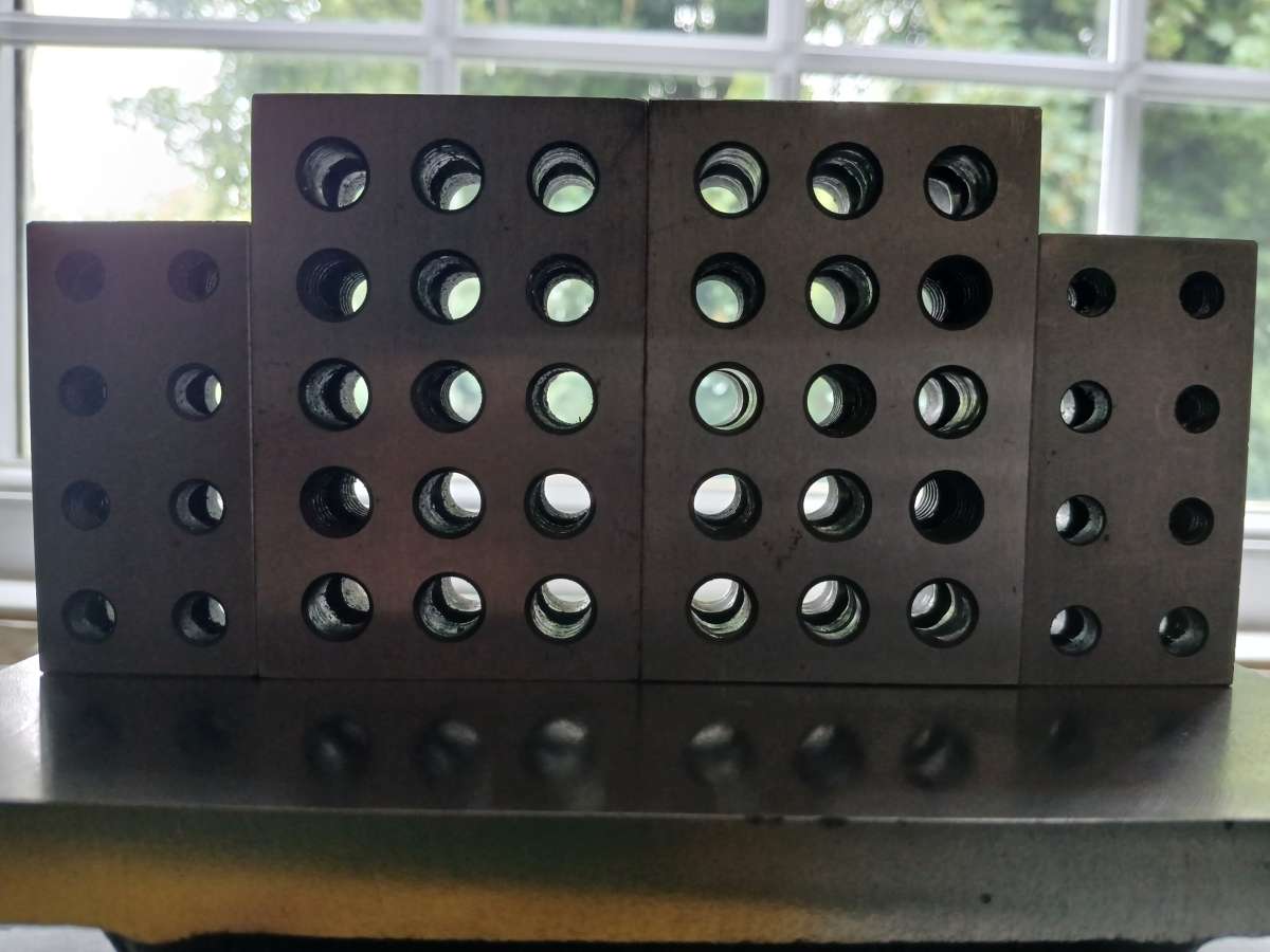

                          Hi Dave, I’m certainly not making anything to the standards of NASA, or making tools to the standard of companies like Starrett or Moore & Wright, but I do do things that require a good level of accuracy, but let’s face it, a pair of spectacles is a compromise to 20/20 vision.
                          The photo below is not the best way to show how good my small rectangular surface plate is, and yes, you can see a smidgen of light coming past the 60 x 30 x 15mm block and the larger one beside it, on the left hand side, but the photo shows it worse than it actually is, and my thinnest feeler gauge of 0.0015″/ 0.0381mm, will not even try to enter that gap, not even the very tip of it, and this is what I mean by being good enough.
                          20240709_092159#b
                          Regards Nick.
