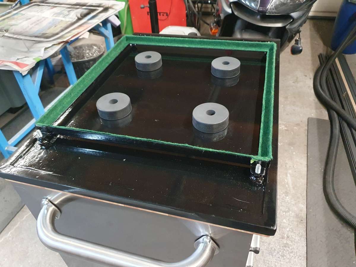

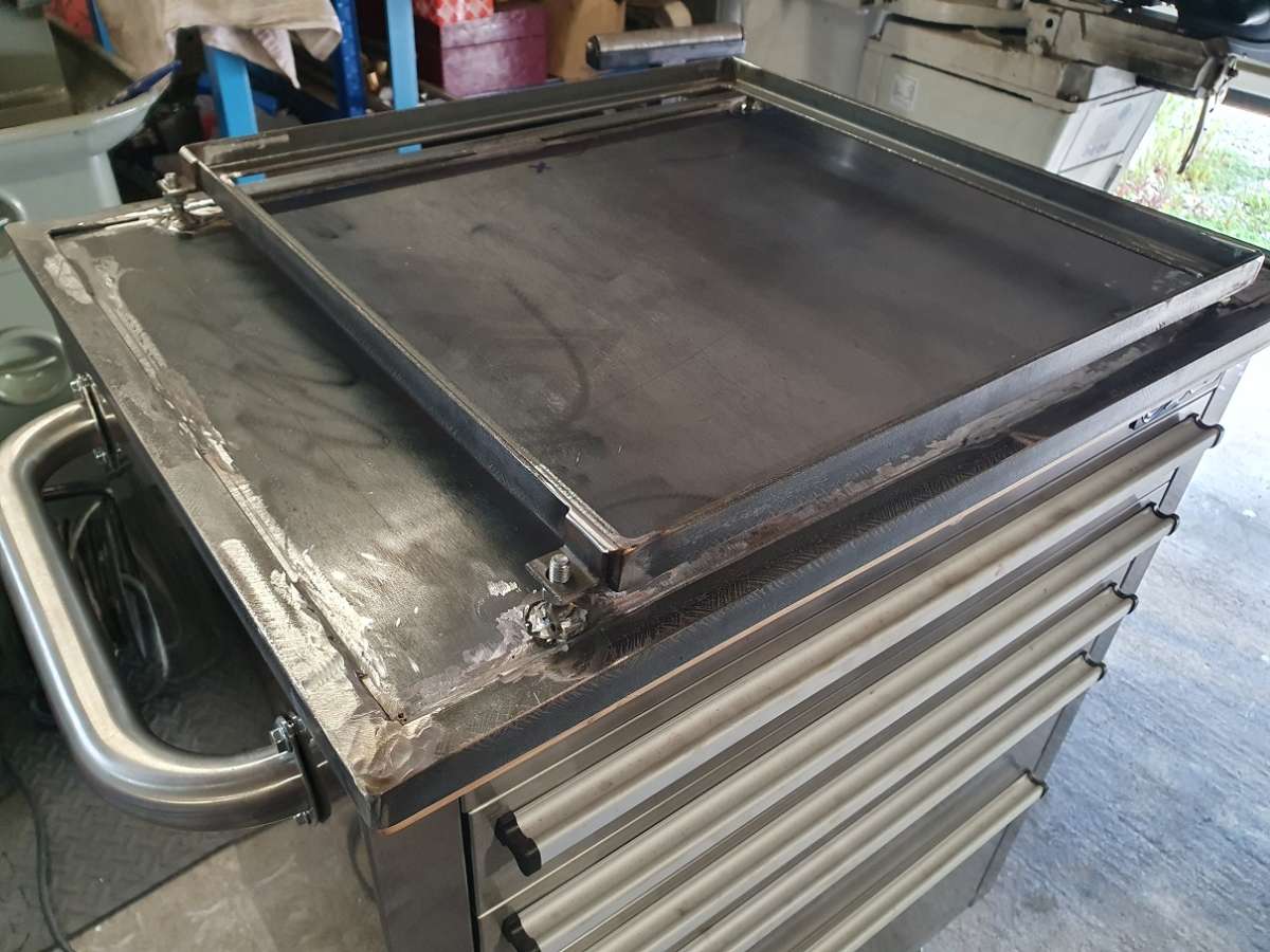

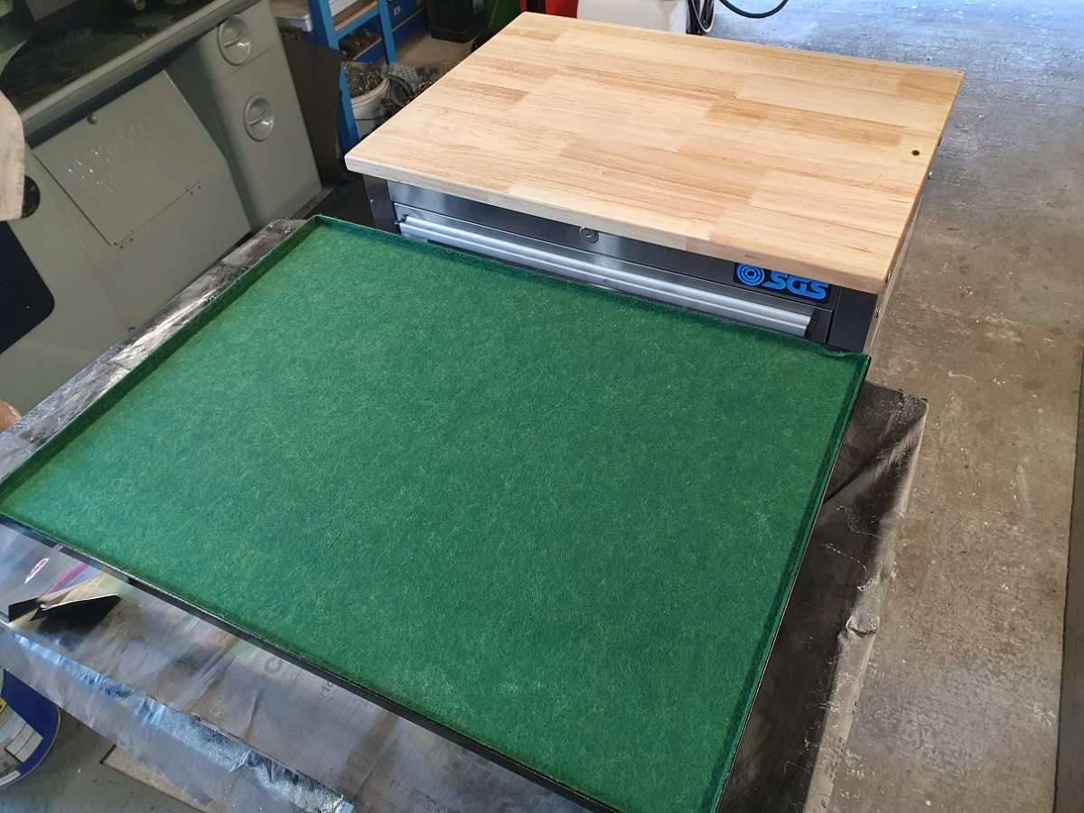

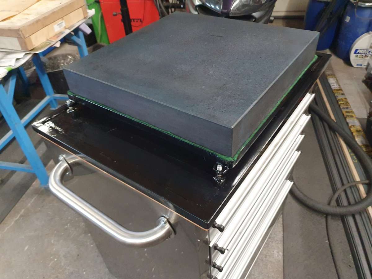

        Hi Mike, I have just done a similar thing.
        I have a 18″ x 18″ x 4″ black granite plate and after lots of hunting and reading as to why I could not find a commercially available ‘proper’ 3 point support stand for it I found a site that deals with plates and stands that stated that they will not produce such a stand as a plate that small is liable to tip due to its lack of mass.
        It also stated that plates smaller than 600mm x 600mm ( I think, may have been 600 x 400mm) would not distort by any meaningfully measurable amount.
        If I can find the site again I’ll post a link.
        So I made a tool chest top stand – a 1/4 thick steel plate edged with small angle to keep it in place, 4 Ice Hockey pucks skimmed in the lathe to the same thickness so as to also remove the shiny surface and provide a little grip then a 20mm hole bored through the middle to provide a location for a locating ‘nipple’ on the steel. The Ice Hockey pucks are vulcanized rubber so have a little give in them – it is perfectly stable sitting on them, works a treat.
        I also made a small angle iron frame to surround it so even if nocked it could not slide off or move (not that it would with it’s weight!) although this provides no support.
        Easier with pics..
        The under side of the top plate
        Surface_Plate_Base_1
        Surface_Plate_Base_3
        Surface_Plate_Base_4
        I moved the pucks a little further out before mounting, 90mm in from the outer edge so 20% of the surface plate length.
        Surface_Plate_Base_5
        I really like the fact that I can now move it around – away from where I’m doing anything dirty. and I’ve made a felt lined wooden cover for it too.. Proper posh!!

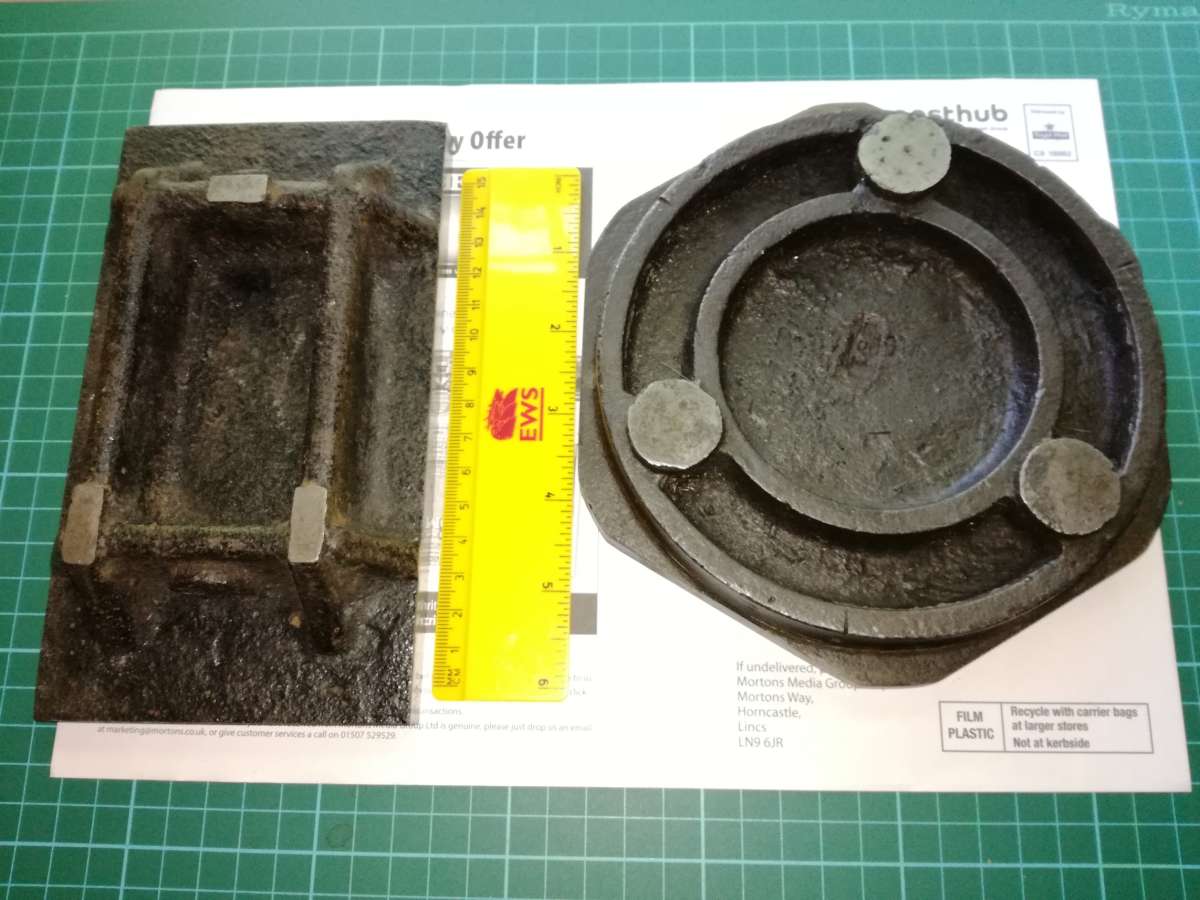

                                        Hi, my small cast iron indoor surface/marking out plates have three points for support, as does my 24″ x 18″ cast iron one in my garage.
                                        IMG_20240708_083833b
                                        I don’t know the accuracy of any of them, as they are all second hand, but they are good enough for whatever I will be using them for.
                                        Regards Nick.

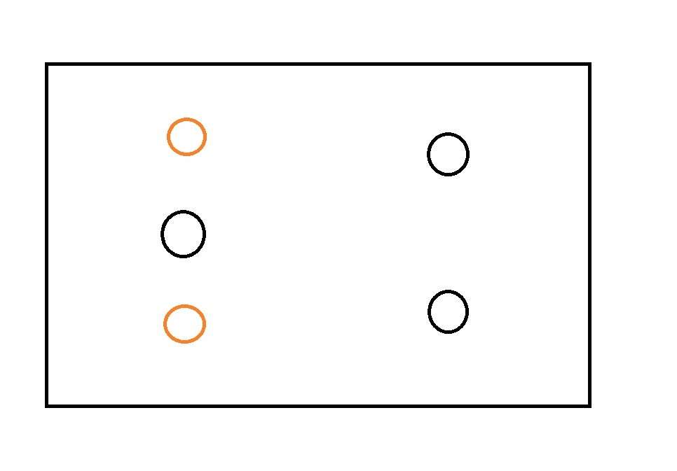

                                            Ideal might be 4 points… 2 direct to plate and 2 on a subframe that has a single pivot in the middle … so three point of connection to ‘solid ground’ but 4 points touching the plate.

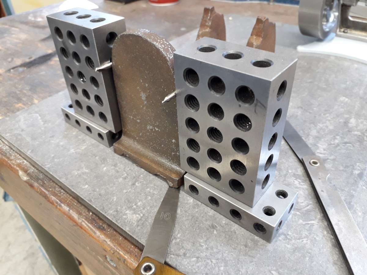

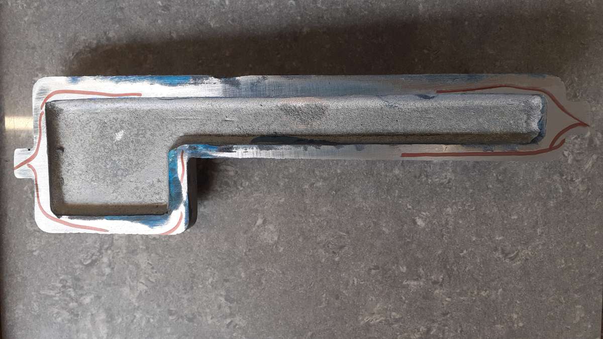

                                              Dave how would you “fit” a flat surface if you were not measuring it.
                                              Surface plate is the ideal matching part to get your “mating” part flat. Be that by bluing the surface plate and rubbing that scraped machine part against until you get the pattern you want. Or it could be something you lay a sheet of abrasive on and rub the base of your model engine over as you can’t really do a lot more until you have a flat surface to work from or to mount the part for subsequent machining of the upper surfaces.
                                              Assessing a casting. I’m only interested in what gauge wedges the part vertical not it’s actual thickness as they will simply be use da spackers when mounting on the mill.
                                              20200815_112546
                                              Another that has been rubbed on abrasive, red Sharpie indicates where I have contact, not worth going further as the “hollow” is only a few thou and won’t affect how the engine sits
                                              20240608_143907
                                              #740158
