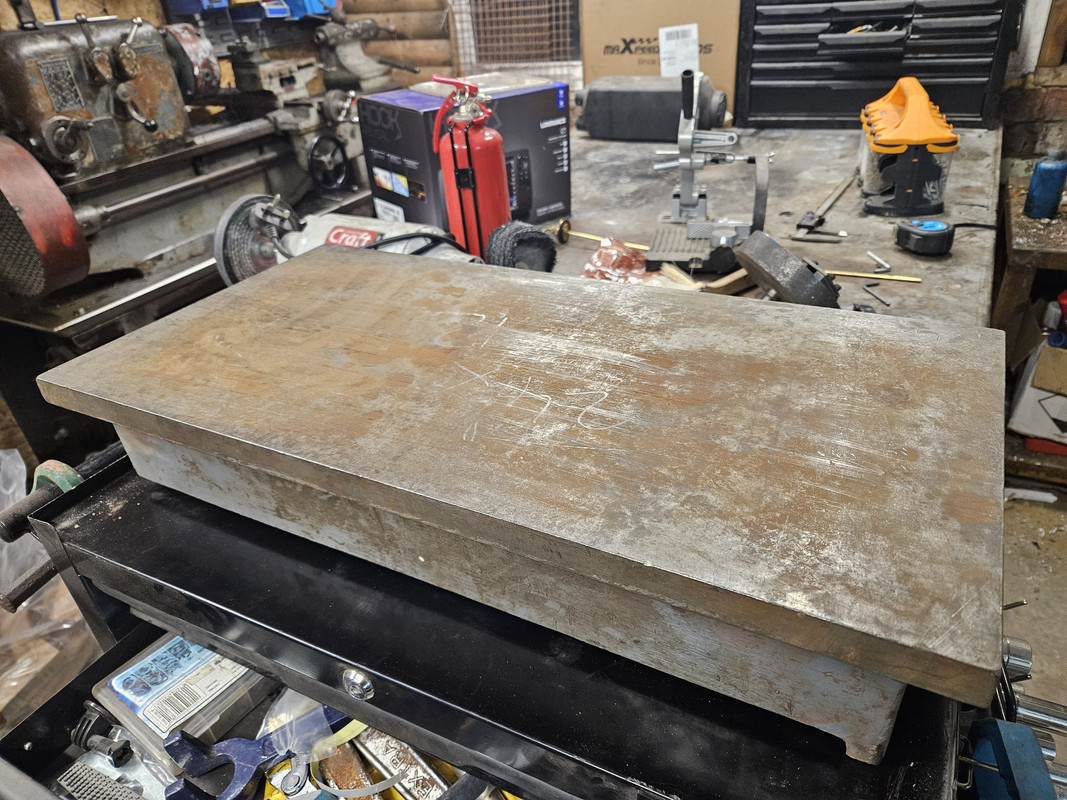

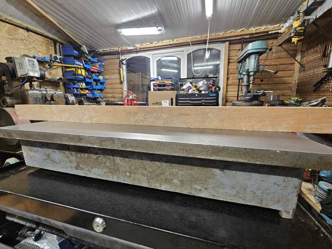

      I am looking at a cast iron surface plate that needs by look of it a tidy up. I read a lot about scraping etc to resurface them.
      As i am new to it. Why is milling the surface not ok ?
      #693255
        Because a Surface Plate worthy of the name needs to be much flatter than a Mill can achieve.
        #693256
        wayne ollerenshaw
          @wayneollerenshaw89933
          so no then. shame as it is a good price. thought to mill then sand it.
          so surface grinding best bet ? Its not going to be for ultra precise work.
          i should go look at it maybe and see how bad it is. looks rough but  cant tell in pictures.

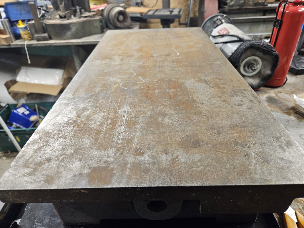

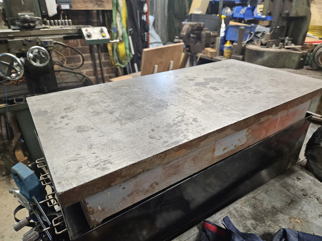

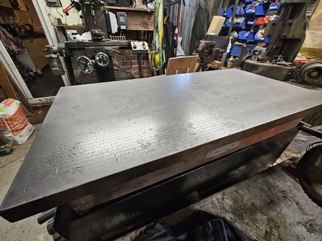

                                  Mad busy and popped straight out to get the plate. Defo needs something as a fair lot of dings in it. Nothing that cant be fixed though.
                                  Yes some may say its a mud weight, as already have but i like a challenge and to fix stuff.
                                  It cost me £40 so no big deal.
                                  I just use some Kerosene as its all i have at the minute to scrub it down to see whats what.
                                  seen that and thought well, a bit of a blast with the DA and 240g with kerosene will do no worse than it is.
                                  Its not to bad for being flat really looking at it with the piece of machined Sapele i have here 🙂 🙂 ;);)
                                  So now to decided when to sort it out.
                                  Happy with it anyway. even if for a nice work surface wen faffing.

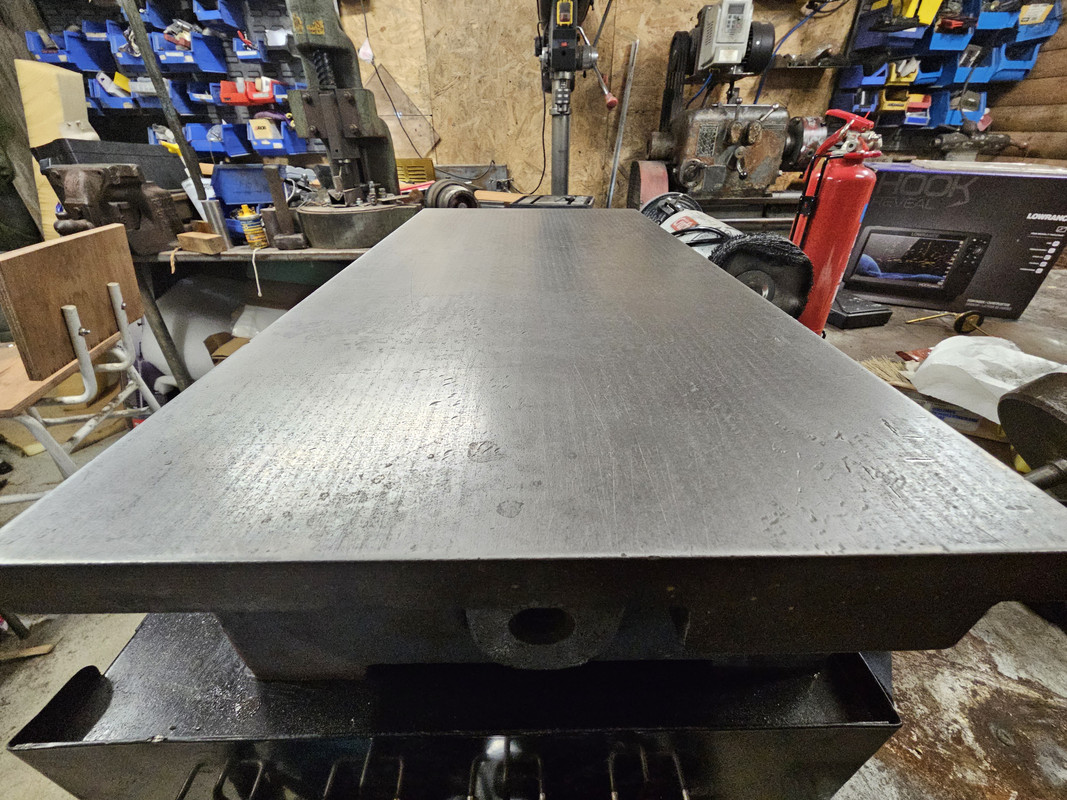

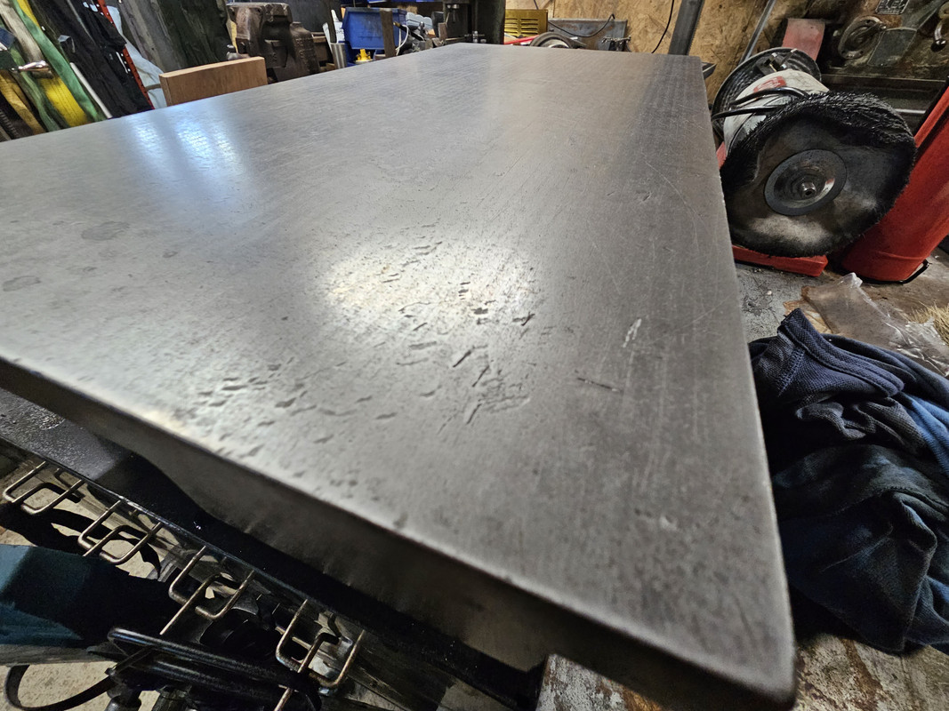

                                      3a7
                                      It just needs light work with a stone to take the high spots off the marks.

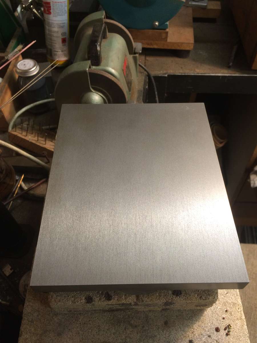

                                            IMG_0218dont know how accurate people work to at home but I machined a 8” x 6″ surface plate at home from a raw casting and it seems to be flat enough for the work I do. I thought if you were going to scrape a surface plate you had to have some kind of master reference?

                                              That plate will be fine for general setting out/measuring tools stuff like that if you just knock off the burrs with a stone or burr file. It’s a long way off being fit for scraping duty though.
