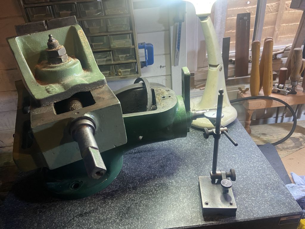

      Hi all

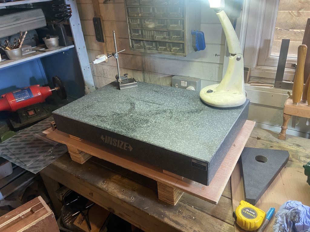

      My new surface plate turned up yesterday at last, so I can get on with my surface grinder refurb project. It’s 25 inches long, and already I can see what a tremendous benefit it will be. Unbelievably heavy though.
      I will post progress on this thread for advice and moral support and also it may be useful,to others attempting a similar project.
      Looking at the Connelly machine tool reconditioning book, he is clear that one should start with the headstock and spindle, and work around the machine to the table. If one starts at the table, it’s possible to get everything square in relation to the table, only to find the spindle is pointing off around the room somewhere, with not much that can be done about it. So that’s what I did.
      Connelly gives the following tolerances for the spindle:
      Perpendicularity to the vertical axis of the machine – 0.0004” (I got 0.0001)
      Runout at the spindle – 0.0004” (surprising high I thought) – I measured 0.0004
      So I am on the tolerance, and the headstock and spindle is acceptable. Does that sound right?
      I put my pillar drill vise on the headstock to keep it steady. It didn’t seem to wobble, but I was getting inconsistent readings until I did that. Also there was paint on the bottom reference surface of the headstock, which I had to remove. But I think as long as I can accept 0.0004 runout, the spindle assembly is good.
      Next it’s the column. I noticed the column seems to have some reference surfaces on the back, painted over, but look like the they were put there for measuring purposes (red arrows).
      So checking the flatness of the column is next.
      Any thoughts welcome.
      Steve

          Seeing your photo with your new surface plate mounted on
          on bits of plywood , would be worth looking on here
          https://www.starrett.com/precision-granite/precision-granite-faq
          for the correct way to install and mount a surface plate.

            I have no doubt you are right, the problem is I can’t handle it. The plywood base is actually part of the box it came in. I had to use a block and tackle to get it on the bench. I need to find a permanent place for it, when I do I will buy/make a stand and get the correct jacks for it. Once I’m done with it on the bench I will put the lid of the box back on and use the block and tackle again to get it off the bench. It seems like that’s the best way to avoid damaging it at the moment.

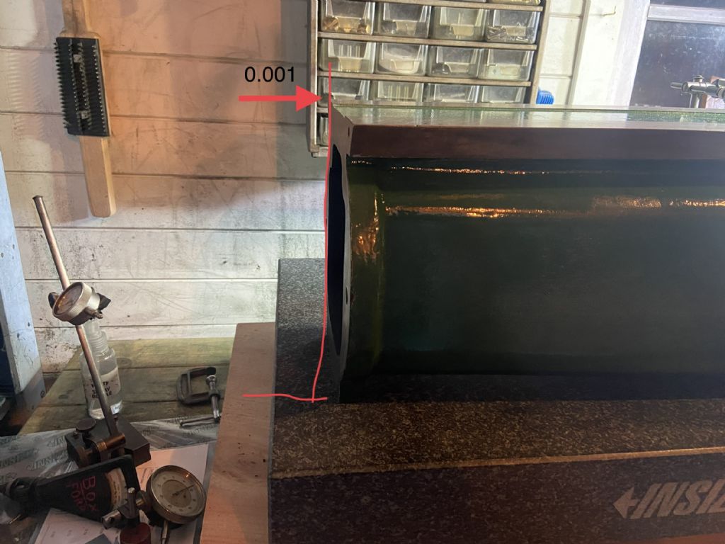

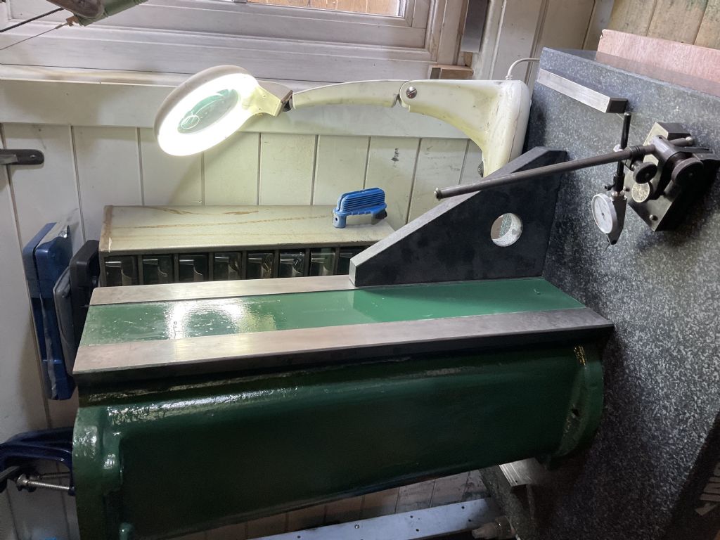

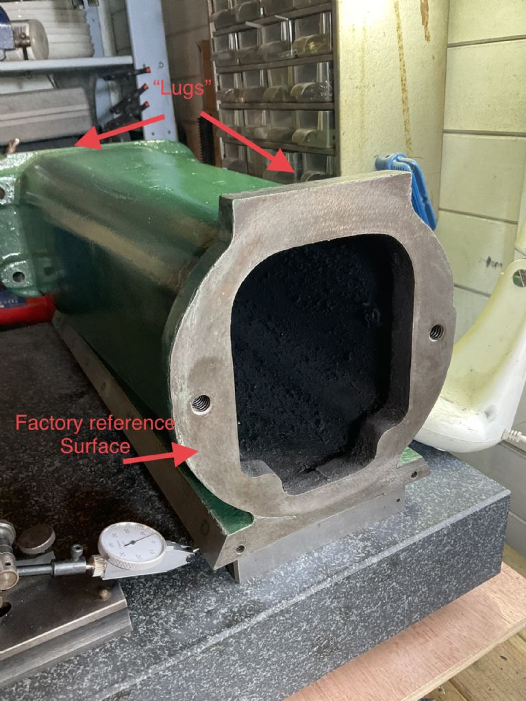

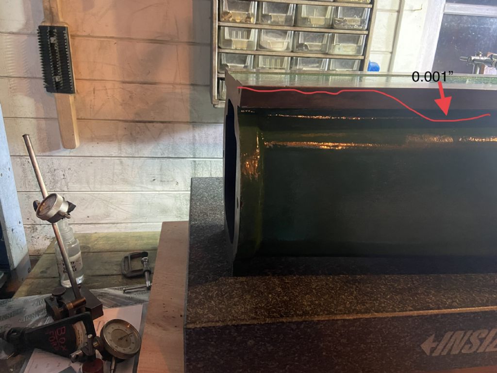

                  Column… stuck already, help! indecision
                  On my column there are some ground “lugs” on the back of the column, which I was hoping were for the purpose of supporting the column square on a surface plate for inspection purposes. I am sure I was right, but they seem to have been knocked about over the years and it seems to be not quite accurate using these as reference surfaces.
                  I am trying to 1) check that the ways are perpendicular to the surface that mates with the headstock and 2) indicate the ways to check for “co-flatness” (I read that word somewhere) so I can make a plan for scraping.
                  1) with the column on the surface plate the headstock surface is about 0.001” out of square with the surface plate (if I place a 0.002” feeler gauge under the other end of the column. That’s the closest I could get it.
                  2) the far way surface is about 0.002” lower than the near way. I am certain that this is because of the position of the shim rather than a genuine error
                  3) about 2/3 of the way along the ways I get a roughly 0.001” dip, looking like some wear on the ways, in the area where the knee usually operates. Not too bad.
                  but I can’t get really reliable, repeatable measurements like this. Possible solutions
                  1) shim like crazy and try to get the column aligned with the surface plate better – hard and not easily repeatable
                  2) mess around with a precision level
                  3) get a pair of meaty parallels, turn the column ways-down and take measurements from the bottom
                  Any thoughts or advice appreciated

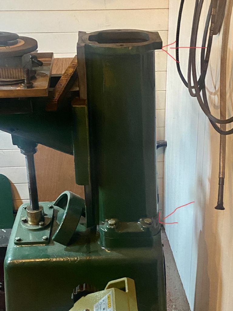

                      Sorry, I’m not explaining myself well. See pic….
                      Explained
                      So the factory reference surface is the surface the headstock sits on. It is not a wear surface and shouldn’t need scraping. The ways need to be perpendicular to this surface and co-planar. If I just start scraping the ways, I can get them flat, but they will not necessarily be perpendicular to the factory surface. They will likely be in a skewed plane.
                      I was hoping to use the “lugs” to sit the column on the surface plate, making the plane of the ways perpendicular to the reference surface, and parallel to the surface plate. However, when I do that, the reference surface isn’t quite perpendicular to the surface plate, by about a thou. Which makes it tricky.
                      Ideally I’d put the reference surface on the plate directly, and take measurements:
                      Vertical
                      but, clearly my reference square and surface gauge are nothing like tall enough for that.
                      The reason for taking the measurements is (having watched videos by Keith Rucker et al doing this) to get the ways perpendicular to the reference surface and co-planar, they split them into areas of similar height and scrape and measure, scrape and measure etc. to bring it gradually in to a perpendicular and co-planar surface. Then, once pretty close, spot and scrape it dead flat.
                      Problem is, I can’t quite seem to work out a way to get those measurements accurately and reliably.
                      Steve

                        Steve, your explanation is fine; the problem is that we're coming at this from different directions and run the risk of talking at cross purposes. Also, according to my wife, I'm capable of misunderstanding the simplest of things. BTW, I note the nice granite square!
                        The fundamental difference in our points of view is that I believe your 'factory reference surface' (FRS) is a poor choice for a plane to which everything else must be scraped into alignment. It's unlikely to be 'surface plate' flat, and it sounds like you've already discovered that it's not at right angles to the front face ways. Because it's neither a guidance surface, not subject to wear, it was probably milled or planed, with a less good surface than the ways, and probably never was really well aligned.
                        If you were to stand the column on the FRS and somehow measure the vertical 'tilt' of the front surface ways, you may then believe that you need to remove say 4 thou from one end of the ways. However, because the FRS is only about a quarter of the length of the ways, this translates to having to remove only 1 thou from one end the FRS – much easier! Also, the dovetails and front face ways, and their alignment to each other, should be pristine at either end of the column, and can act as references, so scraping 'tilt' out of the front face ways messes up the dovetails, more at one end than the other, making their re-alignment more difficult.
                        So, if you need to bring the worn front face ways flat, try to scrape a surface that effectively remains parallel to the plane passing through the unworn face at the ends of the column. Of course, you destroy this reference as soon as you scrape it, but that matters less than you might think. You can rest the column on the surface plate, on the lugs, if you believe they are – or have made them – reference surfaces, and measure the height of the front face. Or you could rest the column front face down, supported at either end, on parallels, and measure the gap twixt surface plate and face. But then, you have to be careful about keeping the places where the parallels will go parallel to each other. So measurement has its problems.
                        In fact, you can abandon measurement and just scrape the front face ways to the surface plate. You'll get a good idea of how it's going by the way the blue-marked areas move together (assuming the face is hollow). It's bad enough scraping the front face ways flat, without simultaneously having to worry about their relationship to the FRS all the time. No measurement…
                        Then, it's time to do the dovetails – always a challenge… That's my main reason for suggesting that the front face ways are worked first, with no real regard to the column ends – try to disrupt front face ways to dovetail surface alignment as little as possible.
                        Then, use this new, 'local'reference plane to adjust the base surface. That's easy for the 'front-to-back' right angle, but the 'sideways' alignment will require a gauge to be made that bears on the dovetail surfaces. (Sideways tilt doesn't matter so much at the spindle housing end, but, at the base, a Leaning Tower of Pisa looks bad…). When that's done, work the spindle housing end, ensuring the ends remain parallel (or at least the 'front-to-back' right angle). You'll need some sort of improvised gauge.. So, work from the most critical surfaces to the least critical.
                        Incidentally, for bolting faces, as at the top and bottom of the column, there's no need to scrape for a high density of contact points, and the surface can be relieved in areas away from the bolt holes. Then, for correcting alignment, only small areas need to be scraped.
                        Hope that's clear and helpful. However, there's no 'right' way to do this, just a vast number of ways to make the job more difficult.

                          Steve,
                          You're approaching this problem backwards. Scrape the long ways straight and flat then put the square on the long ways and use it to measure the short ways' perpendicularity with the scraped long ways. For that surface it only needs to be pretty close because you will dress the wheel from the moving cross-slide. What is most imporatant is that the knee and cross table ways are nicely scraped in. That joint barely matters at all.

                            Hi Pete
                            Last night, I got fed up with it and started doing precisely that.
                            I had a good look in Connelly on scraping perpendicular, and frankly he says “use a protractor” or make up a square template (how?!) I’ve Googled around the topic too, and there is a lot of BS about it, but no clear examples of how it’s done There must be a standard approach to it – basically these machine tools are big squares.

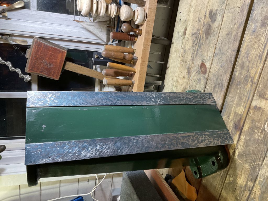

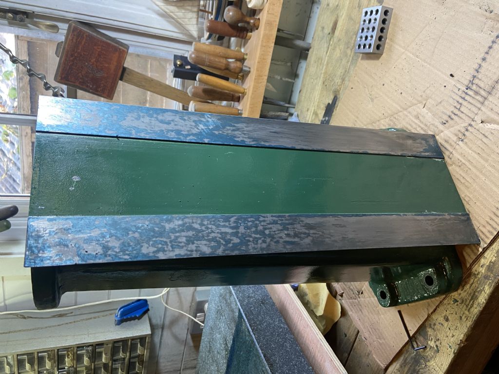

                                                  Straight edge ordered from H R Lamb. I don’t expect it’ll turn up this week, so I can’t scrape any dovetails for a bit. I wonder, once I’ve finished the ways of the column, what else can I move on to without a straight edge? The top of the table? I want to keep it moving, I have a clear weekend coming up! Don’t want to waste it.
                                                  Sounds like Mr Lamb might not be selling camelback straight edges any more soon, which would be a big shame for hobbyist machine rebuilders.
                                                  I’ve spent about 8 hours on the column so far I reckon, 4 yesterday and 4 today. When I started this morning it looked like this:
                                                  And by this evening it looks like this:
                                                  nearly there, surely! Now I need to make sure I don’t go too far and end up chasing my tail.
                                                  Steve

                                                    Some hopefully helpful feedback on your scraping;
                                                    it's difficult to tell exactly but I wonder if you are applying a little too much blue to your plate? I ask as although you have certainly improved contact, the areas of blue are too contiguous and over blueing can merge one point into another. I would suggest seeing if you can reprint with a thinner application of blue, if the points per inch improve then you'll know. Otherwise I would advise you to now break up the blue areas to improve oil retention.
                                                    There is a lot of info on scraping on the 'The Tube' but I think Stefan Gotteswinter covers the basics really well.
                                                    Tony

                                                      Hi Tony
                                                      Funnily enough that’s exactly what I’ve been struggling with this morning. Either too much or too little blue, or unevenly applied on the plate, and getting different results. I read a post somewhere by Richard King where he said the best way to apply the blue to the plate is by hand. So I tried that and I have been getting much more consistent results – in particular Stefan G points out the dark rings around high spots in his videos, which I’m now observing.
                                                      So a combination of those 2 techniques seems to be helping, And I do look like a Smurf at the end of the scraping session, but it’s a price worth paying.
                                                      Steve
