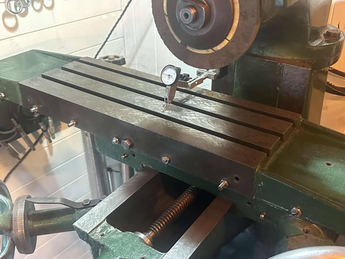

      Hi
      around a year ago, I extensively refurbished an old Eagle surface grinder, nearly scraped it to death, poor thing. I put it back together, but since then I haven’t really used it for any precision work, I’ve actually been using it for tapering wood plane blades. But now I’m at the point where I have a few jobs to do that would be much easier if I had a at least semi-accurate, surface grinder.
      By the time I finished the scraping, I had got the total error in the main table down to less than 0.001” everywhere apart from a few extremities. I’ve verified this many times on surface plate.  The only thing I didn’t manage to do was scrape the dovetails.
      The problem I’m having, I think is with the gibs. at the far reaches of the travel, maybe 3/4 of the way left and right, due to the weight of the table overhanging the knee, it causes an error. Clearly this should be not happening if the gibs are correctly tightened, that should remove any lateral or vertical movement of the table. However, I’m struggling to adjust the Gibbs in such a way that there is no droop at the end of travel, and they are not so tight that I can’t operate the left right motion of the table.
      Have some videos of this, but it doesn’t really clearly show the problem in action.
      Today I made some new grub screws for the table, and I have some new locking nuts for them. in the hope that this would allow me to solve the problem. But sadly not, it’s either so tight it won’t move, or the table droops by gravity at either end.
      Perhaps I need some shims? Or something. I really don’t know.
      any advice gratefully received 🙂
      IMG_4587

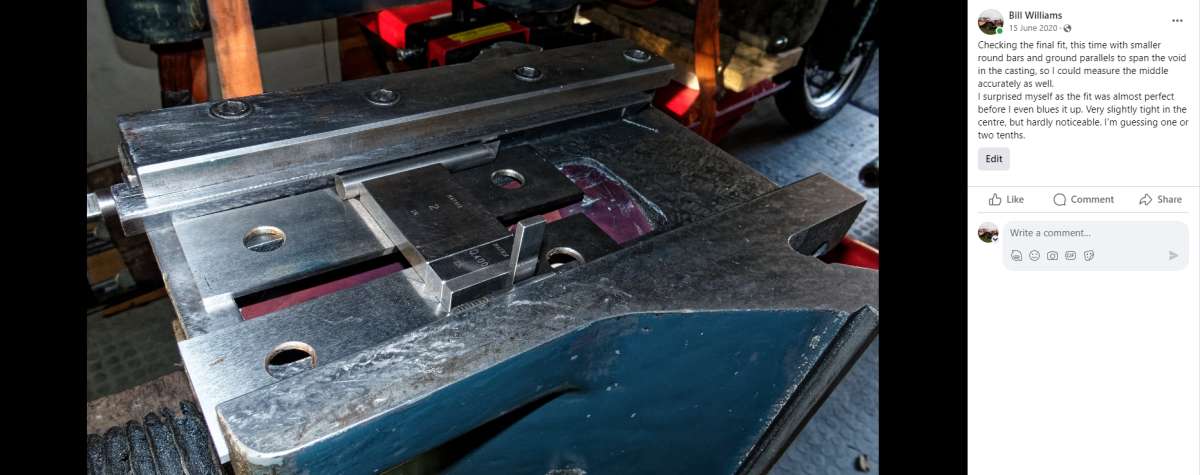

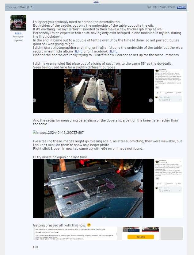

        I suspect you probably need to scrape the dovetails too.
        Both sides of the saddle, but only the underside of the table opposite the gib.
        If it’s anything like my Herbert, I needed to then make a new thicker gib strip as well.
        Personally I’m no expert in this stuff, having only ever scraped in one machine in my life, during the first lockdown.
        In the end, it came out to a couple of tenths over 8″ by the time I’d done, so not perfect, but as good as I was going to get.
        I didn’t start photographing anything, until after I’d done the underside of the table, but there’s a record in my Flickr album HERE or on Facebook HERE.
        Most of the photos are really trying to illustrate how I learned to set up for the measurements.
        I did make an angled flat plate out of a lump of cast iron, to the same 55° as the dovetails.
        Seen being used here for a slightly different purpose

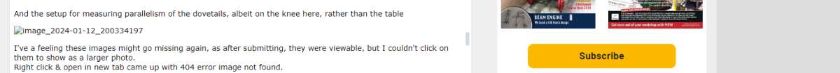

        image_2024-01-12_200124308
        And the setup for measuring parallelism of the dovetails, albeit on the knee here, rather than the table
        image_2024-01-12_200334197
        I’ve a feeling these images might go missing again, as after submitting, they were viewable, but I couldn’t click on them to show as a larger photo.
        Right click & open in new tab came up with 404 error image not found.
        I’ll try inserting again one last time
        image_2024-01-12_200856705
        Getting brassed off with this now. 🙁
        image_2024-01-12_200955945

          Sorry Steve, The first and second missing images were of my setup for measuring the internal dovetails, after I’d re-machined the tapered gib key on the knee; you might not have the same problem if you’re on parallel gibs; easier to just look in the album, rather than this site
          The last missing image was of a screenshot showing how the first image had gone missing, but even that’s vanished now. Just to prove they were there, for a while at least, assuming this screenshot doesn’t go AWOL too.
          Ho Hum 🙁
          Missing Images Grinder

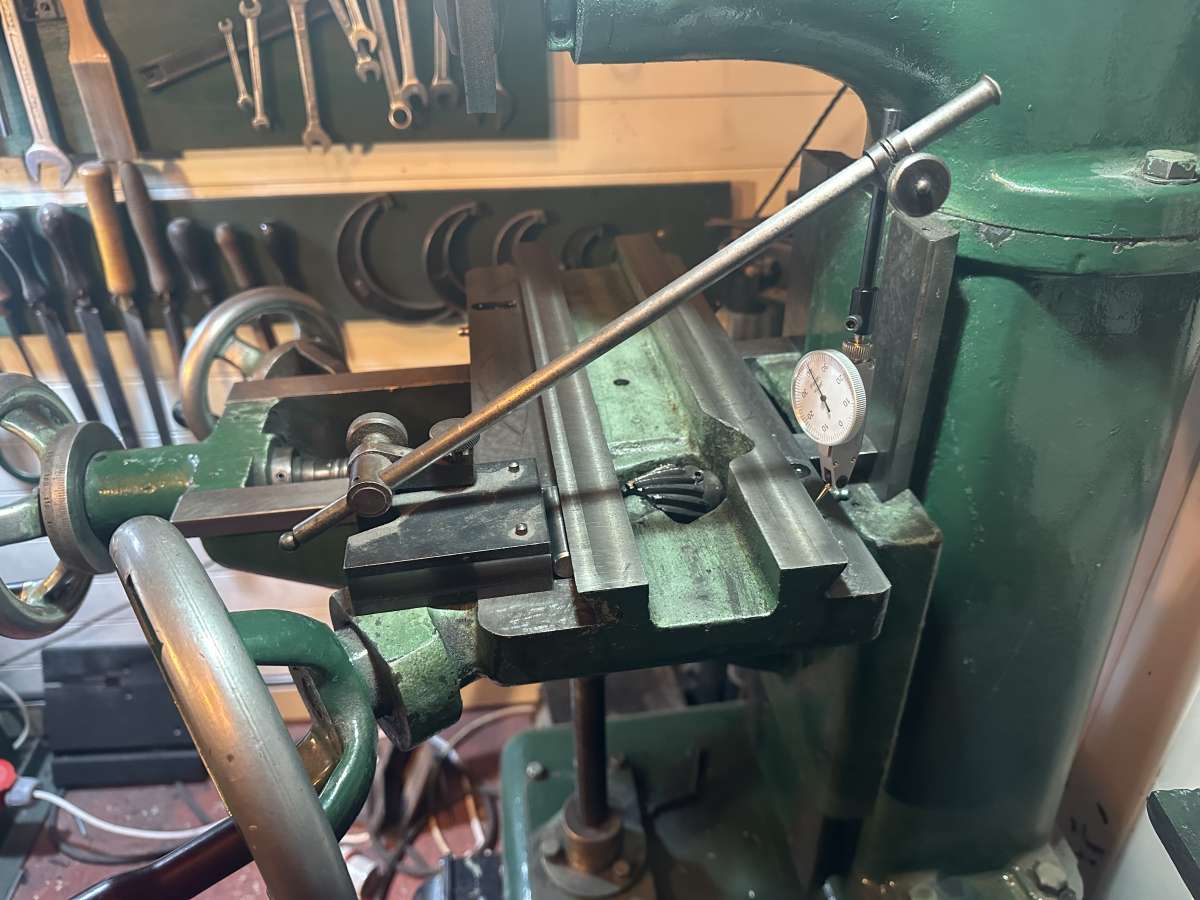

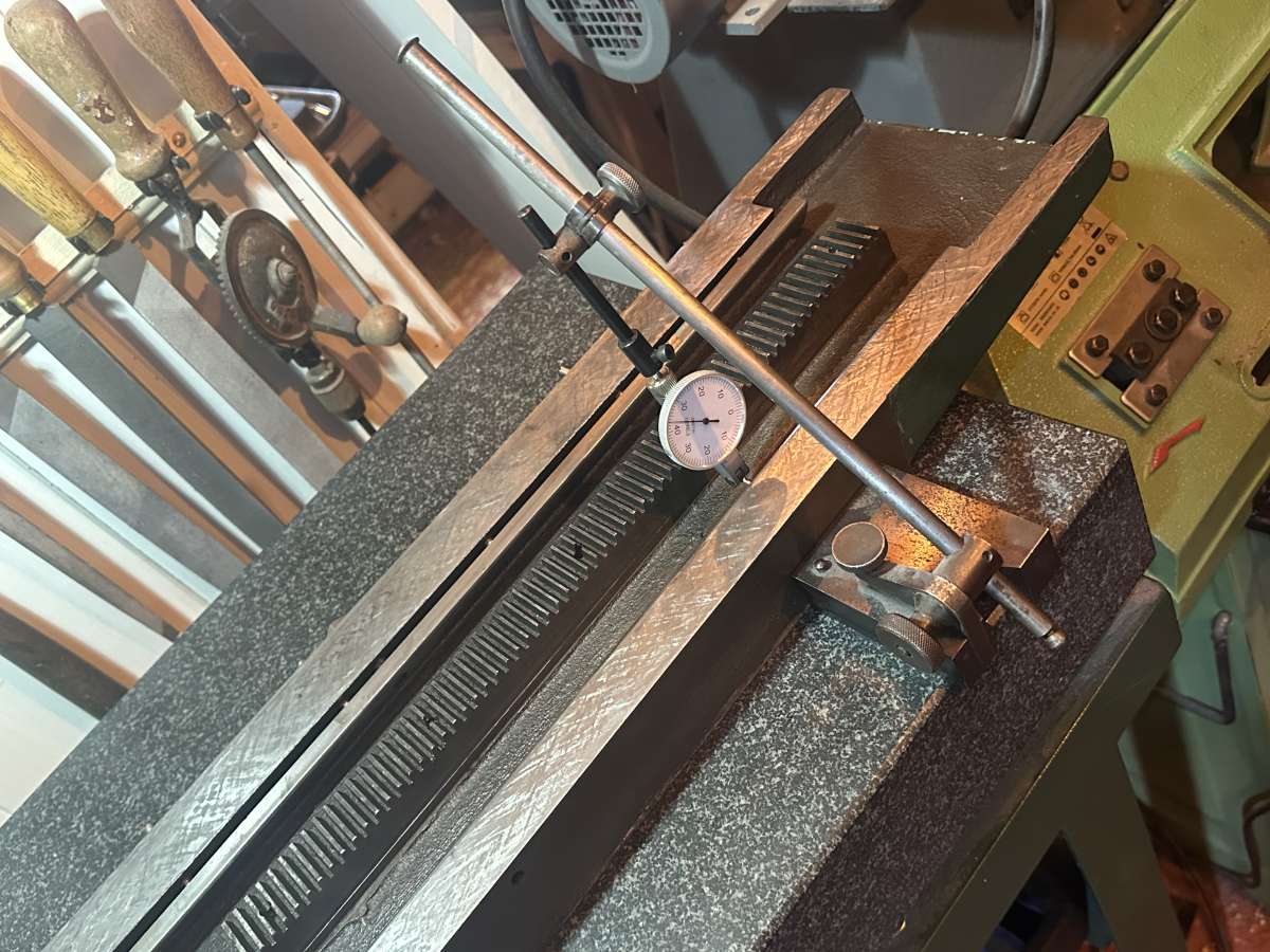

                          Hi Bill
                          To try to answer your questions….
                          Yes it is like that but without the removable dovetail. I measured it with a setup as below –
                          IMG_4600
                          And as I said I got about 0.0005 error, perhaps a little more at the extremity.
                          I am also sure it’s the table at fault, not the knee or the column. I have made new grub screws and tightened them right up. I can feel the table moving and I can correct the sag at either end by giving it a little pull.
                          So on to the table, on one side it has the gib and on the other a oil-groove infested dovetail, so it’s very hard to measure.
                          https://youtu.be/Oa8-4LA7Qx8?si=DH9R44LV66NWUkrq
                          i could try to use the “apron” surface to measure it, but that’s still tricky and I’m not confident that I would get good results.
                          like this…
                          IMG_4603

                            Unfortunately your last image has gone awol, like several of mine, and the youtube link doesn’t work for me.
                            That’s the same sort of method I was using to check for wear on mine, but I also tried with a micrometer and two round bars just to confirm, repeating for several different diameters; Initially I used two round bars on one side and a long parallel, with a third round bar on the other, still measuring across with a micrometer, just to make sure the dovetail was straight as well as parallel if you see what I mean.
                            i.e. to ensure it’s not a perfect banana shape.
                            You have the opposite profiles to me, the dovetail section on your saddle, is under the table on mine.
                            I guess the same method still applies; I scraped the table top flat, though far from pretty cosmetically.
                            I then scraped the front of the table, vertical and flat.
                            That way, I could stand the table on the front edge on the surface plate, and use a similar sliding clock to make sure the dovetail internal profile is flat.
                            You could then use a stack of blocks & feeler gauges etc to ensure the other rear dovetail is flat and parallel to the front.

                                Let’s try again with the pic and video
                                https://youtu.be/Oa8-4LA7Qx8?si=fpAgaED8TaRSQhvz
                                IMG_4603

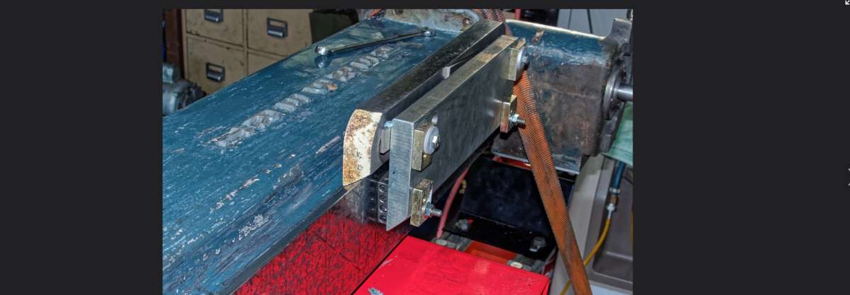

                                    The last photo with the DTI will show whether the dovetail is parallel to the front of the table, but not necessarily show any high spots, other than along the line travelled by the stylus.
                                    I made a couple of straight edges with a bevel; the one with the cream painted end is 55° and scraped flat; it was a slice of cast iron off a bus bar clamp/fishplate about 12″ long.
                                    Even if it’s not exactly 55°, it doesn’t matter, as it was also used on the mating dovetail, which was further blued to this one.
                                    This happens to be the column, but the overall principle remains
                                    image_2024-01-16_140541068
                                    I’m not claiming to be any expert here, it’s just how I went about the task
                                    See also for a close up

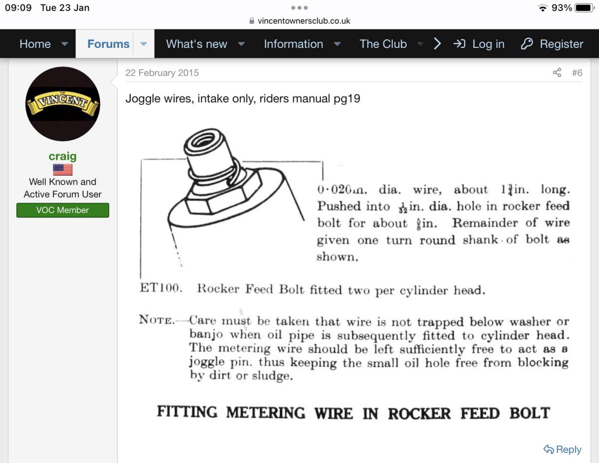

                                              #708120
                                              Diogenes
                                                @diogenes
                                                Bill’s comment made me think – I’ve seen wires used to ‘space’ a gib strip to stop it’s toe dragging along in the gutter at the bottom of the dovetail, (and/or it’s head riding in the angle at the top) – if this makes sense..
                                                ..a bodge alternative to ‘pinning’ them so that contact remains central to the shears and they are prevented from slipping or being forced up or down under screw pressure..

                                                    Coming late to this one … with a wild guess that might prompt some thought:
                                                    Vincent motorcycles [and others, I presume] used wires inside drilled oil-passages, as a very effective way of tweaking the cross-sectional area and thus the flow.
                                                    Is there a possibility that these wires serve a similar purpose ?
                                                    Edit: __ even managed to find an illustration after all these years !

                                                      Nit picking, but since minimal distances are being sought and measured, I would try to re assess the measuring set up to maximise rigidity.
                                                      Can the scribing block be used the other way round (So that the pins are on an outer machined surface), and with the clock clamped further down the stem?
                                                      You are looking for deviations of less than 0.0005″ with a set up that appears to be more flexible than it could be.
                                                      Stiffening things up might improve results!
