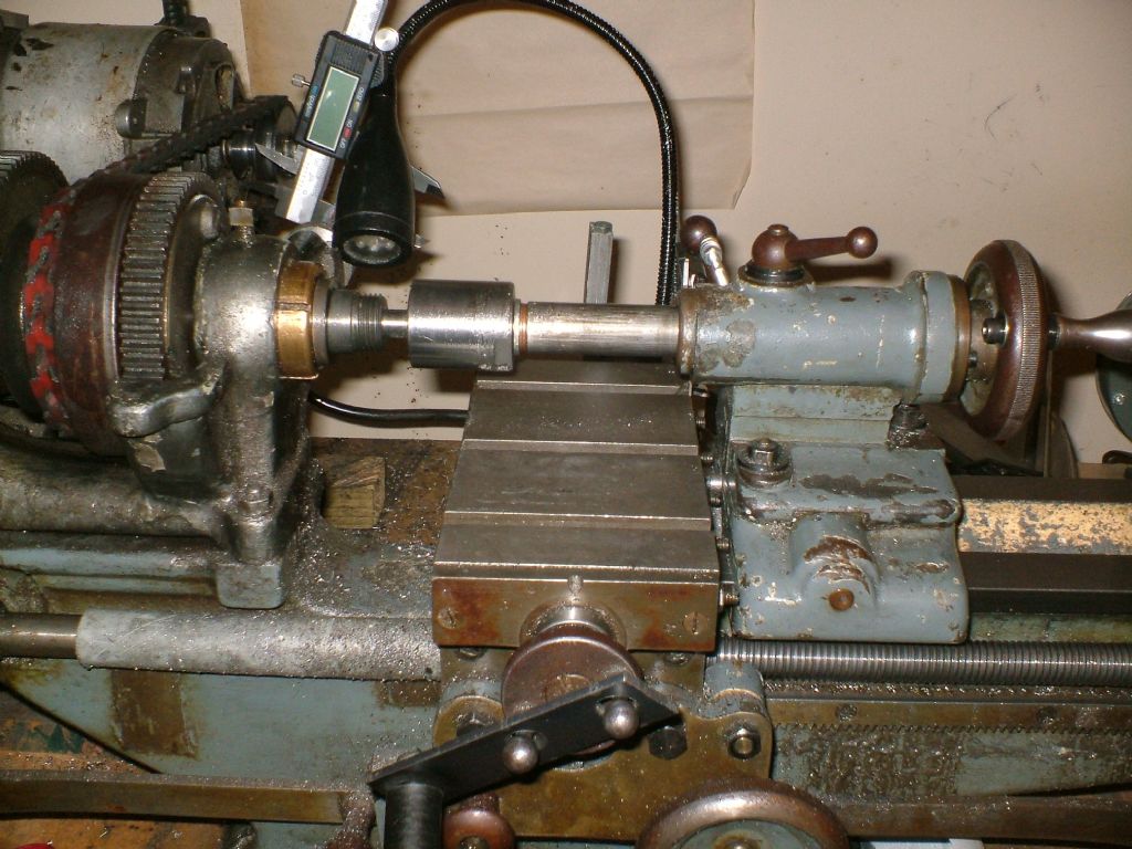

                  I've been meaning to do a write up in here of my Drummond/Myford M series for a while now I've finally (i believe) sussed it out
                  The best system I found was to preload the spindle with a workpiece in the spindle nose collet chuck and then hold the spindle in its preloaded position using the tailstock with a live centre
                  Once everything was loosened up the tailstock preloads the back of the spindle against the rear thrust bearing and the live centre allows the spindle to revolve freely by hand, even with loose unadjusted headstock bearings
                  Then you do your headstock bearings and the spindle cannot move out of position because the live tailstock is supporting it
                  This has worked so well that the first time I did it the oil simply sat in the oilers and wouldn't go into the bearings, the tolerances and fit are so good that I now need to use finger pressure to "pump" the oil in
                  (Tightness required setting the bearing was low to moderate. If you tighten up too much the spindle will be locked in the solid bearing when it cools down and you return the next day)
                  So try the tailstock live centre system if you want really good accuracy for your particular headstock bearings

                                      Your tailstock may have sufficient reach and you can use a live centre directly into the bore although in your big-bore case you would need a live centre for doing tubing
                                      The main thing is that the spindle stays put, and can still revolve by hand, while you do your bearing tweaks
