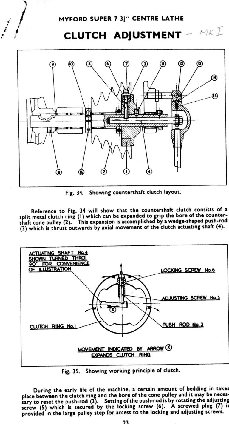

                super 7 mk 1 clutch adjustment-001.jpgSteve

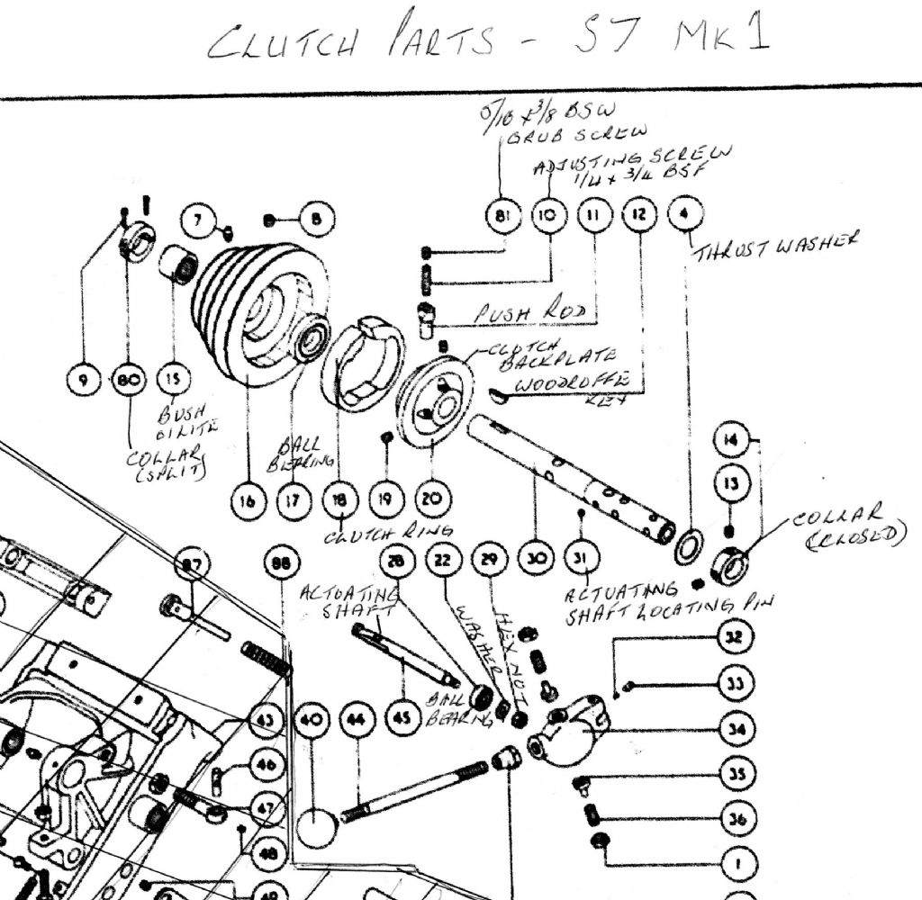

                If you think it's a Mk1, I've put these on for info:

                  Steve, as Tom states they are fairly straightforward devices but I will admit to being puzzled that your drive is permanently 'engaged' – I'd kind of expect most problems to result in non-engagement. So I think you will have to dissemble the clutch.
                  The main reason I'm posting is to warn you that the clutch shaft only comes out in one direction and that you will damage the bearings if you try to force it the other way. Sorry a long time since I've done this – so I am not going to state which way that is, just I case my memory is not so good – you need to read the manual (used to be available on the Yahoo Myfords site). I don't have my copy to hand I'm afraid but I'm sure someone else here can be more definitive.

                    Ensure the adjusting the screw is properly set and locked, locking was hit and miss on mine, I ended up cleaning it out with solvent and applying thread lock.
                    Also if you feel a notch, check the actuating shaft for damage, the ramp on mine was damaged, a thin layer of hard face weld, dressed with an angle grinder and polished with a stone provides a lasting solution without having to remake the shaft. It's a tricky weld as you don't want too much heat in the small shaft, but too low a voltage will give an undesired convex bead, making dressing it back harder, but it's not beyond the amateur. I'd practice on a piece of round bar first. I never fixed mine in the end, it was still usable but force required was becoming (very) excessive. I planned to use a dremel tool to make a vee notch up the centre of the ramp, on the actuating shaft, 1/2 to 2/3 the total width, and then use the remaining edges right and left as a reference to dress the hard face flat with diamond stones.

                      Thanks for the diagram. I've stripped it down, and not quite sure how it was successfully 'locked-up', but the basic problem is that the clutch ring has broken. It looks as though someones had a go at gluing, but obviously a non-starter. Is welding a possibility? I understand that spares are no longer obtainable..

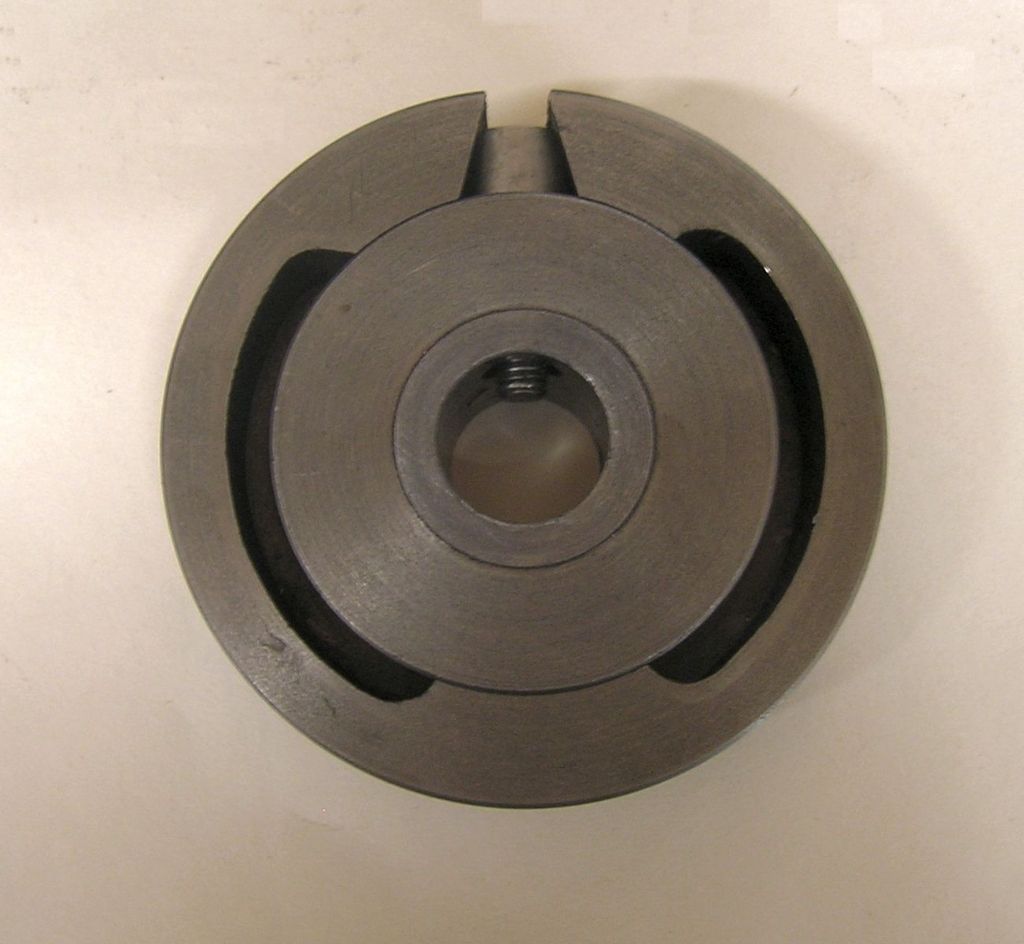

                                The inside of the ring, at least the three "feet" on the inside, need to be carefully machined to be a good fit on the clutch hub. See this pic. I wondered if the break in the ring could be pinned across the break.

                                  Good luck with the spare, but do be careful assembling it. If the bore of the pulley is well worn that'll be why it broke in the first place. Be a shame to wreck the last remaining spare in the western world.
                                  As for reinforcing the centre of the existing one, sounds like a good plan if you can make the bits you need. Fiddly sort of a job, I'd have thought, but worth it if you can do it.
                                  Good luck, maybe post us a picture of the broken bits so we can see what you're facing?

                                    I’ll post a pic tomoz, but the ring is broken on the thinner section. I think the issue may be the limited gap height available.

                                      How about this for a plan:
                                      Find a bit of spun cast iron – meehanite preferably, or something that isn't going to break as soon as it flexes. (Still like my tufnol!) Turn the OD to size for the actual bore of the pulley less say 5 thou clearance. Face to length.
                                      Mark out two holes at 5 o'clock and 7 o'clock, drill say 8 mm to give the radius. Ignore the rest of the annular slot.
                                      Bore out the centre inner dia, as Robbo says it needs to be a good fit on the centre hub. As you approach finished dia you break into the two 8 mm holes and get an interrupted cut.
                                      Now cut the wedge slot the old fashioned way with the Armstrong Planer.
                                      At this point you've got a horseshoe shaped copy of the basic shape, The two "necks" at 5 o'clock and 7 o' clock will control the elasticity of the disc, and make it feel like the original. It's not going to matter that the annular slot is only a 4 mm radius, that feature is made that way 'cause the original relief is cast in.
                                      Fit and forget. Hopefully!
