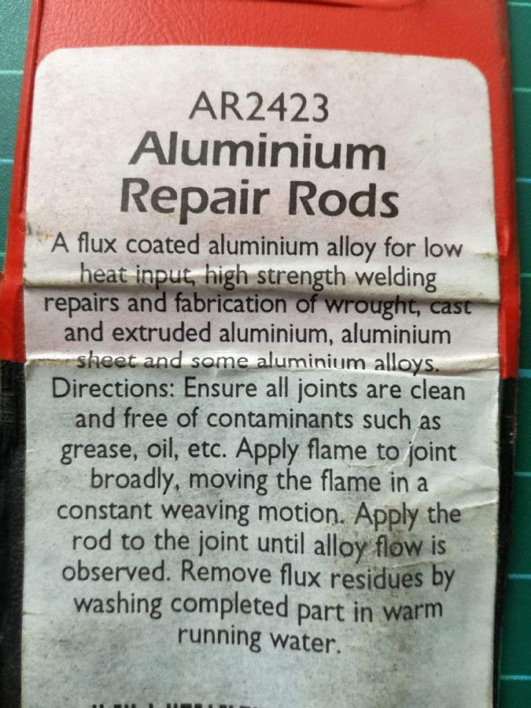

                              #596710
                              Nicholas Farr
                                @nicholasfarr14254
                                Hi, I've got some Taymar 3520 & 3530 which were in a clearance sale in one of the big DIY stores, there is no melting temperature on them, but Farnell have the same numbers in their list which may give you an idea Alloy repair rods I've also got some GoGas AR2423 ones as well which Cromwell have GoGas repair rods I've had these for several years, but never used any of them, so I can't vouch as to how good they are or not.
                                Here's the instructions for the AR2423 ones.
                                Regards Nick.
                                Edited By Nicholas Farr on 02/05/2022 11:52:41

                                                AJAX makes a good point about matching the melt temperature of these aluminium "brazing" rods to the that of the alloy being repaired.
                                                Its many years since I used the Lumiweld branded ones I bought not too long after they first appeared on the open market but I recall coming very close to disaster on the second job. Which almost ran away from me but a bit of plumber style wiping saved the day. Looked to be a pretty basic sand cast aluminium too.
                                                Its very easy to overlook the fact that the melt point depressing effect runs into the component being repaired. As you are heating the the main body of the part just behind where the repair is to be made once the break surface is hot enough for the rod to start melting and depressing the melt point of the part itself so fusion can begin the temperature behind the break will be "too high".
                                                So the melt zone proceeds apace if rod melt temperature and body material melt temperature are too close.
                                                The cure is to lift the heat away from the junction before the main body starts to collapse. But if the rod temperature is too close to the material melting point it's darn difficult to reduce heating by the right amount quickly enough.
                                                The first job I did was on an alloy with a decently higher melting point than the Lumiweld rods. Worked like a charm. Just like the instructions said. So I got overconfident and the second job proved things weren't so simple.
                                                Not a job I'd do for othr people! The rods I have left are for me only.
