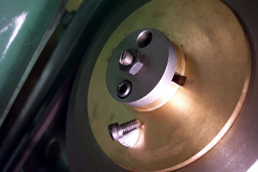

      I just got my new Super 7 home but can't get the clutch to disengage, The Adjusting screw is way too far out but I can't get it to screw back in . . . I don't want to snap it.
      Is there any chance I have forgotten to un-tighten something? Otherwise I'm going to be trying WD40 and heat for a while….
      Thanks for any tips…

                    #139243
                    Brian Wood
                      @brianwood45127
                      Hello Jack,
                      This is what a correctly set clutch should look like. Your cap screws are missing which might explain it's position and stuck condition. The screws are 3/16" BSF [32 tpi] which 3/8" thread under the head, you can see how short they are from the one I have stuck on with blue tack
                      Regards BrianMyford Mk 2 clutch

                                  I missed the point that you are missing the cap screws as Brian says (Sorry) but the drive plate is still keyed to the cone clutch and held there very firmly by the spring. I doubt it has ever worked right in your hands and the screws are missing because the previous owner had a go. You may have a situation whereby the drive plate and clutch have been driven in hard under power and the drive plate has hit the end of the thread on the pushrod – it is not threaded very far as there was no need for it, in which case you need to shift not only the end of thread but beat the spring as well! If you are still stuck then use the locknuting principle as above and put the drive plate in something very solid like a vice, stilson or mole grip and turn the outer nut as Phil says above. Marks on the nut are better than destroying it and don't bend the pushrod.
                                  No more WD40 please. You don't want that in your bearings! The spring should not be coil bound as proper Myford used to compress it further in normal assembly without any binding.

                                      Hello again Jack,
                                      My apologies, the sizes are very close and hard to sort on short lengths. The cap screws are 2BA x3/8", NOT 3/16" BSF in my earlier post.
                                      Dennis I think has explained why it is so hard to unscrew, but rather than hold the drive plate with Stillsons, which will chew it up, a better alternative might be to make a pin spanner with two buttons to engage in the holes for the heads of the BA capscrews.
                                      It could be held in contact by the end nut [1/4" BSF] using at least two spring washers to allow for thread space in unscrewing the drive plate. Clamp the clutch and motor belt to prevent turning and smack the end of your pin spanner anti clockwise with a hammer to shock the thread into release. Thereafter you can take things more gently and work the drive place back into position with the locked nuts approach that Michael Poole suggests.

                                        I have misled you all. I took out the cap screws and have them safe. I took pleasure in being able to undo something Lathe has not been run without the cap screws.
                                        I shall try the double nut trick but I have a real bad feeling that the torque required will exceed the strength of the push rod. If that snaps then I need a new push rod and still need to split the drive plate. Still, let's try…

                                            Double nut trick worked eventyally!! Thanks everyone! Happy new year.
