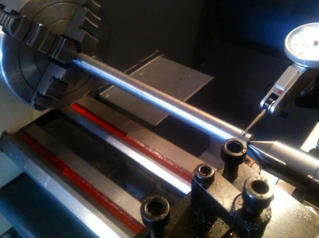

                @garryc
                Day 7.
                Think I need to take just a couple of thou off the bar supplied for the crankshaft shaft to clean it up and fit the bearings. So I have the bar mounted in the lathe, it has about 5 and a half inches out of the chuck. I've not tried anything that long before. I've managed to set it at the chuck so the dti doesn't move (just a tiny flicker but not moving halfway between the 0.01mm divisions. The tailstock end of the bar has 1 thou deflection over a full revolution but if you slide the dti over the top of the bar for the entire length there is 3 thou difference. It is only a very small (and cheap) Lathe at the end of the day I suppose, I'm hoping that will suffice. I presume I can't take just a couple of thou off the bar though given the 3 thou deflection – have to see how I get on…
                (Could someone please yell at me if I'm about to turn a disaster – thanks!)
                Cheers
                Allan
                ps I've just had a thought – I haven't checked the actual diameter of the unturned bar to see how accurate it is end to end – may have something to do with it of course…

                    The 0.003" along teh bar suggests the tailstock is not inline with the headstock and if you make a cut you will end up with a bar that tapers 0.006" over its length.
                    Just going to have my dinner then I'll suggest what to do if nobody else does in the meantime.
                    #126546
                      Just read your post again as the difference is along th etop there is not a lot you can easily do to improve things. Make sure there is no swarf traped between the bed & tailstock, try taking out the centre and putting it back in another position as it may not be perfectly true and at the same time check there is no muck in the taper socket stopping the ctr seating correctly.
                      The other thing to think about is is turning the rod down the best option. Its likely to be an imperial bar of nominal 7/16" dia which usually comes out a thou or two under size so rather than try to take it down to 11mm and not get such a good finish on the bar you may be better off reaming the holes out to 7/16"
                      J

                        Having sweated blood to turn crankshafts parallel over several inches, I wuld say a beginner is likely to make it too small before getting an ideal finish and suitably parallel. I would just polish the bar up and be happy.
                        As I recall the stuart 10 uses 7/16 bar straight out of the box.

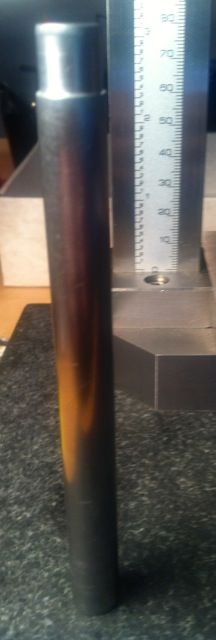

                            Day 8.
                            Turning the Crankshaft shaft.
                            The shoulder between the two diameters is not as square as it should be I think.
                            The micrometer readings for the ends of the main diameter came out at 10.95mm for the crank end and 10.97mm for the other – I think beginners luck was at work..The fit in the bearings seems nice – maybe too close.
                            Turning the small diameter on the shaft.
                            The shaft, just needing the crosspin hole. (the brown colour is just a reflection..)
                            Can anyone please tell me if it would be ok to fit the crank to the shaft and then drill through both to fit the crosspin (in the small diameter) or should both be drilled separately – it would seem easier to drill both at the same time? Thanks.
                            Regards
                            Allan.
                              Yes, that's the usual way. More important to have perfect alignment than exactly on the diameter.

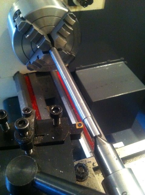

                                  Allan Is there any reason why you have such a long piece sticking out of the chuck ? A centre in the tail stock and the tail stock seems to be extended will flex You shoyuld turn as near the chuck as possible Just a suggestion
                                  Roy
                                  #126700
                                  GarryC
                                    @garryc
                                    Hi Roy
                                    Sorry, the description for that photo is misleading – I had to turn down the entire length. The supplied bar for the shaft was I think 11.1+mm, I only had an 11mm reamer for the bearings so I had to cleanup a little. I could maybe do with an adjustable reamer set..
                                    The tailstock is extended to reach over the saddle in order to get the tool to the end of the bar – the Lathe is very small and sometimes a bit short on space. Although that being said I am very very pleased with it – SIEG SC4.

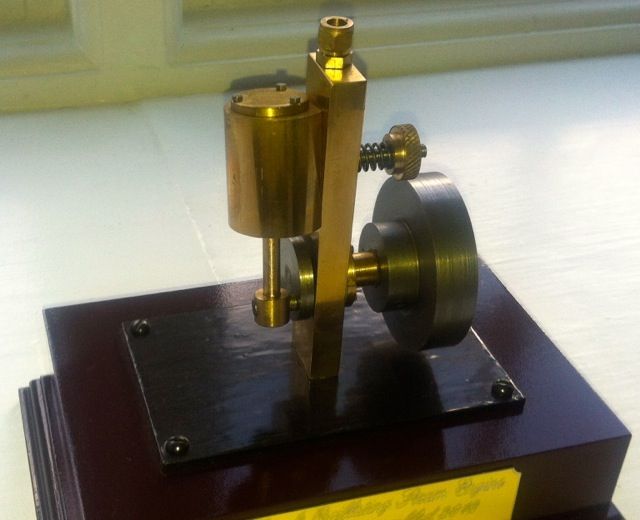

                                                Roy you are quite right I am a complete novice to model engineering, but have had a lifelong interest / passion for the 'old' mechanical world, especially steam – I've never had the chance to attempt Model Engineering until recently – all my working life I (like all too many nowadays) I have always worked all the hours going with no time for anything else..
                                                I did about 35 or so years ago have an apprenticeship as a fitter / turner with British Steel and spent a couple of years training on the Lathe etc – but apart from remembering that I loved it I have forgotton all the info (but not the people) – I had to leave to find better paid work at the time.. Every now and then I come across or do something that I can remember and it brings back some great memories.. There were a lot of very skilled men there then (all over the country in those days..) – can't help but feel sad they and the skills have mostly dissappeared. There are many extremely skilled people on here of course – I dont know how much longer they will put up with my endless simple questions!
                                                This is my first real project although about a year ago I did complete a 'simple oscillating steam engine' from bar stock and plans that I found on the internet – this is my first to include any castings and fittings etc… At the risk of it lowering the tone of the site there is a pic below, a simple thing I know and not very well done, but I absolutely loved doing it. A house move has come between now and then..
