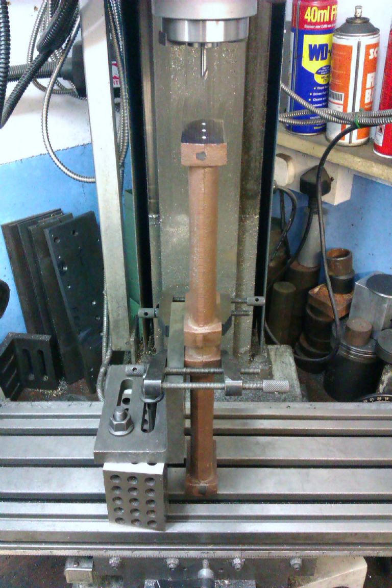

      I am following the excellent instructions by Harold Hall for this project. I am a bit confused with this part
      "Mount the length of material on the top slide, packed up to centre height, and with a centre drill in the drill chuck position it such that its larger diameter just touches the materials rear edge. Traverse the saddle so that the workpiece is clear of the centre drill and then, using the cross slide, move the part 5/16” plus half the centre drills diameter and centre drill the end of the workpiece. Traverse the cross slide by a further 3/16” and centre drill once more"
      Surely the size of the centre drill will move the centre point or am I missing something ?

          Basically you touch the edge of teh casting against the edge of the ctr drill. If you then move the topslid eby half the drill dia this will mean the centre of the drill is at the edge of the work. Now move a further 5/16" and the hole will be drilled 5/16" from the edge of the work.
          You are in effect using the shank of the drill as an edge finder where once the finder touches the edge you are tehn 1/2 the end dia from the edge of teh work.

              The reason for doing it on the lathe (or mill for that matter) is that you can accurately get both ends the same distance apart by using the handwheel dial. No everybody can mark out and punch holes to 0.001" accuracy.
              Here is one I did last week on the mill, the marking out was only toi get the approx position of the first hole the rest were done using the mill to get the spacing
