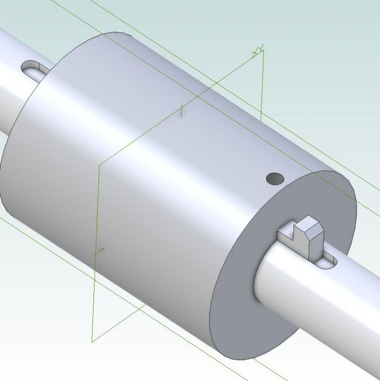

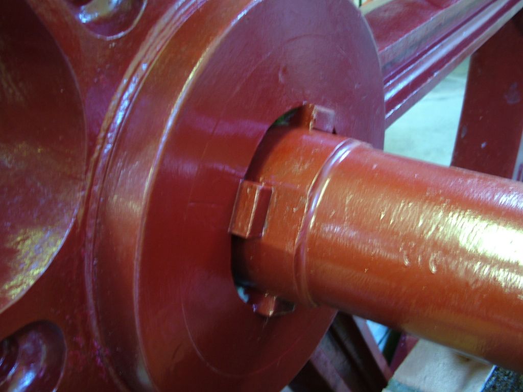

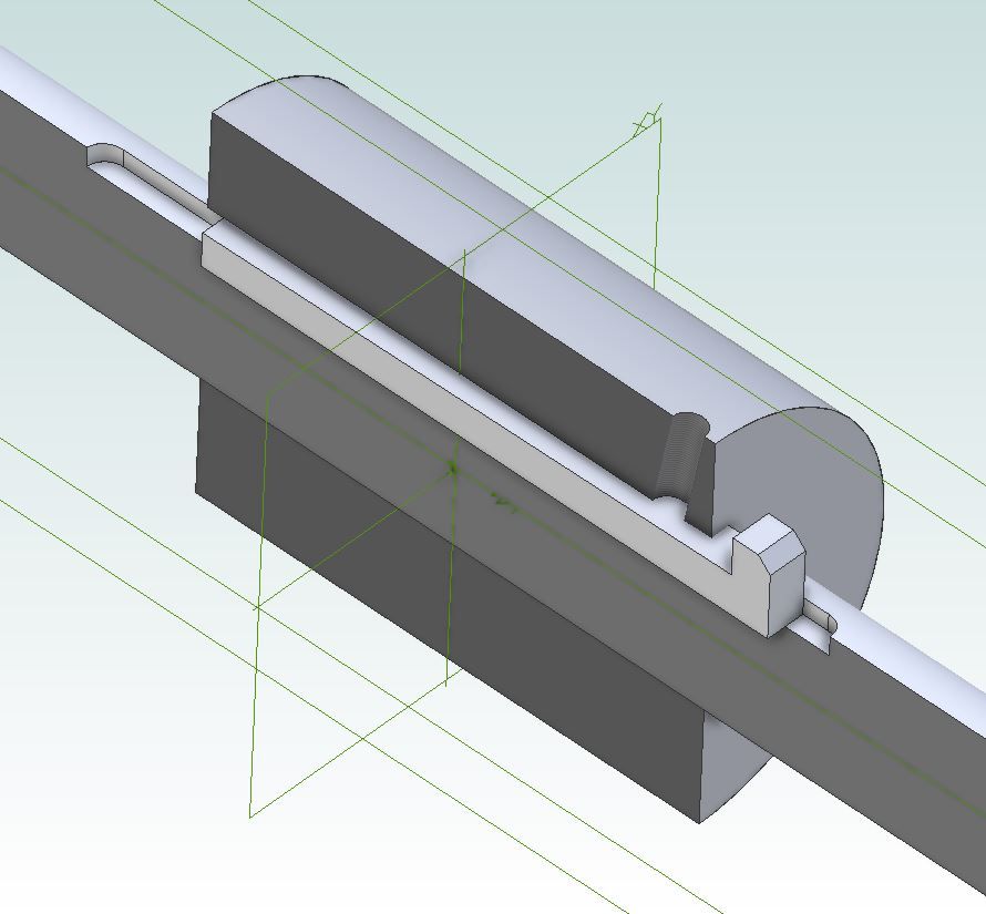

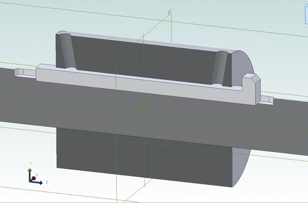

            #609031
              Ramon this should show what I meant by "head end" the grub screw is towards the head of the key so will only add further tilting force, had it been at the narrow end of the key it may have counteracted and tilt induced by the key.
              I think our thoughts are basically the same, For what the Doc can do with his kit:
              Single keyway in the shaft which I would have with stopped ends not extending beyond largest dia.
              Single parallel keyway in flywheel as it's easy to cut
              Parallel key with a head for looks which will provide the drive.
              Small M3 grub screw at each end of this slot to take up any slack in the fit of the flywheel on the shaft and also stop the flywheel moving along the shaft. Screws to bear on key so you don't chew up the shaft
              Optional additional keys and keyways for looks only is desired
              Edited By JasonB on 10/08/2022 11:25:11

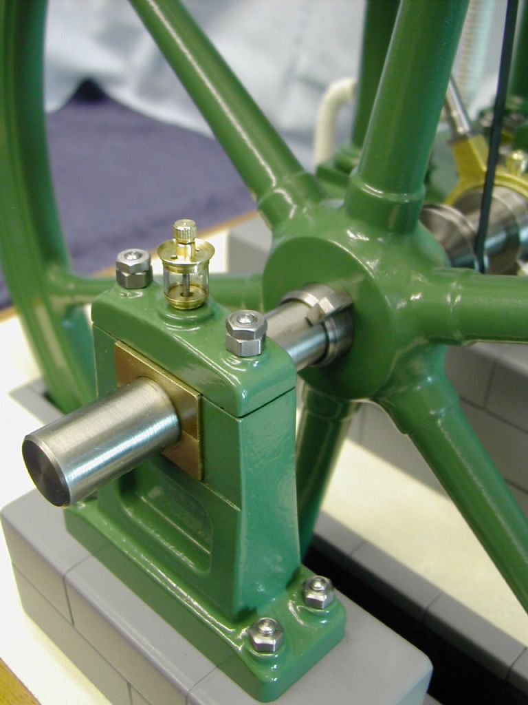

                  When I made my similarly sized model mill engine I just used a grub screw to hold the flywheel on the shaft and no apparent runout. I did make the reamed hole in the middle a good tight fit on the shaft so it could not cant. I can't see a decorative key not driven in hard would make any more difference than the jacking effect of just a grub screw?

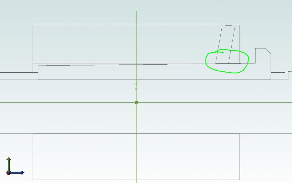

                        #609056
                          Posted by Dr_GMJN on 10/08/2022 12:57:08:
                          Jason's answers in bold
                          Ha ha I'm totally confused by all this.
                          Why is there any jacking using a tapered key, when the tapered part of the key never touches the hub?
                          The key touches at one edge of the hub, see the ringed area on my sketch in previous post as said earlier this can tilt the flywheel particularly if the hole is a bit loose. A grubscrew in the same situation will also tilt a poor fitting flywheel
                          Ramon – why is a tapered key secured with a grub screw a dummy? The driving torque is being transferred entirely by the resistance to shear of the key, albeit over a reduced area due to the taper. The grub screw isn't taking any shear or driving torque whatsoever, it's only there to stop the key from moving relative to the hub.
                          A properly fitted tapered key into a tapered keyway DOES NOT need a grubscrew. The friction of the two tapered faces hold the key in place and neither that or the flywheel can move along the shaft. Key that does not make full contact won;t hold the flywheel tightly and it will soon come loose
                          I totally get the wedging action of the tapered key in a tapered slot being used to avoid putting the flywheel out of plane, but that principle is (I think) totally redundant in how this model was designed. The tapered key actually doesn't need to be tapered at all – as far as I can see, it's a completely un-necessary red herring in terms of function for this model, although I could imagine it may be a bit easier to fit than a parallel key.
                          Hence my last image of a parallel key, the taper is not needed if a screw is used
                          Jason – I can't put wedges in from both ends of the hub, because there's no gap on the governor pulley side. I can see that having two tapered keys would eliminate tilt, but only if they were tapped into the hub enough that they would wedge the hub out in the first place. But that's not the case, so….I'm lost.
                          It can be done and I have done it but not worth going there as it will just complicate things
                          I could post photos of 20+ models I've made with proper keys and keyways but again not much point
                          Edited By JasonB on 10/08/2022 14:05:28

                            #609068
                              Posted by Ramon Wilson on 10/08/2022 14:53:08:
                              From the outset I said the object is to DRIVE the flywheel by a key – I agree you will be doing this with Docs drawn key but only by a marginal area. That marginal area, as previously stated, will soon wear in my opinion with the starting torque inertia and lead to rocking. It is not the correct way to fit such a key.
                              Not sure I follow that Ramon. if by drive you mean th erotational load from the shaft into the flywheel then the tapered key into the parallel keyways will transmit maybe 99% of the load that a plain parallel key would as there is almost full contact with the side of the key and the keyway in the flywheel.
                              The only thing it doe snot do is stop the flywheel coming loose and sliding ALONG the shaft
                              The whole top half of the key in the image below is driving against the side of the flywheel keyway.

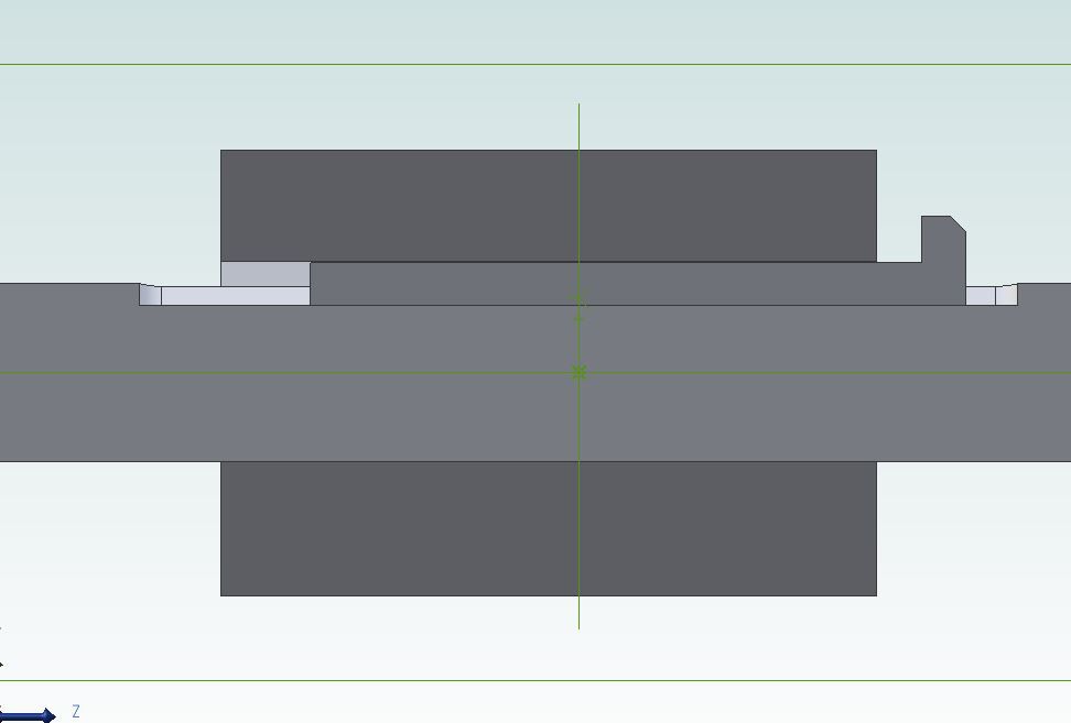

                              #609073
                              Ramon Wilson
                                @ramonwilson3
                                Yes I agree Jason but I said Doc's key as drawn – marginal at best.
                                What you show in your drawing here is a much longer shallow taper key with a considerable length of 'drive' and much improved This is just as I described in my three examples above but the taper filed on top is even shallower and the fit over a longer length very tight (radially) as well as a good fit in both slots. No matter how slow a taper it will only bear on one point of course – if over tightened be ready for that slight but possible tilt though a wide flywheel such as this that should be minimal and yes, as I said too, a discreet grub screw is all that's required to prevent lateral movement along the shaft – something despite the eight keys I did on the Corliss flywheel wink

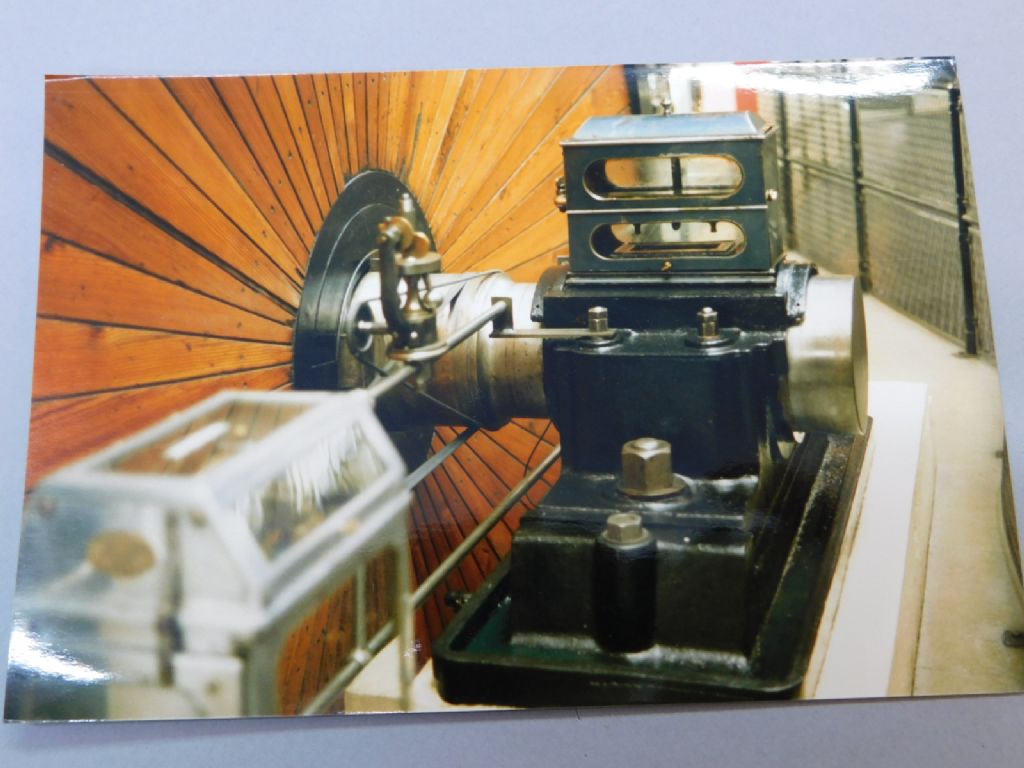

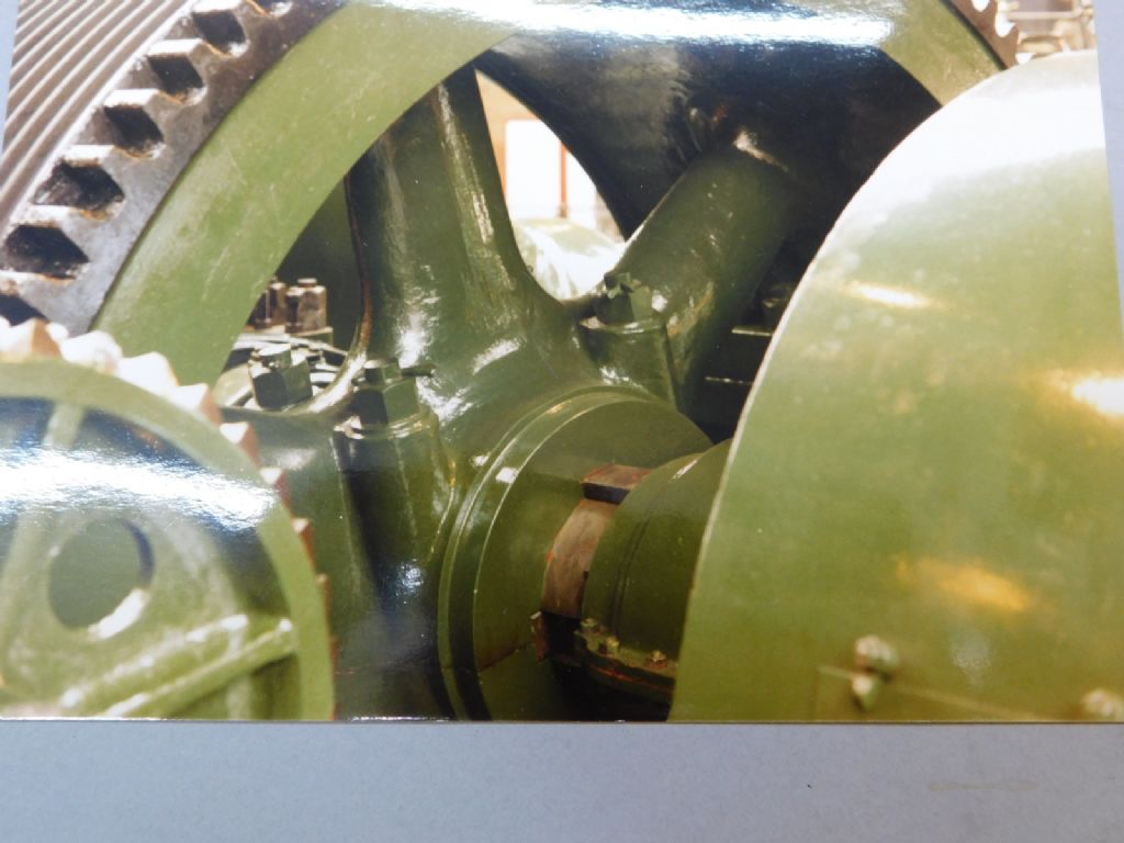

                                I found this pic of the 'staked' flywheel on the Corliss in the Forncett museum – a bit dark but you can see the annular gap and the four keys if you click on it
                                BTW how do you insert or extract the gib key from the sunken slot and  flywheel in your first image (previous post) if such a long taper is machined on
                                Edited By Ramon Wilson on 10/08/2022 15:34:19
                                #609080
                                  Posted by Ramon Wilson on 10/08/2022 15:31:23:
                                  Doc reproduced the key from the drawings, no actual length given but it does say "length to suit" I would take that as just short of full width of the double hub so it does not hit the pulley.
                                  Scaling in CAD it comes out about 1.75" long overall. The pair of hubs total 1.75" wide so about right
                                  This is it drawn with both at 1.75" long, does not look bad engagement to me, extra 1/8" length on the key would be all it could take.
                                  #609087
                                    For flywheels I have done with a tapered key in a stopped keyway mid way along a shaft there are two options.
                                    The small amount of extra length in the shaft keyway is usually enough to prize the key out enough to break the taper. Folding steel wedges (I use one side of my drill chuck removal wedges) will go between head and side of flywheel or as mentioned earlier tow flat bladed screwdrivers have a similar effect.
                                    The other way is to hold the flywheel in your left hand and hit the end of the shaft with a nylon faced hammer in your right which will usually break the grip of the key. This method is also the one to use with a non headed key that is the full length of the shaft keyway. The big Easton and Anderson I made was of the later type

                                      I drew it to scale as well, and I wouldn't call it marginal. In fact with a 1:100 taper (nominal 1/8" thick), length my interpretation as "to suit" (as per the instructions), you get all the shear area of a parallel key – represented by the dashed line):
                                      I've not shown the grub screw, but that's pretty irrelevant.
                                      The other key is stated as being "rather shorter".

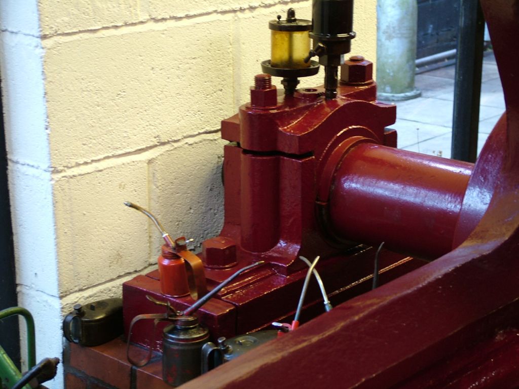

                                        However short of knocking on the flywheel (and off) with the key already in the slot which of course one can do so easily when it's in your hand that is very unlikely full size – which is what I thought you wanted to try to replicate. My apologies for this misunderstanding.

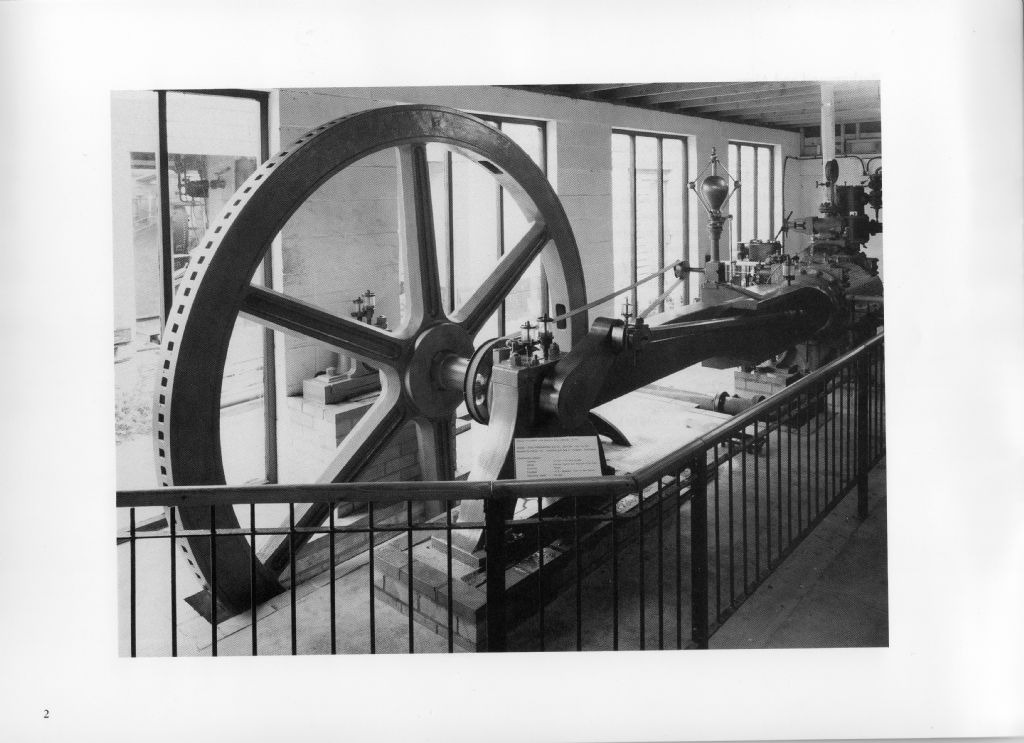

                                        I have found some old photographs this afternoon taken at the Science and Technology museum in Manchester. I can't scan them but I can take an image so will do so later. there are several details that may be of help.

                                                I have been following this section on the use of tapered keys. There is some discussion regarding a tapered keyway in the flywheel but no one has put forward the possibility of putting a tapered keyway into the shaft. I would think that a tapered keyway in the shaft is a relatively simple option compared to cutting a tapered keyway with a tapered bushing down a hole. Having had discussions in the past (not on this forum) with a designer regarding keyways and keys on tapered joints I see no problem with a tapered slot in the shaft. The keyway slots I ended up doing in the tapered hole and shaft were both parallel to the axis of rotation but were not parallel to the line of contact of the two parts. As Jason or Dr_GMJN pointed out earlier the relevant shear section of the key is not changed by its orientation, parallelism or taper. I would use my 5" sine bar with a 0.05" gauge block to set up to cut both the key and the shaft keyway to a 1:100 taper.
                                                Martin C
                                                Edited By Martin Connelly on 11/08/2022 10:47:36

                                                  Ramon,
                                                  lol, I am afraid it was my rather obtuse sense of humour. I was just surprised given the frequency loctite and similar products get suggested on here that no one had chipped in with the familiar cry “loctite” so I thought I would cast the line! For the record I wouldn’t seriously consider it for this application either but do bear in mind that there are various grades of the stuff and it’s not necessarily for ever as some can be separated by application of relatively mild heat.
                                                  Quoting you “No one in the right mind would use Loctite to fix a flywheel in place. Loctite has its right place in engineering but this is not one of them – That would make the flywheel and crankshaft a one piece item to my mind. Whilst not an actual issue it's just not a direction someone making a representation of a full size engine should consider to my mind. Once it's on it's on and IF it needs to be tweaked there's no chance.” If someone is making a representation of a full size engine though why not use the techniques used on the full size? Is a grub screw or two more heretic than a blob of loctite? Neither mirror the prototype
                                                  On the closed keyway / gib head key issue I have seen that done on line shaft pulleys but by and large I would agree with you this is not a very common way to fit that type of key.
                                                  Martin,
                                                  I don’t see any issue at all in reversing the taper and applying it to the shaft, should be exactly the same effect.
                                                  Paul.

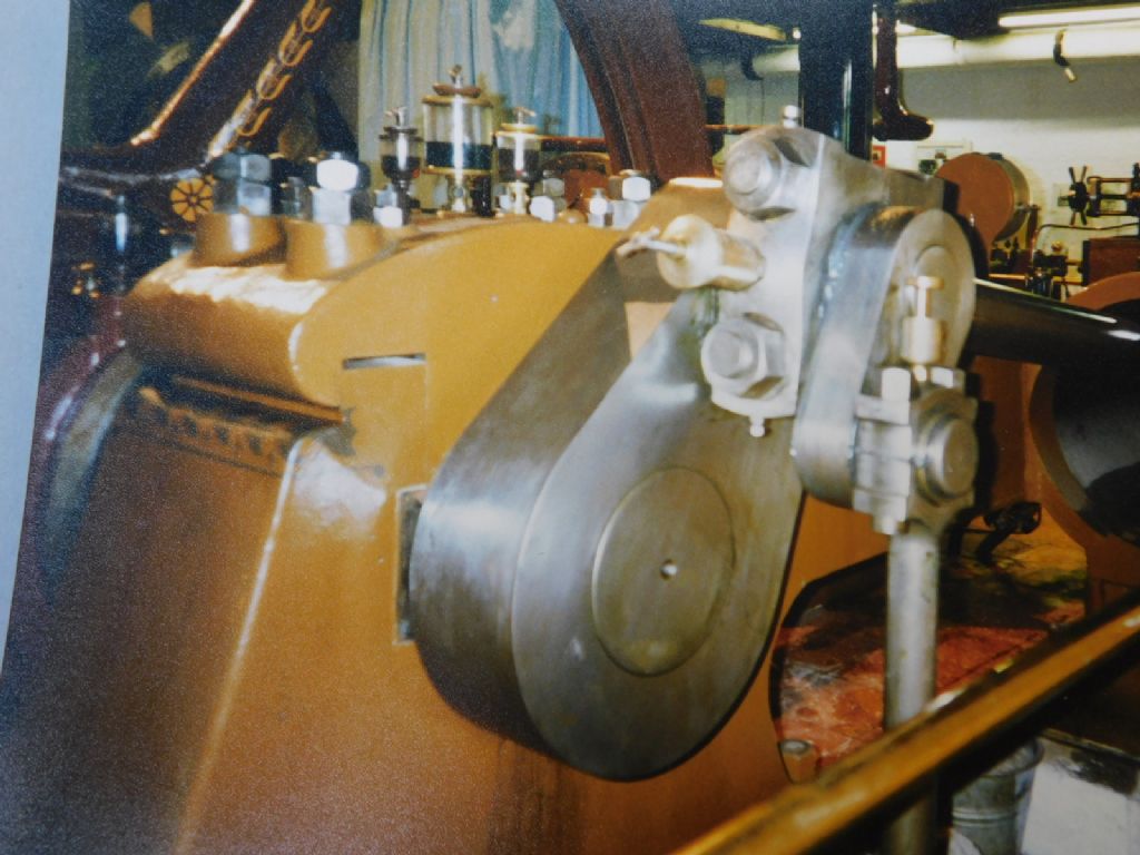

                                                    Whatever, Doc G has more than enough to make a decision on but here are a few images that may help, not only on flywheels but other areas too
                                                    You can only just see the staked keys on this gorgeous McNaught Corliss valved engine in the Science & Industry (not Technology as previously said) museum in Manchester
                                                    This is the flywheel on the Galloways piston drop valve cross compound engine at the same place
                                                    A main bearing on another cross compound in the Kew Bridge museum. Built by Simpson it has an identical twin which was situated in the Strumpshaw St. Eng. Museum in Norfolk. Note the centre in the shaft, no key in the crank web and thin nuts on top plus other details.

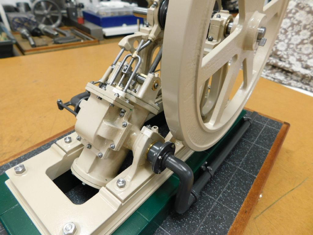

                                                    And another main out rig bearing, more in keeping with Doc's intentions on the Hick and Hargreaves Corliss valved engine in Forncett. Note the typical variation in nuts on a renovated museum exhibit
                                                    Hick 2
