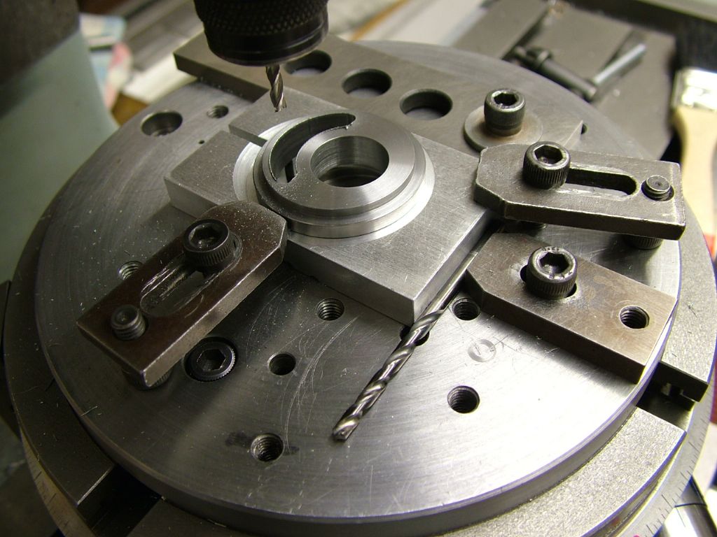

                                        This is the beginnings of the fixture for holding the end caps in place on the rotary table – for machining the diamond shaped bosses:
                                        Slides along the jaws of the vice to re-set the ends under the spindle centreline – as per the valve chests, but of course they weren’t circular:
                                        Intention is to drill and tap the mounting holes and screw the cap to the fixture.
                                        Puzzling over how to make sure the gland clamp holes are perfectly in line with the 9 and 3 o’clock mount holes. Currently machining a clamp out of aluminium as a test – Intention is to use that as a template to spot through onto the cast iron cover when it’s a best fit, then drill all four holes on the mill in one y axis setting.
                                        #602074
                                          Two small flats would have done for going against the jaws. and left you more metal for other uses of the jig
                                          As for setting the position of the holes place your jig in the vice and get it directly below spindle. Then loosely put the cover in place and move the mill table to the hole offset. Put a bit of something round in the chuck approx dia of the rounded end and bring it down so you can eyeball the position over the end. Move to other offset and double check that end adjusting to get the best for both and then tighten cover in jig. You then drill the gland and PCD ring of holes at one setting using co-ordinates from that centered position before altering the rotary table angle to mill the glands.
                                          But before all that get your glands turned and drilled for the two stud holes. That way once the cover is drilled you can screw it into place and mill to shape at the same time as tidying up the gland boss.
                                          Or forget the above and simply screw the turned gland on and file to the shape of the boss which will act as your guide.

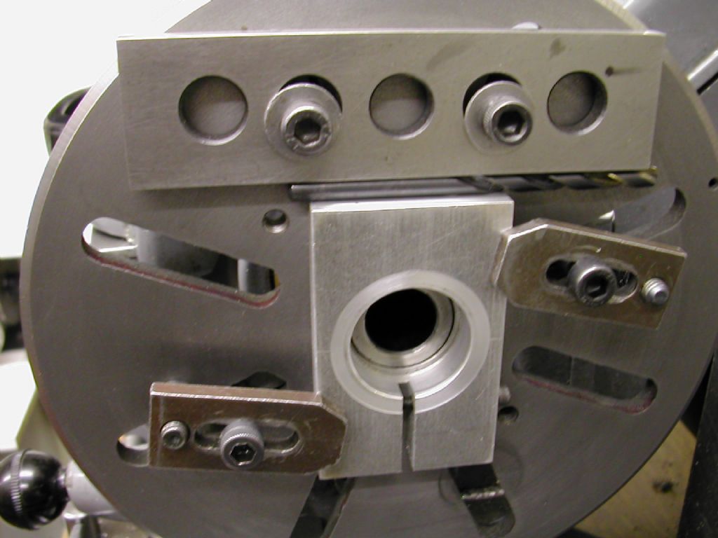

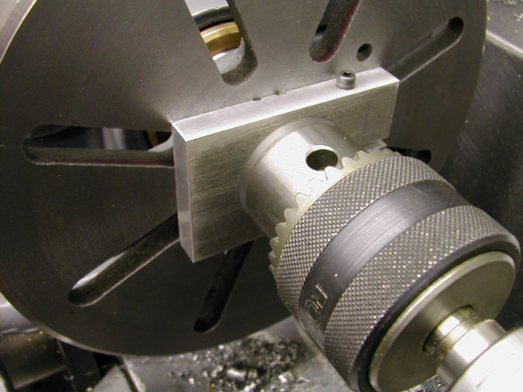

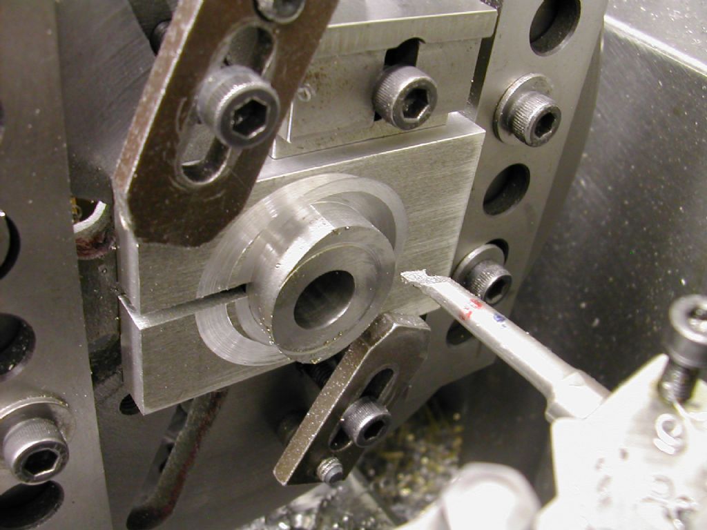

                                                #602106
                                                Ramon Wilson
                                                  @ramonwilson3
                                                  Whilst I certainly compliment you on the thought you are putting into this Doc I do think that you might be over thinking the process from the fixture point of view.
                                                  I've found these image from a couple of build that might be of help in the future.
                                                  This is the type of ali split clamp fixture I was referring too. It's being recycled from previous use and is for holding the eccentrics. The drill diam is the amount of throw of the eccentric, the parallel being set to the clamp not the other way round.
                                                  The initial set up is as described before by 'cone'
                                                  Once set up the fixture is bored to take the part then released and moved over the 'throw' amount. Drilled and reamed for the shaft and the boss turned
                                                  Whilst the above is on the lathe the principle is easily transferred to the mill on the rotary table.
                                                  Incidentally setting the work piece with a cone from tiny to big is pretty accurate but don't use a pre – tapped hole as a location – unless you have counter drilled the first the first thread out before threading (best practice anyway)
                                                  In early days of my journeyin ME I was told by an old and much missed 'mentor' you ought to make your self a toolpost drilling/milling spindle. He was absolutely right, but you do need means of dividing in the lathe for it to be of best use. I think you have an ML7 in which case the 65T bull wheel is not of use but an expanding arbour inside the rear of the spindle to hold a gear and a firm detent is well worth making.
                                                  Sorry for more pics on your thread but I do feel they are relevant.
