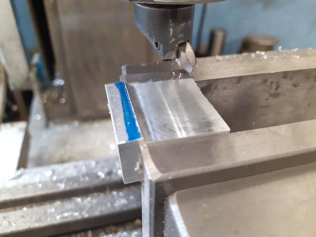

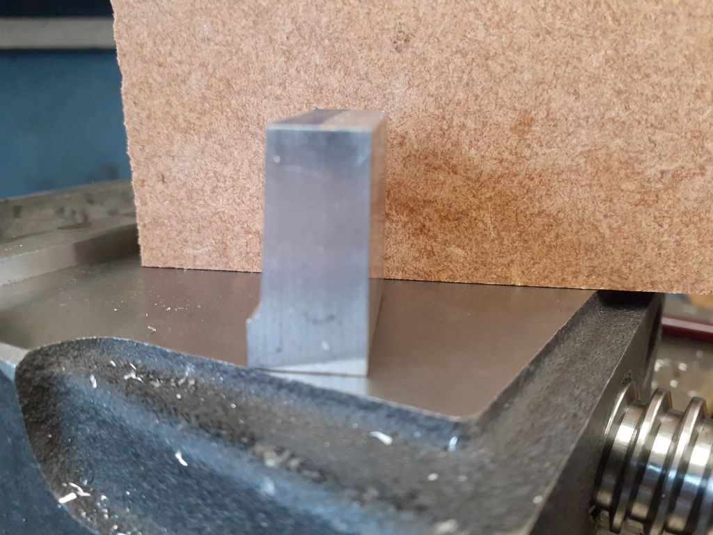

                                Looks like 1/2" dia. mild steel bar would accomodate the rectangular ends with minimal waste. Also, it would only be under 4 mm to remove on radius, to turn down to the minimum diameter of the circular section part. For what it's worth in material costs (only a few £'s), I'll get both, make a start and see what happens. Likewise with tool grinding. I need to sort it so might as well make some mistakes and start learning.
                                I've never really had any issues at all with fly-cutting on the mill – always got good surface finish, no chatter. Milling on the other hand has been problematic for me from day 1 on the SX2P, especially side milling. Chatter and 'ringing' never seem far away on anything from steel to aluminium, slot drills, end mills, cheap/premium tooling. Anyway, that was a different thread altogether. I suppose building the 10V, and it actually working, means that it wasn't that much of an issue for parts of that size.

                                  At 6" you have a suitable grinder but is that a wire wheel on the other end of your linisher? That could be your second finer grit wheel if so. The wheel on your other grinder certainly needs dressing – and would be ideal for roughing. Star wheel dressers do work but do so ferociously – have every thing covered up with something disposable and a vacuum held close by by a helper will be a big bonus to keep dust to a minimum – Better to do this outside if you can. Fine truing can be done by diamond if you have one. 46 grit for roughing and 60 for finishing is about ball park for HSS. Finer grit is okay for finishing but will glaze over quicker. Horses for etc
                                  If you are happy with flycutting then go for it. Sound though like you may possibly have some bearing issues with your mill spindle if you experience excessive chatter/ poor finish when cutting on the side. What size cutters are you basically using. I would say that 85% of my machining even often on large parts are done with 6mm or 8mm throw away cutters – small cuts at higher speed and fast feed rates certainly takes the strain off the machine and removes metal just as quickly overall as a larger slower cutter will. Does mean a lot of handle swinging though. I do have a good range of cutters to choose from but definitely the most used (worn) cutters lying redundant in a box are mostly 6mm and 1/4 FC3.

                                    I'll just crash on with grinding some of the HSS tooling I've got, but never use, and see what happens on some test material.
