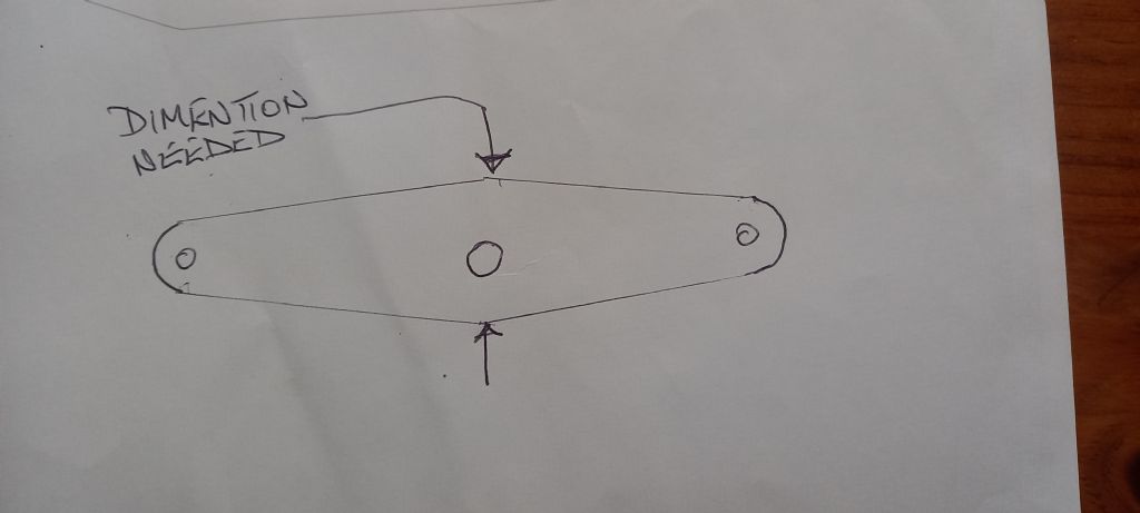

        Hello all, Ive got the drawings for a Stuart Grasshopper Engine and I am to make this at .65 scale of the drawing. I have a nice cast brass flywheel at 41/2 inches diameter so thats why Im doing it at .65 scale. My question is the drawing of the beam is a cross section and does not show the width of the beam. Has anyone got a measurement of the full scale beam width, I got a rough idea but the yokes that fit inside , if I make it a bit big it could hit them when the piston moves up and down.

        #577970
          Bob as it uses the same beam casting as the other beam engine I would think it fair to assume they are the same which is 3/8" for the end and linkage bosses and 1/2" for the central one
          #578021
          BOB BLACKSHAW 1
            @bobblackshaw1
            Thanks Jason, I have that measurement , but it's the beam width from the middle, the actual size of the beam only.
            Thanks Bob
            #578032
              Sketch on a drawing and post a pic of the dimension you want. I'll measure my beam
              #578037
              BOB BLACKSHAW 1
                @bobblackshaw1
                #578039
                  Bit tight to get the callipers in but I'm getting 39mm though could well be 1.5"
                  End radius is 3/8"
                  #578082
                  BOB BLACKSHAW 1
                    @bobblackshaw1
                    Very much appreciated Jason. I intend to fabricate it rather than one piece.
