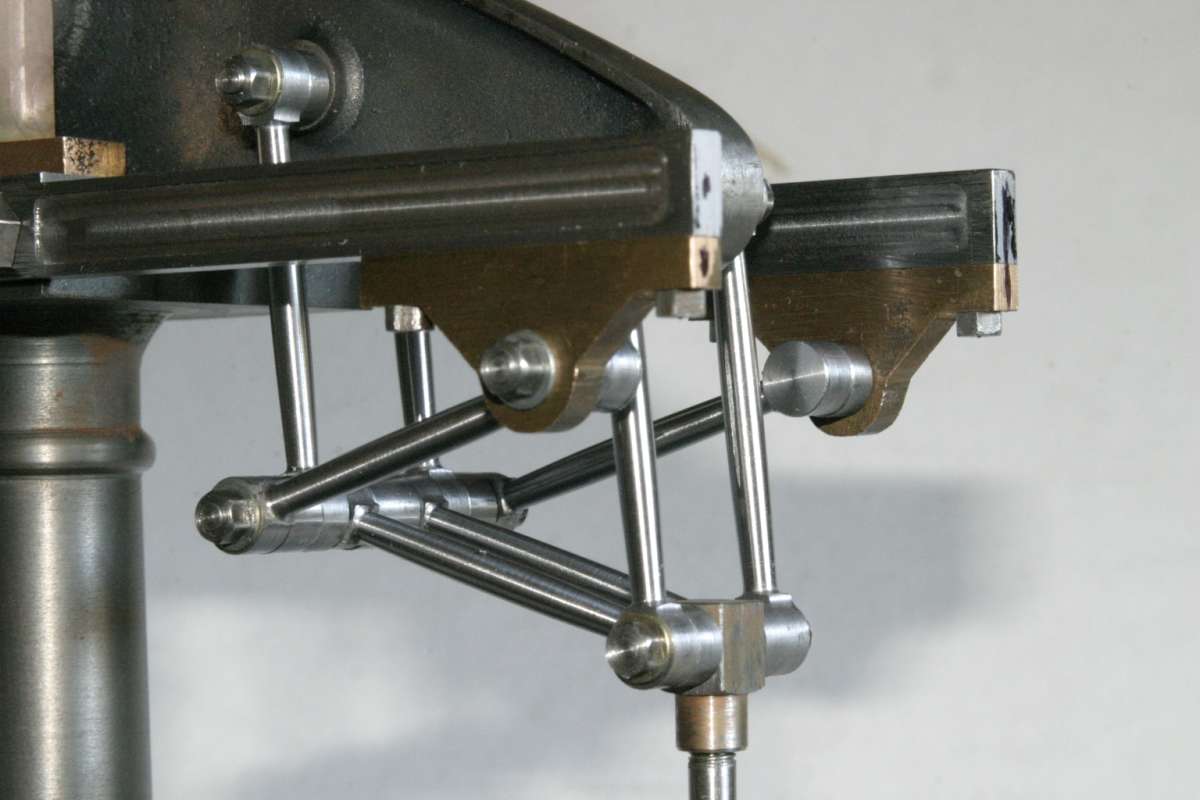

                Mill most of it with a small dia cutter on a rotary table then blend into the fishbelly with a needle file.
                Some people silver solder round rings onto round or bellied material.

                  The way I made mine was to drill/ream the holes in the 1/8 x1/4″ stock at the appropriate distance, with the end hole a sufficient distance in from the end to allow a small centre to be put in the end for tail stock support while turning the fish belly so that when the end is rounded off the centre would disappear. Then mount in the 4 jaw, with the outer end  running on a live centre, to turn the fish belly section. Cut off from the parent stock leaving sufficient for the rounded end. I then mounted them on my small rotary table and milled the round ends with a 1/8″ end mill, stopping just short of the fish belly to leave a small square section as visible in the pic below. (or you could then blend it into the fish belly with a needle file as Jason suggests if you think it would look more aesthetically pleasing).

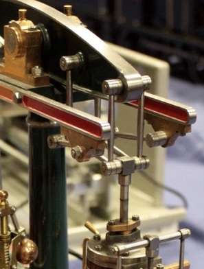

                      I made these by machining from solid, cutting tapers with the topslide and then finishing with a hand file and abrasive paper on the lathe….

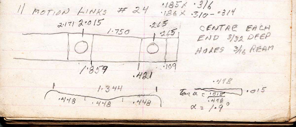

                              If you go with a method similar to what I did, here is a snipit of my notes showing how I laid out the stock material. From the notes it appears that the material supplied for the links was 3/16″ x 5/16″, where as the plans call for the links to be 5/32″ thick with 5/16″ dia. eyes. My notes don’t say, but I must have milled .015 off each side before turning the fish bellies, as else where in  my notes I list the eyes as being .160 thick (just measured them and they are .160). For the centre I used a #1 centre drill, drilled in 3/32″ point depth as shown. I laid out a link on each end of the supplied bar so I had plenty to hold in  the chuck. After turning the centre section to 5/32″ dia. I turned the fish belly by setting over the top slide 1.9 deg first one way then the other to taper the ends for the dimensions shown below then blended the three sections together with a fine file and abrasive paper. I used a 3/32″ wide parting tool with a semi circular end to turn the tapers so as to leave a fillet at each end. Hope this might be of  some use.
