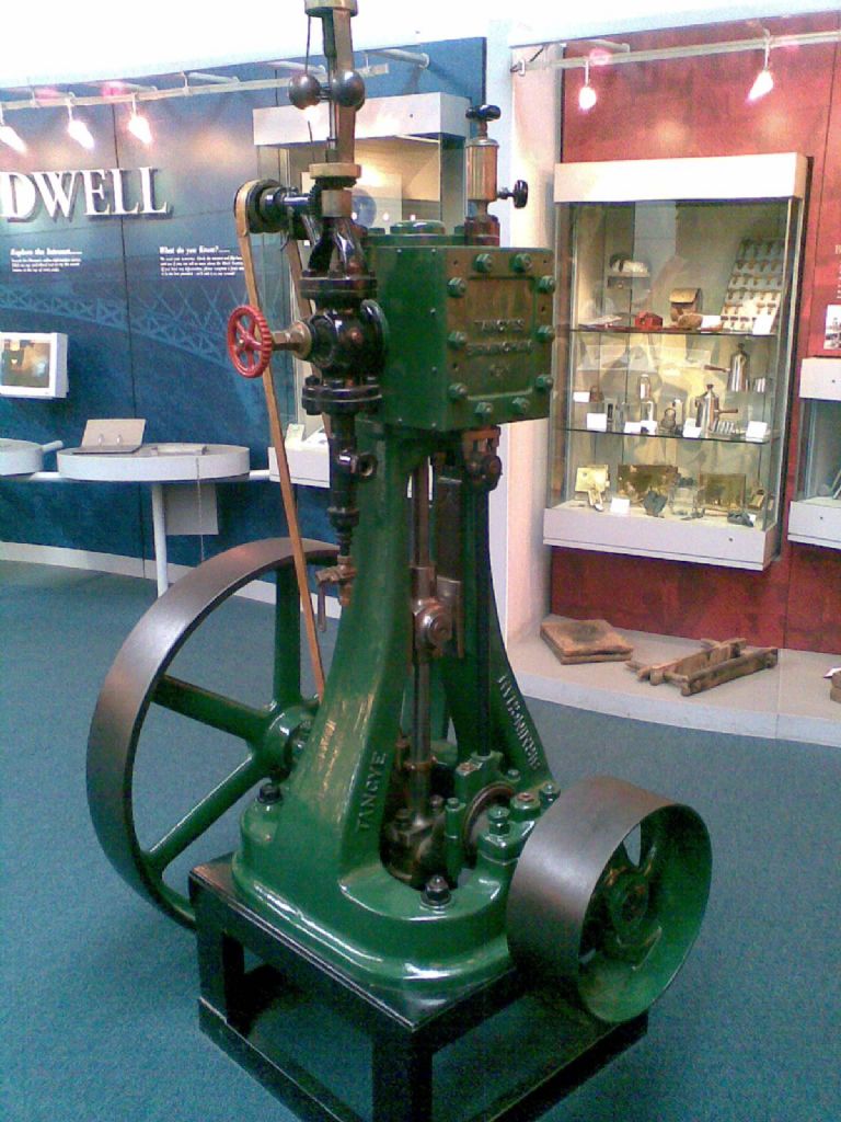

                      #502156
                      duncan webster 1
                        @duncanwebster1

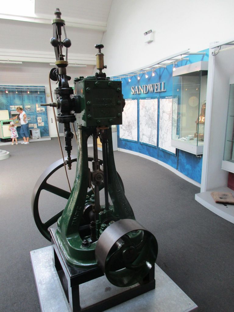

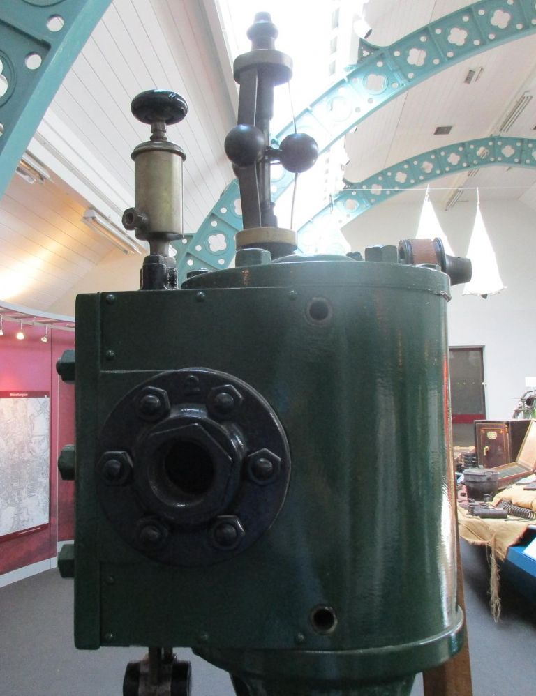

                        That's a combined (Pickering) governor and stop valve. The three balls are connected to leaf springs, as the engine speeds up the balls move out and push the centre spindle down. This is connected to a double beat valve which controls engine speed. Governor operation shown in Pickering There is what looks like an identical valve on a Tangye engine in the Bolton Steam Museum, but the picture doesn't show it well BSM
                        The red handwheel is connected to the stop valve. Tubal Cain (the English one, not that American upstart) did a series of articles on governors in ME back in the mists of time. If anyone is really interested I might be able to find a copy. Governors make nice visual additions to models, but are very difficult to get to work, all sorts of scale effects work against.

                          Posted by duncan webster on 19/10/2020 14:32:39:
                          "Tangye engine in the Bolton Steam Museum, but the picture doesn't show it well "
                          That picture looks to be of the Tangye in the Black Country Living Museum near Dudley.
                          The back drop looks remarkably similar ! I've not been able to find the picture I took !
                          Edited By John Baron on 19/10/2020 16:04:13
                          #502213
                          duncan webster 1
                            @duncanwebster1
                            Neil's picture might be an engine in the Black Country Living Museum, but the one I linked to is in the Bolton Museum, unless it's been nicked! Peaky Blinders operating in Lancashire? They do film it in Cheshire.

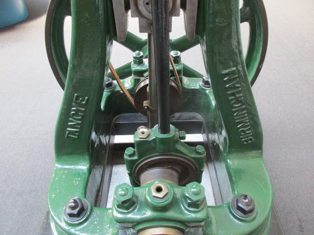

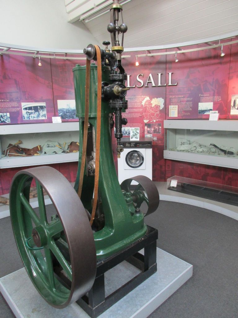

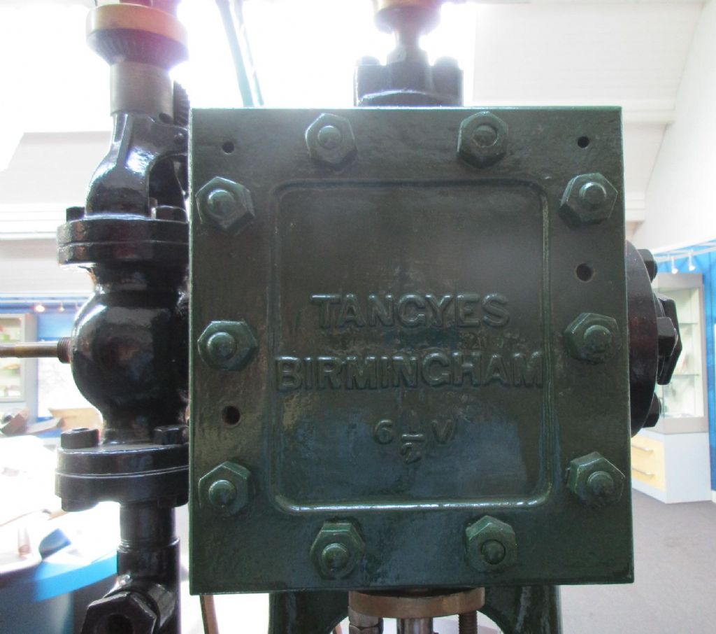

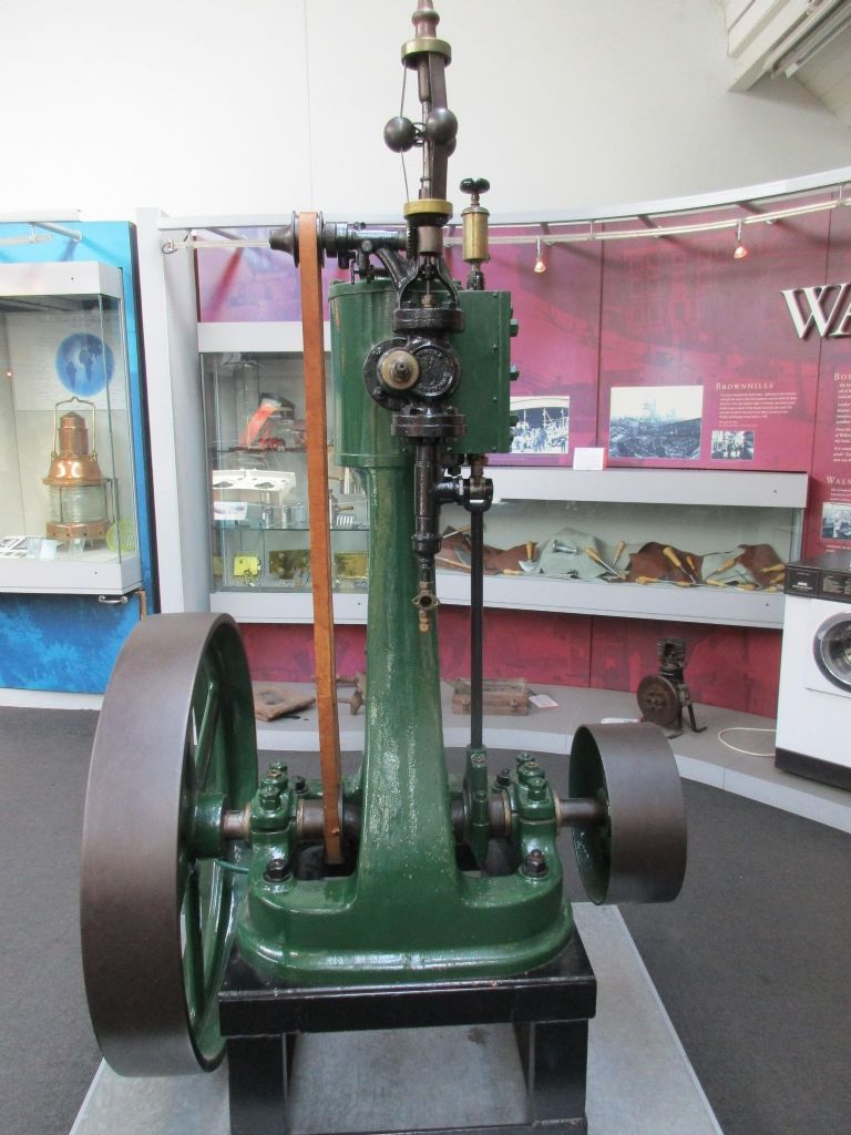

                              Posted by duncan webster on 19/10/2020 22:38:26:
                              In that case its been nicked !
                              These are the pictures I took of it when visiting the Black Country Living Museum in Dudly Nr Birmingham.
                              Now I've not been to the Bolton Steam Museum yet, this blasted cov19 has seen to that !
                              These are the pictures that I took in 2017.
