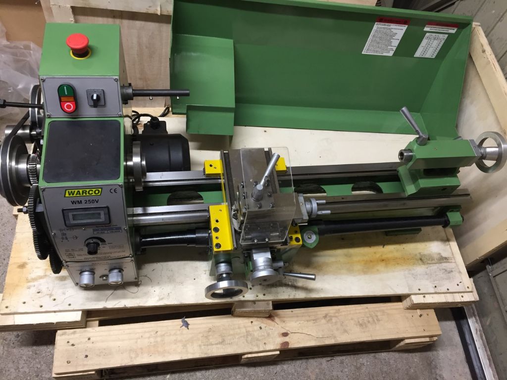

      I received my new Warco WM250V last Friday and have been slowly getting things together in the workshop ahead of installing it. I'm having to do a lot of sorting out and moving around, but have also unpacked the crate and at least verified that the motor and speed control work. I'm going to fit a DRO system and thought that it would make sense to fit the scale for the Z axis before installing the lathe onto the stand, as accessing the rear of the bed will be more difficult afterwards.
      I also need to clean all the shipping grease off the machine and was wondering how far to strip down the saddle and cross slide. How easy is it to disengage the saddle from the lead screw and remove it from the bed?

        larry Phelan
          @larryphelan54019
          Why bother to remove it? Can you not just clean all around it. I would not strip anything from a machine unless I had to,it,s not always easy to get it back together again. Let sleeping dogs lie.

          Mick B1
            @mickb1
            As far as I remember, I didn't strip mine at all when I got it in April '15. I cleaned off the top surfaces of the bed and crosslide, and then I think I got to work.
            First thing I did was to modify the baseplate accessory so that it'd fit my Myford vertical slide – I wanted to mill a dovetail side plate to secure a finder sight to a 6" reflector telescope.
            The only necessary cleaning job I think I missed is the underside of the bedways – the blob of metal that is the tailstock nut could get stuck and sometimes wouldn't slide freely till I cleaned the crap off under the bed.
            Enjoy the 250 – I've been happy with mine. Just don't let the power feed overrun the limits of travel in any direction!

            Journeyman
              @journeyman
              Jonathan, Looking at your picture the lathe appears to be as clean as my WM250 was when it arrived. There is very little shipping grease on it. It is NOT necessary to take the lathe to pieces nor is it a good idea. Just wipe everything down with a rag and WD40 then wipe with a dry rag. Check carefully for any dents or scrapes on the bed etc. Oil everything copiously finding all the oiling points. Wind the bed back and forth check there are no tight bits. I found the bed gibs at the rear and the gross-slide gibs were all too loose for my liking, adjust as necessary. Check that the change wheels are assembled with the right clearances and grease or oil well (I prefer grease on mine, it stays put). That is all you relly need to do. I have probably forgotten something but someone will be along to remind me in a minute.
              Good idea to add the DRO before mounting the lathe access all round will make the task easier. Be carefull when you finally lift the lathe into place don't snag any of the DRO cables or scales.

                BC Prof
                  @bcprof
                  My WM280V arrived last week . I used WD 40 to remove the shipping grease . Wound the saddle and slides backwards and forwards a few time until the liquid came out clear , Lubricated the lead screw under the expanding sleeve added a smear removed the adjustable dials and gave the internals a smear of grease . Result, clean lathe and much improved 'feel' to the dials . Had to put braincell in gear to realise that the dial is calibrated for diameter change not depth of cut .
                  On a similar machine the American importers , Grizzly, recommend a ' break in' period followed by an oil change .

                      John Rudd
                        @johnrudd16576
                        Posted by Jonathan Mead on 14/02/2018 16:41:04:
                        In answer to the question, easy.
                        Removed the lead screw cover screws securing it to the rh support block, same on the rh side of the saddle.
                        Now remove the screws securing the cover on the left side of the saddle.
                        Remove the support block from the rh end of the lead screw, wind carriage to rh side of machine, ( take off the tail stock first) and disengage from the rack….you may need to support the lead screw…

                            John Rudd
                              @johnrudd16576
                              Lead screw can be left in position, preferably supported….
                              Just watch the covers, they are very springy…

                                            mechman48
                                              @mechman48
                                              Why bother to remove it? Can you not just clean all around it. I would not strip anything from a machine unless I had to, it,s not always easy to get it back together again. Let sleeping dogs lie….
                                              … As far as I remember, I didn't strip mine at all when I got it in April '15. I cleaned off the top surfaces of the bed and crosslide, and then I think I got to work….
                                              ​Same comments from me, I got mine back in 2012, I removed the saddle & leadscrew to fix saddle leak as well, it leaked from the 16mm plug at the bottom of the gearbox which you can't see without an inspection mirror. Watch out you don't lose the drive key from the lead screw I nearly did
                                              ​John Rudd gives you a basic rundown on removing the lead screw… but unless you absolutely have to take it out then DON'T, plus the spring coiled lead screw cover can be nasty to your fingers… don't ask!
                                              ​The drain plug is not a tapered plug hence the weeping oil I wrapped PTFE thread tape round on replacing it but it really needs a shouldered plug with a Dowty washer fitted, I'll either get a tapered plug or I'll make a shouldered plug from a 16 mm bolt on next oil change… probably autumn this year. In the meantime I keep mine topped up every couple of months, for the amount of time I have it running on my small bits, & the amount of oil that weeps it won't do any harm.
                                              ​I would fit a DRO system before you fit the fit the back splash otherwise as you can foresee it'll be difficult if you have the machine against a wall. I didn't have the finances to fit a proper DRO system at the time so have ended up using a couple of modified digital tyre depth gauges for my long travel & cross feed, both utilise neodyminininmum ? face 18​ magnets for attachment & work fine for me. the other item to check is the top slide gib strip on mine it was a miserable excuse for one, a piece of MS strip that only fitted where the corners actual touched, I made up a brass gib strip soonest. I have pics in my albums 'Lathe mods' if you want to peruse.
                                              Just get cracking on practicing & learning it's foibles… enjoy
