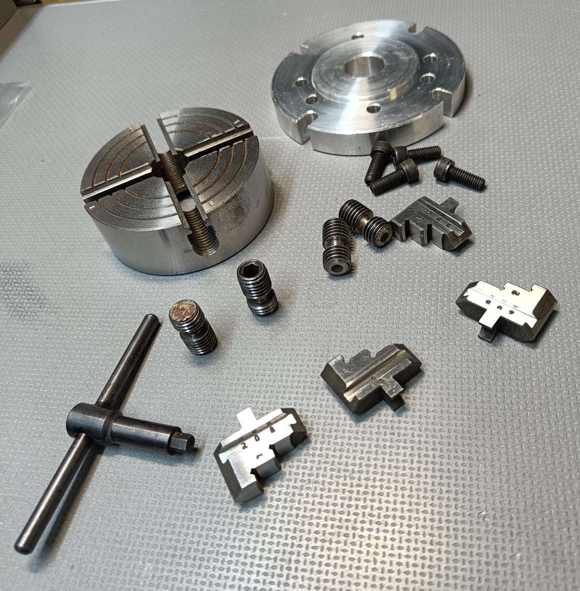

                        I have the chuck now. The quality of the finish is not spectacular but for the price it was expected. It needed to be cleaned thoroughly although there was not too much of grease in it. In fact there is some rust in a few places. Nothing I couldn’t live with. The surprice was that it came with just one set of jaws which are reversible. I contacted the seller and they told that the manufacturer has just recently made the change. I think I would have preferred the 2 sets of jaws but it is what it is. The curvature of the jaws would be opposite when holding a hollow piece from the inside but I suppose it doesn’t matter too much?

                          Why were you expecting two sets of jaws, not usual for a 4-jaw independant chuck surely? Normal for scroll operated. chucks.

                            I expected them because that is what the advert and the pictures said.

                              Though I have a scroll chuck with reversable jaws so one set does all.
