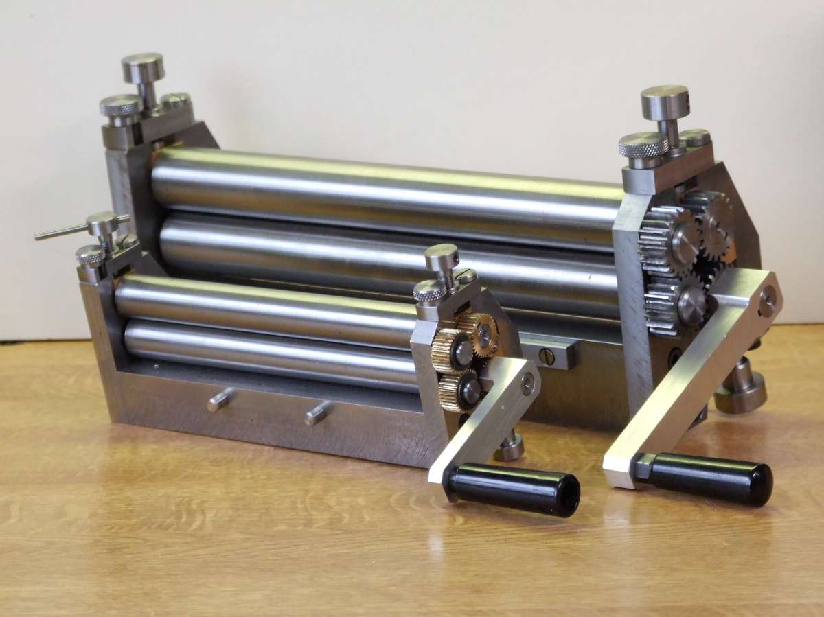

                                          Having two sets of GHT’s Bending Rolls, the maximum pressure is applied at the edges of the sheet being rolled. This effect was shown in the pages of Model Engineer, but not in his book.
                                          Exaggerated the Roll assumes the shape of an Archers bow, top and bottom, it is not so pronounced as the work gets wider.
                                          Regards
                                          Gray,
                                          Fig 1 The bending rolls that triggerd the backstop.
                                          The smaller set is a scaled down set, but I have also built larger ones by doubling the dimensions, including the Roll diameter. The smaller set was for a friend who builds scratch built Locomotives in OO gauge.
                                          You will always get straight portions with a Pyramid roll, see GHT’s Bending Rolls Fig 18.1 in his ME Workshop Manual.

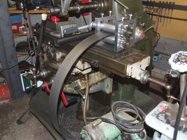

                                                  When I did my calculations I treated the work as a cantilever to get an estimate of the force needed. I didn’t bother with calculating the roll diameter. I used 2-1/2″ diameter rolls, dictated mainly by the gears, as I already had a 5DP 12-13 tooth involute cutter.
                                                  I prefer initial pinch rolls. There is a flat on the starting end, but not on the finish end. So if the work is turned end for end at each pass you end up with a true circle and no flats. Makes the calculations easier and no waste of material.
                                                  For the wheel rims shown I calculated the length of metal needed using pi times diameter and assumed that the bend line would be in the middle of the thickness as the finished work diameter was fairly large. In other words compression and tension forces on the inner and outer edges would be equal and opposite.
                                                  The nominal OD was 14.5″; after rolling and welding the OD came out as ~14.48″. Good enough for me.

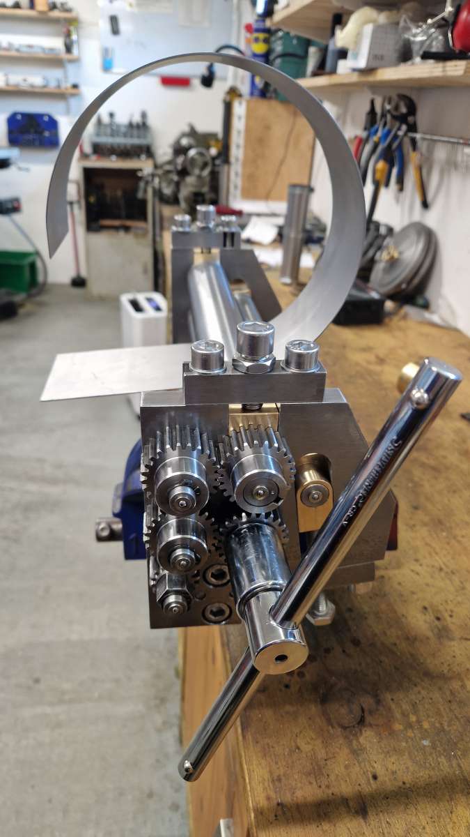

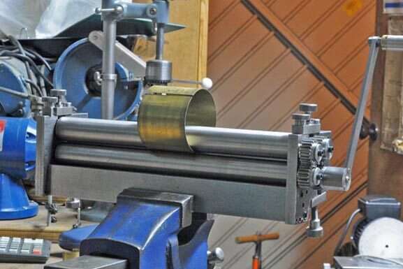

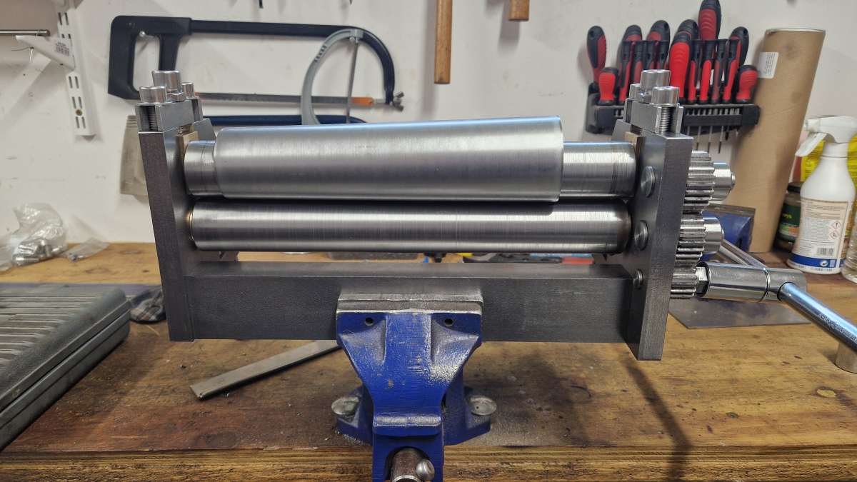

                                                    I decided to make some rolls, based on the GHT design, the pinch rolls are 40mm diameter, pressure roller is 28mm, all 305mm long. I added springs to keep the top pinch rolls spaced apart & button oilers in the end of the shaft with cross-holes to lubricate the rotating parts. I also added a 5th, smaller, gear to gain some mechanical advantage when required with out a longer handle hitting the bench. I used commercial gears, although I could have made them, if I acquired the correct cutters, two of the gears now have a hex on the end to drive them with. The handle is just a socket t-bar, I may make a proper handle, but this does what I want for now. Using a normal bolt on the pressure roller seems OK, if I find it is a pain, I will make something better.

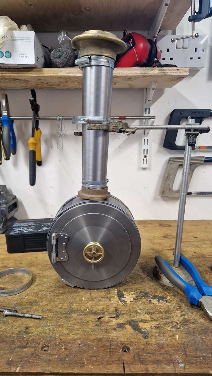

                                                    Here is the smokebox being rolled, 1.2mm mild steel.
                                                    20250614_142839
                                                    The Chimney, 1.2mm mild steel.
                                                    20250614_114506
                                                    And just for fun, the parts sort of assembled.
                                                    20250614_144557
                                                    I won’t be trying the boiler for a while, but at least I can progress with this part of the Foden.

                                                      @bernardtowers37738
                                                      they look really nice, rolls and smokebox.
