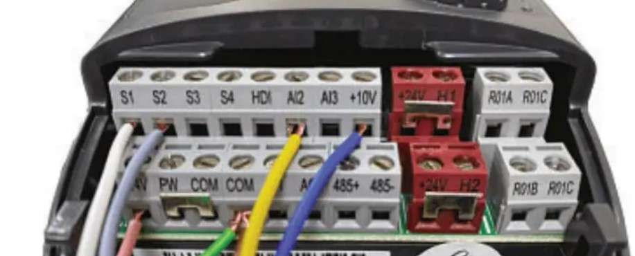

      I’ve Just got around to reading the May issue (351) and the article on setting up a variable speed motor drive. There a couple of issues with this article. First and not a big issue is that it is a pit of an advert for Transwave. I does say it is written by Joe Jordan of Transwave. It would be interesting to know if they were paid for the article or was it sponsered by Transwave.
      More impoertant is the lack of electrical safty information. These VFDs need to be in an enclosure. They are components, not finished products. The end of the article says “only undertake work if you are competent to do so.” This is a bit pointless as a competent person would not need the article…
      Transwave have prominant wording on their website saying “WE MANUFACTURE AND SELL CE MARKED PRODUCTS COMPLIANT WITH EMC REGULATIONS, THE LOW VOLTAGE DIRECTIVE AND BS EN ISO 61000-3-2:2006” One problem with this is that BS 61000-3-2 only deals with current harmonics but at least it applies to domestic installations. The version quoted is out of date, the current version is BS EN IEC 61000-3-2:2019+A2:2024.
      The IMO SD1 VFD featured in the article has a CE mark but it should not have one because it is a component. The only standard mentioned in the manual for the SD1 is EN 61800-3 (no version stated) which is for inverter drives. It has 3 categories (C1-C3) applicable to 240V / 415V equipment. Only C1 is applicable to domestic premises (or commercial with domestic on the same mains feed). Unfortunatly as supplied the SD1 does not meet EMC for any category. You need an optional EMC input filter for C2 or C3. It can’t meet C1 with the IMO optional input filter alone. So the arrangement desctibed in the article is not compliant with the EMC or Low Voltage Directives and is thus illegal.
      And to top it off they have a picture of really poorly made off control wiring at the termnal blocks. There should not be that much copper exposed.
      VFD terminals
      IIt really makes you wonder what they are thinking….

        Hi, pretty poor example of connecting  wires to terminal blocks, and the Com one with the green and other wire in, is very bad. You wouldn’t think a well known outlet would show such poor workmanship.
        Regards Nick.

                  Well I thought it was a useful article for anyone wanting to set up a drive. It showed what you got for your money, demonstrated it wasn’t that difficult and  showed that clear instructions were supplied. That and a brief overview of form and function covered all the bases. Quite honestly who cares who paid for it. There are many posts on here from people asking how to set drives up and the article answers many of their questions. Transwave regularly advertise in the magazine so nice to hear from one of their staff.
                  I agree that the control wiring was a little untidy and not as neat as I would expect of myself but wasn’t in itself hazardous.

                        Requirements for isolator (could be an IEC C13/14 inlet on enclosure), fuses, earthing, cable type and sizing, strain reliefs/glands, EMC filters and most importantly an enclosure.
                        They mention a 4 core cable for the motor and a possible earth terminal but no guidance how to connect it. For a start ring tags should be used on the connections.
                        On the poorly stripped fitted control wires, as these are part of the supplied control pendant it is surprising that it is not supplied with bootlace ferrules already installed. They are not hard to find, even Lidl have them.
                        Robert.
