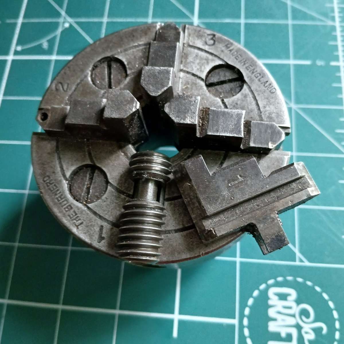

          My immediate thought is that the Soba jaws have only one small lug which the screw bears on to move the jaws in and out, I’m thinking that is a weakness.
          Tony
                Tony
                Hi Tony, can’t see any real problem, here’s a photo of my fathers 4 jaw, which is older than I am, and I’ve used this very many times, let alone the number of times my father must have used it. This is a 3 – 1/4″ one.
                20250607_084126
                Regards Nick.

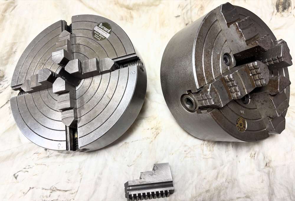

                                    Hafta disagree with Dave (SoD) about the desirability of standard 4 jaw chucks compared to light duty (aka low profile) ones.
                                    Most especially when it comes to small ones for model engineering the larger jaws used on standard chucks are far too cumbersome when holding small components. Comparing the advert pictures doesn’t really give a decent comparison of relative sizes. Typically light duty chuck body depth, jaw lengths and jaw widths are around 2/3 rd that of standard 4 jaws.
                                    This picture shows the 8 inch (200 mm) light duty and standard duty four jaws I have for my Smart & Brown 1024. Although over twice the size of the 80 mm ones being discussed the relative proportions between the two types are similar. The loose jaw is one from the standard fit 6 inch (150 mm) three jaw. As can be seen the light duty chuck jaws are of very similar size to the standard fit 3 jaw. Which is generally about right when it comes to holding more precise work.
                                    4 jaw chucks
                                    Standard 4 jaws are sized for getting a firm grip on awkward, often hefty and ill finished components for industrial rates of metal removal, often with interrupted cuts, where you really don’t want the job making a bid for freedom. Not so good at the precision setting thing.
                                    I may have used the standard duty 4 jaw twice in 20 years!
