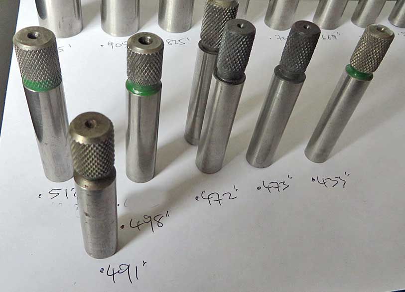

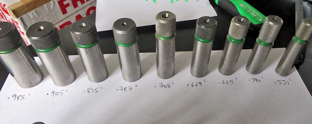

      Hi All,
      This weekends car boot haul included a large selection of these plug gauges, all in very good condition but with very strange diameters.
      I was expecting to see the normal .125, 250, 500 etc sizes but there are very few of those.
      Are these for special applications of some sort?
      There are many more smaller sizes as yet un-measured!
      Cheers, Martin

          .531 and .625 are imperial fractional sizes and most others will give metric sizes if you measure with metric tools.
          .985 = 25mm
          0.905 = 18mm
          etc
          Edited By JasonB on 03/05/2021 16:04:33

            Don't rely on gauges being standard sizes, in production environment gauges are made to suit the process. Gauges are made to suit pre finish sizes, say for a drilled hole prior to finishing where the hole is a non rounded size.

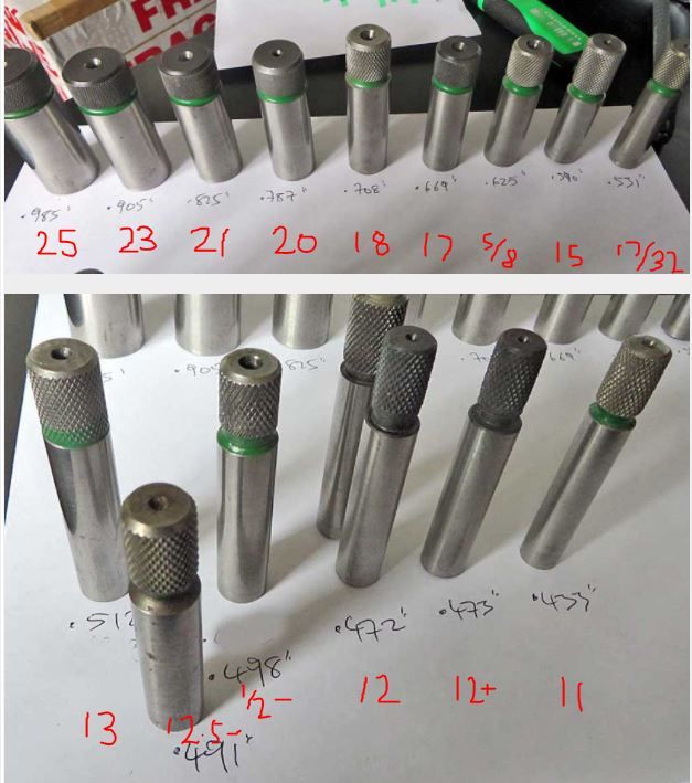

                    Yes a typo will correct it.
                    What did you measure with? as 3 decimal places may not be accurate enough as the difference between exact metric and just under is a couple of tenths.
                    There are hardly any "odd sizes" if you convert them, just a mix of whole mm and 32nd imperial.
