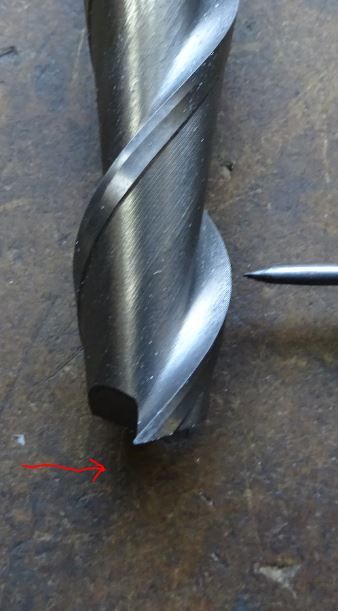

                            #334241
                              Posted by Andrew Johnston on 28/12/2017 12:59:31:
                              Posted by Peter Wood 5 on 28/12/2017 08:50:41:
                              Apparently a conventional spiral fluted slot drill produces a slightly v shaped slot as the spiral pulls the tool sideways, removing a bit more metal near the top of the slot
                              I don't see how that works? In theory a two flute cutter has balanced cutting forces across the widrh of the slot, so it shouldn't deflect. Axially the cutting forces will be unbalanced, but that doesn't affect the width.
                              I have always assumed that cutter deflection is essentially that of a cantilever, ie, deflection is greatest at the tip and reduces to zero at the holder. To cut a slot wider at the top implies that the tip doesn't deflect, but a midpoint of the cutter does, seems a bit odd?
                              Andrew
                              If the slot were a certain depth there is the possibility that the top of the slot could become wider even though the deflection is greater at the very end of the cutter.
                              Imagine that the cutter in the photo below were cutting towards you, as the corner of the leading flute gets to the ctr of the slot it will be removing the most metal and could deflect in the direction of the red arrow. This would cause the tool to move to the right as viewed but due to the helix angle the slot won't become wider at the bottom as there is noo cutting edge in contact but further up where the scriber point is the cutting edge would possible cut into the side of the slot thus making the top wider than the bottom.
                              #334245
                              Bazyle
                                @bazyle
                                I agree with Jason. Ignore my earlier post I had the spiral in reverse for some brain fade reason.
                                #334311
                                Anonymous
                                  Posted by JasonB on 28/12/2017 16:55:31:
                                  That makes sense, thanks. Intuitively I'd expect the effect to be dependent upon the depth of the slot and the helix angle. The Dormer slot drills I use have a helix angle somewhat less than the cutter illustrated. So I guess for normal depth slots the effect will be less.
                                  From a practical point of view I can't say I've noticed the effect when measuring slot widths with slip gauges. I wouldn't be surprised if the keyways on the original SCC Burrell traction engines were cut with a hammer and chisel. So I'm not going to lose any sleep worrying about variable width slots on my models. wink 2
