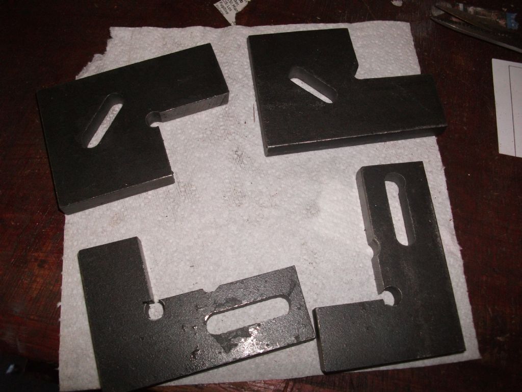

                                  You can do this if you wish ,i use these plate pieces to surround a job
                                  clamped to the mill table ,they are nothing special just rough cut, mill clamping.jpg used with the normal clamping methods will hold a job securely in
                                  place.
                                  The part in the previous photo had bolt holes on the underside to fix to
                                  the pair of angle plates.As this part was eventually ground on all four sides
                                  it needed to be made and held in this way.

                                    Thank you John, I was thinking of using 4 x anti slip stops, don't recall seeing corner pieces like yours before except for woodworking…seems like a great idea!
                                    Do you consider the x4 you show an ideal set, ie with x2 straight slots & x2 at 45*?
                                    Would you still use paper between, or not necessary?
                                    Chris.

                                      Just make them to suit what you are doing ,paper in between the work and the table can be useful to protect an already finished surface.
