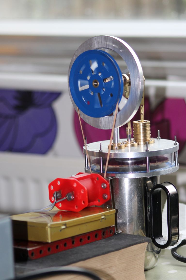

          Have a look at Jan Ridders website. Although it comes up in Dutch it also has good English translations one click away. Quite a variety of Stirlings and other engines, some have been published in Model Engineer and elsewhere.
          Jan's engines all have a positive reputation. I built his 'KoffieKop' Coffee Cup engine successfully and can confirm the plans are correct and the engine runs. Works better on an Insulated Travel Coffee Mug full of recently boiled water than an ordinary coffee mug at normal coffee temperature.
          The picture doesn't show a Stirling driving a Meccano motor as a dynamo! Other way round: I did various experiments measuring the CoffeeCup's power output and this set up was used to measure the Stirling engines internal mechanical friction by driving it with the motor. It's also useful for 'running in' – smoothing rough bits & fine tuning by turning the engine over a few hundred times before attempting to run it as prime mover.
          One tip; I initially fitted dirt cheap ball bearings and followed advice about removing their seals to reduce friction. Worked much better for me when I bought better bearings and left the seals in place.

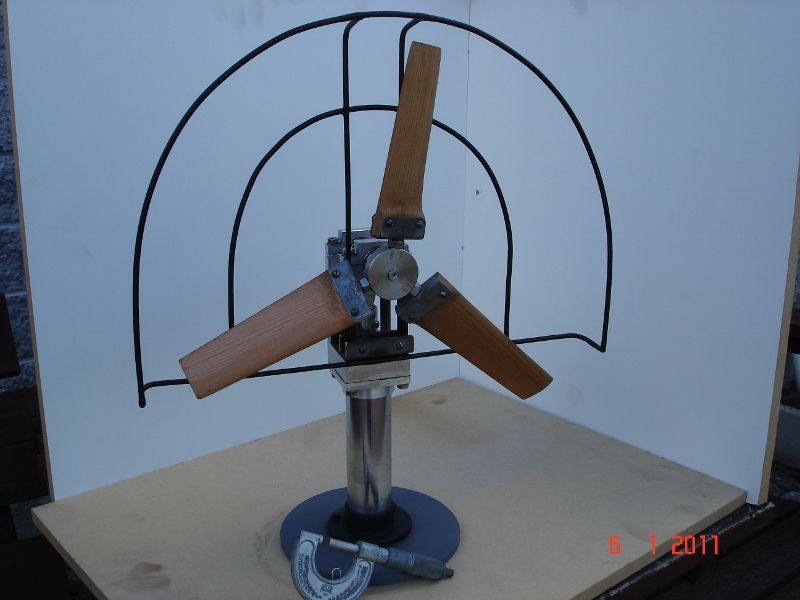

            Sorry I don't build to plans, but I do have a couple of James G. Rizzo's books, bet to get hold of his "The Stirling Engine Manual" vol 1, and if you take up Stirling Engines try and get vol 2. It is also worth down loading Andy Ross,s book "Making Stirling Engines"(free down load), no plans in this book, but plenty of information.
            First a stove top fan, 30 mm bore, 20 mm stroke power cylinder.
            Second, a little beam engine 3/8" bore, 1/2" stroke power cylinder, the hot cap is the steel casing of a AA size Nicad battery.
            There is about a dozen more motors, you just need to have the correct dimensions and ratios, and a bit of imagination.
            Go for it, and good luck, don't be afraid to ask questions.

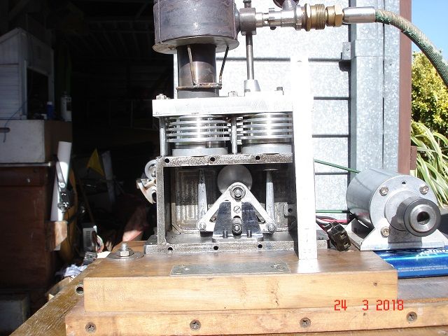

                #417445
                Ian S C
                  @iansc
                  Ross Yoke ALPHA motordsc01351.jpgThe stainless hot cap is not for good looks as SOD says. Some times you can get cans the right size. mut first few motors the hot end was mad by boring out bars of stainless, mostly 316, there was miles pf razor sharp swarf, but one of those motors is still ok 29 years on. For small motors, the steel (?stainless) case of old Nicad batteries works ok they range in size from AAA to D, and there are other ones in old tool power packs. You can use alkaline battery cases, but the + bump is on the bottom. The cold 1/2 of the displacer cylinder can be made of aluminium, or if you use water cooling steel works well, you can solder a jacket around the water space.
                  The photos are out of order, top as it is now, bottom as built with water cooling, my Ross Yoke ALPHA motor, unpressurised 5 Watt motor, 35 mm bores, and 22 mm stroke. It takes about 20 minutes to cut a bit of 10 mm rebar
                  Ian S C
                  Ross Yoke motor
