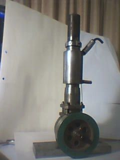

              Here's my version of Dyna, designed by James G. Rizzo, it was built in 1994, and has been run for over 1000 hours. The power cylinder is made from a bit of water pipe bored out to 1 3/4", and has a cast iron piston, it drives a generator made from a small DC motor, this runs a radio, and a small computer fan on the radiator, or the generator can be removed, and a small power hacksaw fitted(junior hacksaw blade). Ian S Ctest 005 (640x480).jpg
