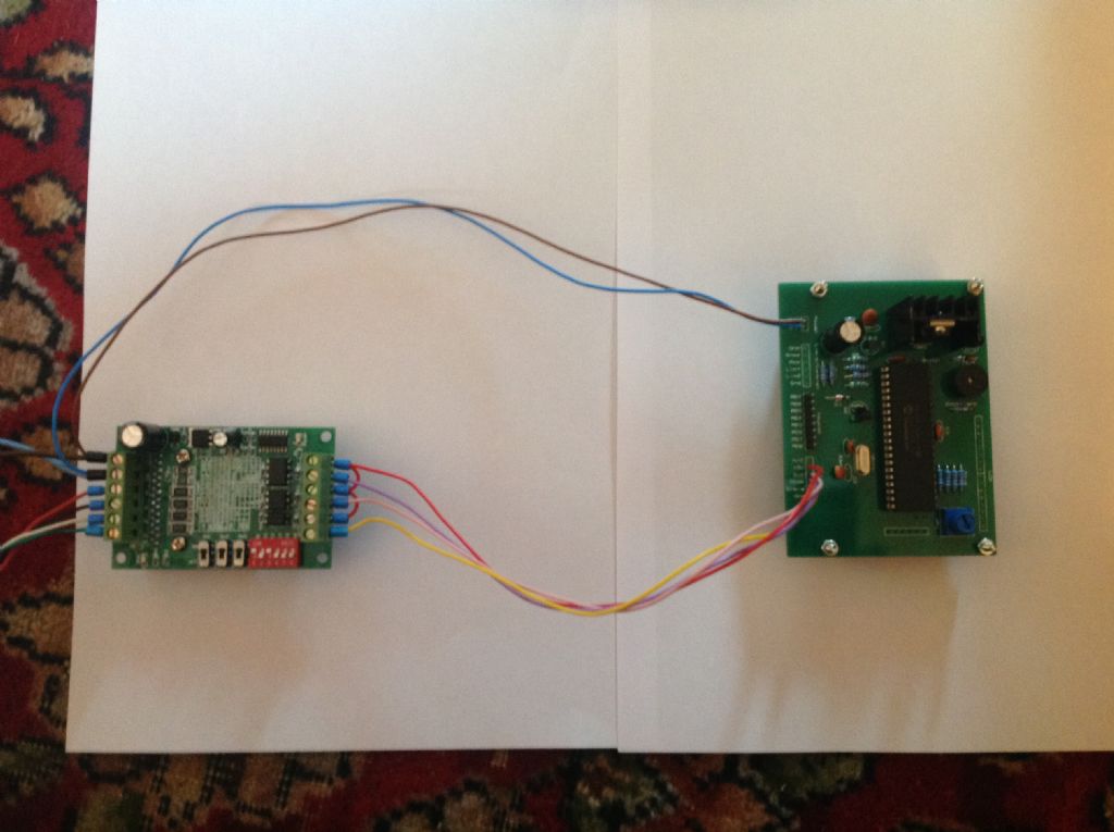

      Has anyone successfully built this unit ?
      I'm struggling to get it working,mainly because I don't understand electronics.
      When I put 5v onto the circuit board,the display lights up but no figures appear.
      When I put 24v into the driver nothing happens?
      I would appreciate some pictures if anyone has any to show where the connections go,and where from.
      Hope someone can help.
      Thanks, John

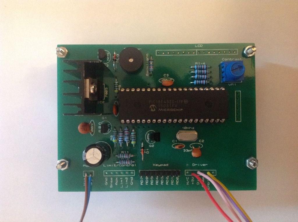

                Posted by john kennedy 1 on 22/06/2016 15:50:10:
                Thanks, John
                I cant remember if there is a contrast pot for the lcd, if there is, have you tried adjusting it?
                I just checked….there is, so try adjusting it..
                Otherwise its back to basics, all components inserted in correct location and the right way round,……
                No short circuits/bridges stray solder splashes across any adjacent tracks……
                Mine worked fine after assembly.

                  ianj
                    @ians
                    John.
                    The 5v connection is to output 5v to the stepper driver if required. It's NOT for 5v in.
                    The in voltage of 24 v connection are to the left of the PCB as viewed with the terminal blocks along the bottom, this is regulated/dropped to 5v for the 5v output as mentioned above, & microcontroller power ..
                    You say when you put 24v into the driver nothing happens do you mean the stepper motor driver or the Steve Ward controller?
                    Have you programmed the microcontroller?
                    Are you using the latest PCB as purchased from Steve.
                    Maybe a photo of your 's would be helpfull.
                    Ian

                    Gray62
                      @gray62
                      John, if you are using 5v to power the board, you should omit the on board regulator. and connect the power to the 5v connection not the power connections that feed the regulator If you are feeding 5v into the regulator, the microcontroller will not power up correctly as the output of the regulator wil be less than 5V the ones I have built are all powered from a 24V supply but you must have a decent heatsink on the regulator as it can get quite warm, I also fan cool the enclosure with a small 5v fan.
                      Did you purchase the PIC pre-programmed from Steve or have you programmed your own?

                        Ian, I think we're getting somewhere. I put 5v in that bottom left terminal block.
                        I'll try 24v
                        I have got the latest board from Steve about a year ago.
                        The chip came ready programmed.

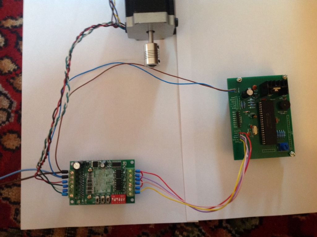

                          image.jpegimage.jpegimage.jpegHi John,
                          I have put this together for testing and it is working, just waiting to be boxed up,keypad not shown plugged in. I have a 24v supply on the brown and blue wires.image.jpeg

                            Put 24v to the bottom left terminal and Success. The display read as it should and I went through the menu.
                            I have a Microstep driver M5045
                            **LINK**
                            On the terminal blocks to the left it shows High voltage DC in and DC earth.
                            Does this also need a 24v link to run the stepper motor.

                              Michael, just seen your post.Very helpful. My driver is different to yours but I'm sure we're nearly there.
                              Just noticed on your photos that 24v is linked to your driver.

                              Gray62
                                @gray62
                                John,
                                Yes you will also need to provide a power supply to the stepper driver, the outputs from the controller board are only the 5v TTL logic to drive step and direction

                                  Fantastic.Thanks chaps for all your help. Linked up the driver and away it went.
                                  Set it to jog 10 degrees. Nearly jumped out my skin when it went.
                                  Can perhaps cut some clock wheels now.
