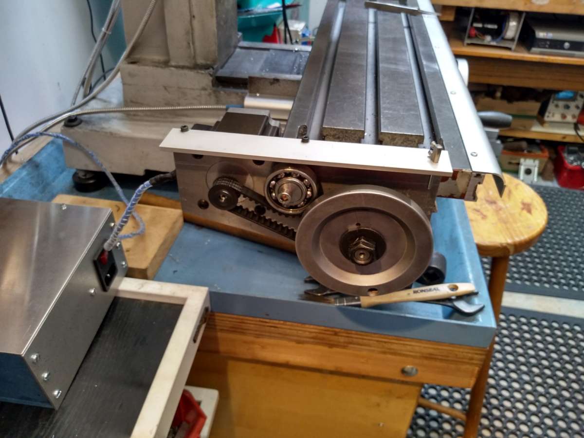

      Hi, all.
      I have built a mill power drive with a stepper motor and Arduino.  It works.  Sort of.
      The problem is that it struggles towards the ends of travel of the mill table, particularly to start off (in fact it won’t start and won’t move – I have to add some human torque).  The mill is a VM32L with table 840mm long.  So quite heavy and easy to see how it needs a bit more effort at the ends.
      The motor is an ACT motor 23HS2442J3 (about 1Nm torque – dropping with speed, of course) and the driver is TB6600 set to 4.2A.
      However, the power supply is a 24V supply, but I have read that a higher voltage is better to push the amps through the coils.
      I was wondering if swapping out the PSU for a 40V one would make enough difference to be worth while.  My guess is that it would need 1.5 to 2x the torque to work well at the ends.
      Also, I think I have the microstepping set to 8 – should I drop that down?  I seem to recall from early trials that the movement is noticeably less smooth.
      My suspicion is that the extra voltage won’t get me where I want to be, but would appreciate some input from those who may know.
      Many thanks
      Iain

        I use a somewhat smaller motor on my VMB mill power feed driven from a DRV8825 driver on 24V.  It also complains at one end of table travel because the table friction increases, but the coil current is something like 1A or less.  Some adjustment of the gibs might help?
        Do you have any mechanical reduction to the feed screw?  I have a 2:1 timing IMG_20200718_174914405_HDRbelt drive.

                        The power feed will run at up to about 12mm / second through 70% of the mill travel. the speed which it will start it drops off markedly near the ends of the beds.  the acceleration is currently set lower than I would like – it takes a few mm to get up to even a lowish speed.
                        I’ve got it connected to the leadscrew with  a 1:1 ratio (timing belt).  I don’t really want to use 2:1 as it will reduce the top speed of the traverse and that is half the reason for installing it!

                                    Thanks Dave – all of that made sense.  My PSU is switched mode (pretty much all of the conversions seem to use these).
                                    I’ve ordered a 36V 5A one from china.  You can apparently get a bare bones (no case) one for about 7 quid, but it takes longer to arrive, so I splashed out.
                                    What I will try and do is to get a 20T timing pulley to run at 2:1 and drop the microstepping.  See how that all goes.
                                    this will take some time, both for parts to arrive and me to find the odd day when it’s warm enough to get out to the shed and do things (today is about 8 degrees and that’s just a little too cold for me!).
