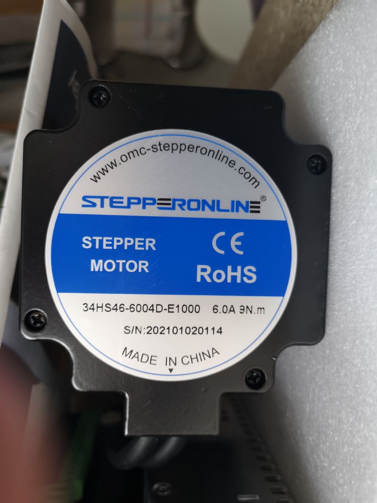

                            Terry Kirkup
                              @terrykirkup37827
                              I have a question that is potentially daft but I'd still like an answer to, just in case. Does anyone know for sure whether or not the little arrow at the bottom of this label means this is its correct orientation? And as an aside, I think I bought a tractor, this thing is a MONSTER just to drive my WM18B X-axis drive, I could hardly pick it up! I reckon you are spot on Muzzer!
                              #553426
                              John Haine
                                @johnhaine32865
                                There is no correct orientation. It's probably just decoration.
