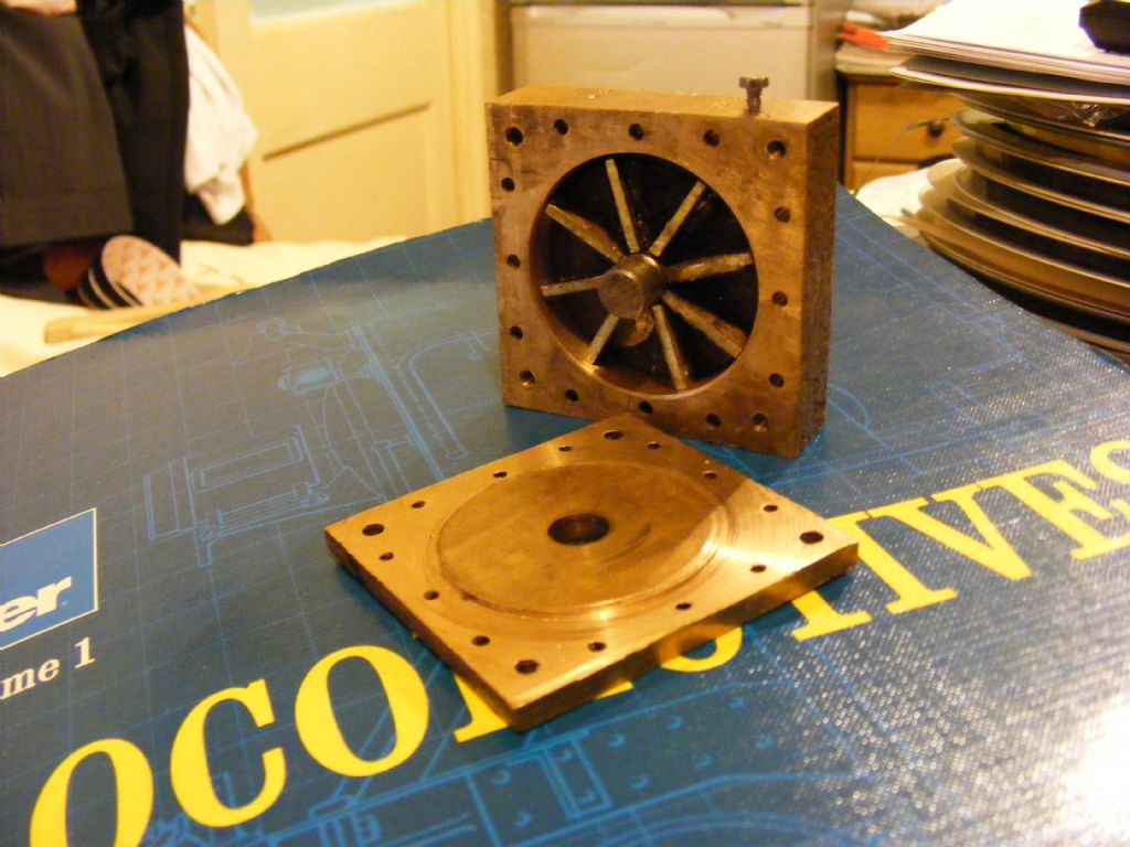

                                                    Stephen Rowley
                                                      @stephenrowley13300
                                                      Hi
                                                      I made this small
                                                      turbine some years ago. With 25psi it will produce 10000 rpm.
                                                      I had a hell of a job
                                                      trying to balance it enough so I did not have to screw it to the
                                                      bench.
                                                      The turbine it’s self
                                                      is 1.3/4” in diameter and has 8 blades.
                                                      It was made as an
                                                      experiment to drive a locomotive throw a gear box which it did quite
                                                      well but the gear box was far to big as I needed to get 10000 rpm
                                                      down to 60 rpm.
                                                      I have just tried it
                                                      driving a small DC motor that I got from the local model shop for
                                                      £6.50. it has an out put of 12v @ 3 amps @ 1000 rpm.
                                                      I connected then
                                                      together with a bit of plastic tube and put my meter across the out
                                                      put of the motor and apart from the noise it went well and lit a car
                                                      head lamp bulb until the plastic tube broke. I will pick the bits of
                                                      the tub out of the roof later.
                                                      James.
