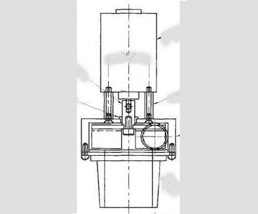

          What sort of flue temperatures would you expect a fan to work at (choice of fan case and bearing materials) ?
          #497787
          Paul Lousick
            @paullousick59116
            The temperature that the fan can reach depends on how long you leave it on the chimney. I start my fire with kindling and then add coal/charcoal and remove the blower after the coal is burning on its own. The blower is hot and and has to be handled with gloved hands.
            Because of the heat, the case and fan should be made from metal and the motor and bearings should be separated from the hot flue gasses

                Peter Bell
                  @peterbell11509
                  Thanks everyone, wealth of information! As I have no experience of these fans I have been drawing up the design put together by Brian Baker with view to cnc'n the parts and building one.
                  Thanks for the info on gas boiler exhaust fans, just realised I know someone who services has boilers for a living, he's bound to have something….
                  The fans on the boiler exhaust fans look rather small and curved, don't they soot up easier than the straight blades?
                  Peter
