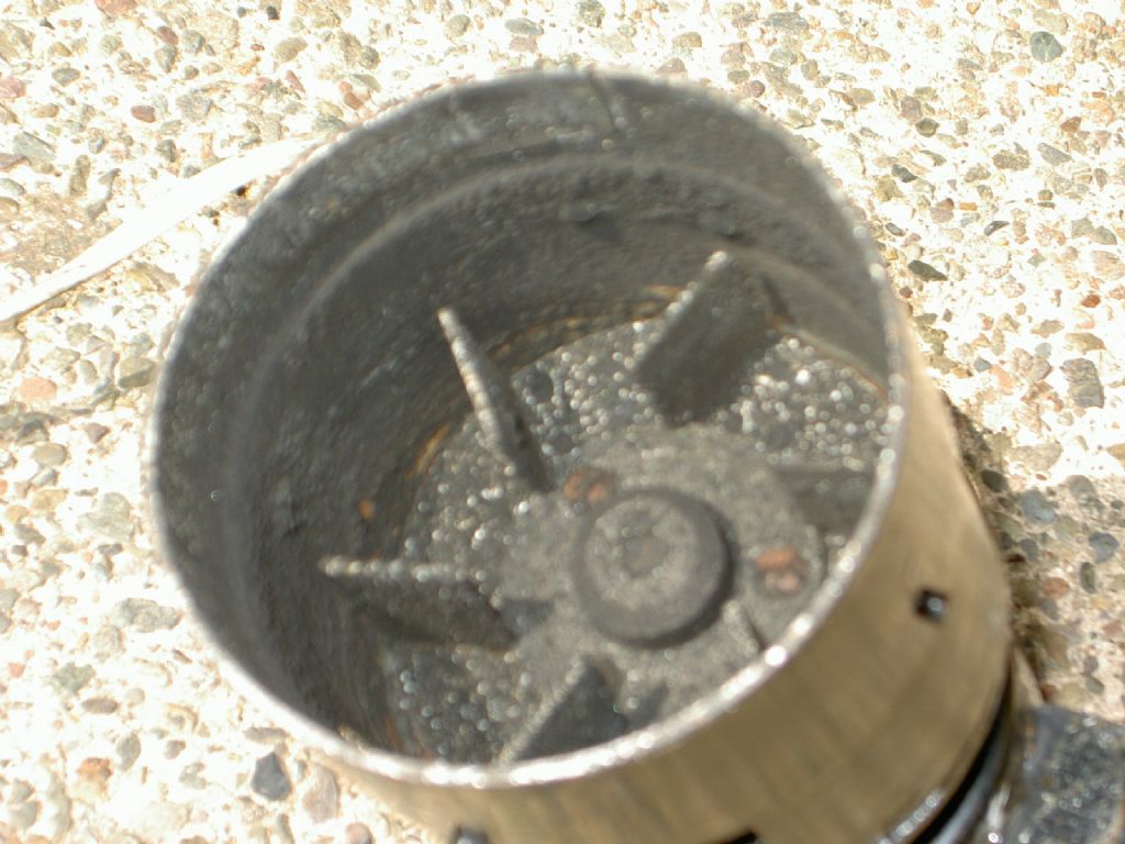

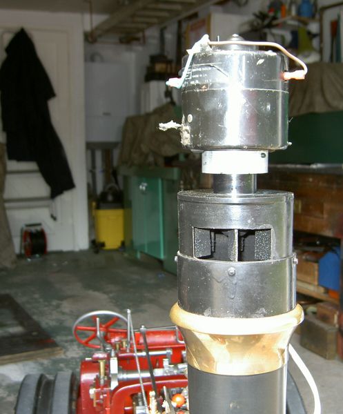

        MichaelR
          @michaelr
          Hello Peter, My steam raising fan is nothing fancy, the blades are straight each blade is riveted to a disc attached to the motor
          fan.jpg Michael
