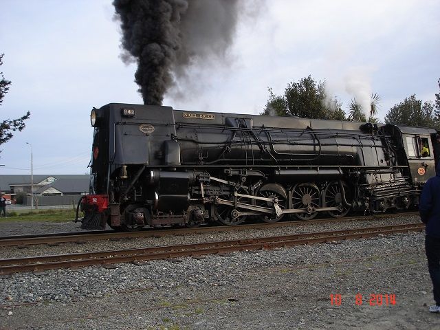

                Ian S C
                  @iansc
                  It's easier to use straight lengths, and bend them, rather than trying to get the coiled tube straight, curves where it should be straight look awful, you would find out about pipe work if you modeled an NZR locomotive, all the pipe work exposed all over the boiler.
