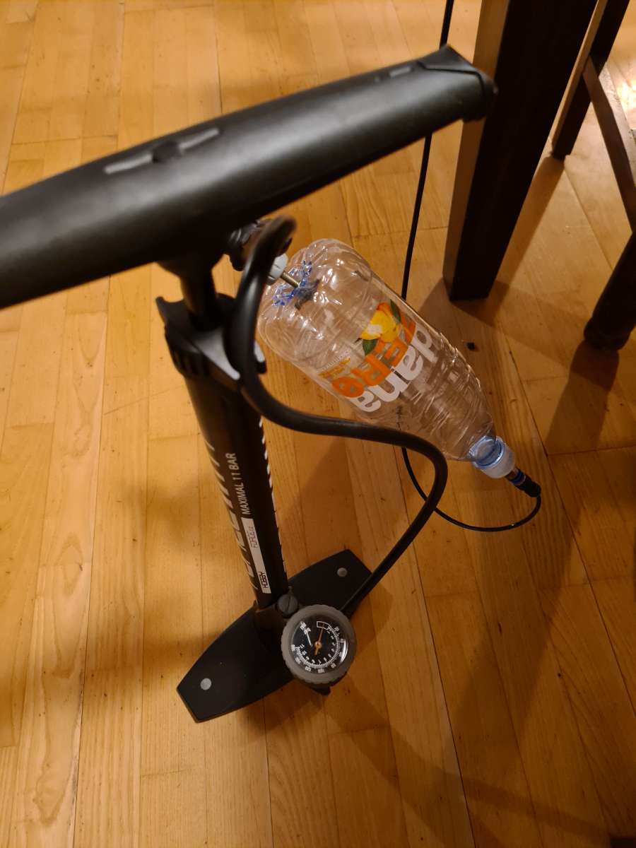

        My air setup:
        20240224_193939
        On these 2 links are new tests with air:
        Stall pressure:
        https://files.fm/u/52mf4tunb7
        Max RPM:
        https://files.fm/u/e6wk6kjva9
        Martin
