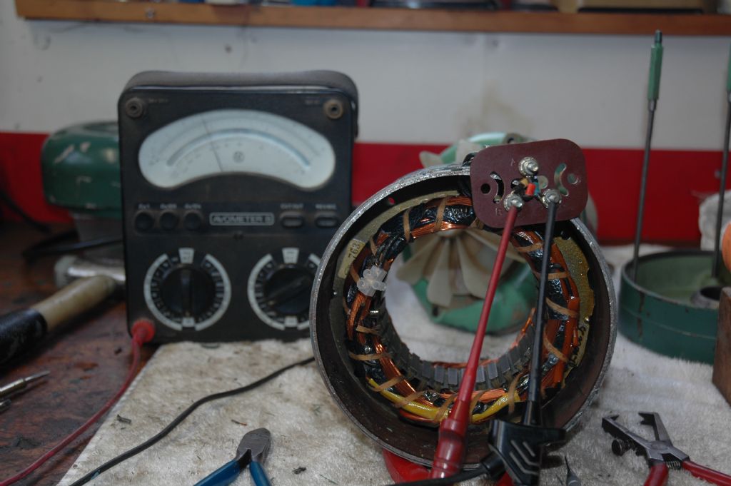

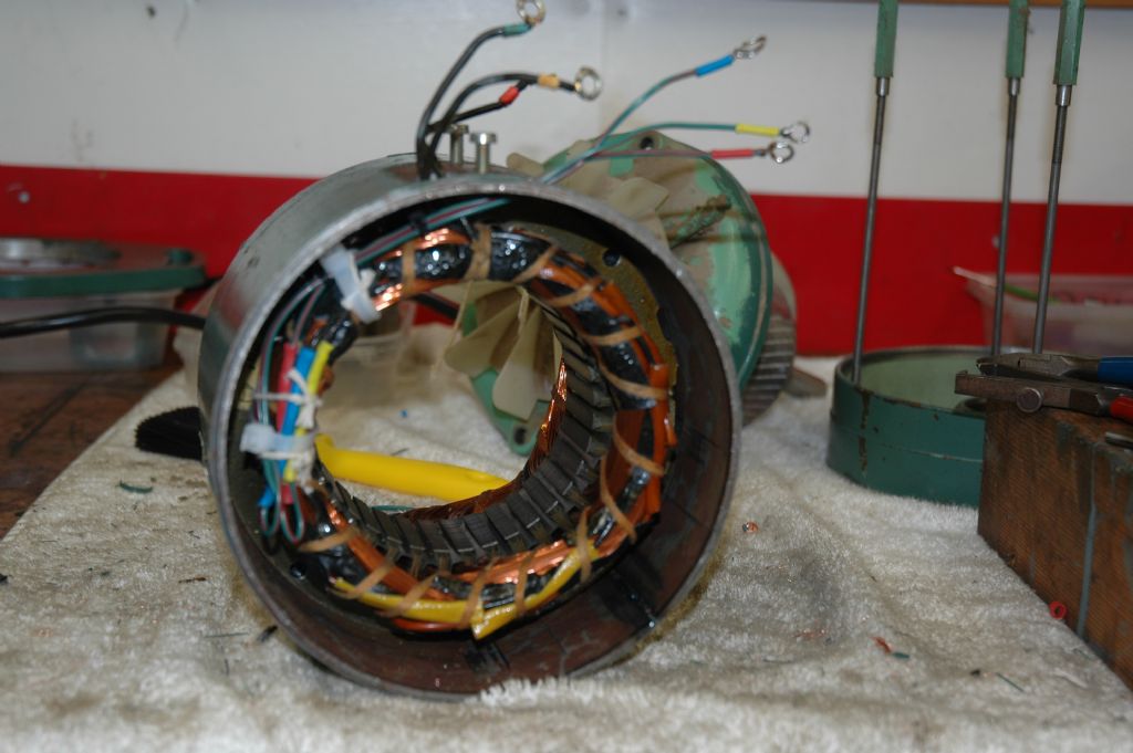

      Hi all, I'm trying to rewire a "new" three phase motor from Star to Delta. to enable me to run it from an inverter. I have stripped down the motor and found what I believe to be the star point. Prior to cutting the the conductors at the star point I measured the winding resistances from the three terminals in the junction box. There was approx 44 Ohmes between an two of the three terminals. After cutting the conductors at the star point I attempted to measure the resistance between the cut tails and the connections in the junction box. There was no resistance to be measured, is that correct ?

            No! The first measurement indicates that each winding resistance is 66 ohms, so that is what you should see in the second measurement assuming that you connect your meter to one terminal and to the "tail" of the winding to which it is connected.

                  Emgee I have tried the above. Connected my meter to all terminals in the junction box and all individual cut tails in the motor. No resistance measured. Reconnected the three tails together then get the 44 Ohms between any two terminals in the junction box ???

                      The tails are totally clean but I cannot detect any resistance from any individual winding ?

                        The way I read the original post the 44 ohms was between any two terminals with the motor in star. Given that the star point is buried it presumably doesn't appear at a terminal. Therefore the 44 ohms is measured across two windings in series. So each winding should be 22 ohms.

                                A reading of 44 ohms between any two terminals in the connector box of a star connected motor means each winding is 22 ohms. If the motor was in delta then the 44 ohms reading would be from a coil resistance of just under 30 ohms due to 2 in parallel and one in series being 15 + 30 roughly. Since the aim is to change from star to delta this means the coils are 22 ohms.

                                      Peter, does the picture show the star connection point or the tails to windings connections ?
                                      Emgee
                                      #437404
                                      Peter Simpson 1
                                        @petersimpson1
                                        The chocolate block is where all three conductors were joined together, I assumed this must be the star point ? Would there be another point in the motor were all three conductors where joined ?

                                              Did further checks this afternoon, found the conductors at the star point looked clean and free of insulation but must have had a thin coating of varnish on them. Used some fine wet and dry to totally clean the copper conductors. I was then capable to measure the individual resistances. Three new wires soldered, heat shrunk and routed to the terminal chamber……..Too long off the tools !
