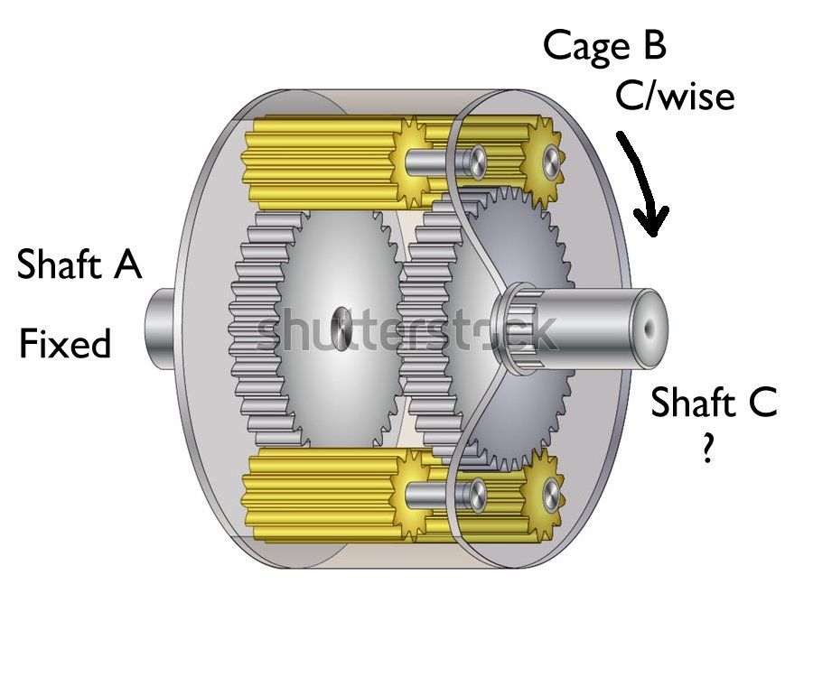

      A bit of help needed.
      Here is a picture of a spur gear differential I nicked off the 'net.
      My question is, if shaft A is held stationary and cage B is rotated clockwise, which direction would shaft C move?
      Logic and intuition tell me clockwise but I may be missing something!
      Cheers
      Steve

        ChrisLH
          @chrislh
          Logic and intuition win through! Shaft C will rotate in the same direction as Cage B (i.e. clockwise in this case) but at twice Cage B's speed.

          Martin Connelly
            @martinconnelly55370
            The second shaft will go clockwise. It is easier to consider the case where the cage is stationary first and what is labelled as fixed goes anti-clockwise at rpm X. Then you will see that shaft C goes clockwise. In order to then see the case where the first shaft is fixed everything else has to go clockwise at whatever rpm X you imagined the fixed shaft to be going in the first case plus what it was doing in the first case. So the cage is rpm X plus zero clockwise and the output is clockwise amount plus rpm X.

            Steve Crow
              @stevecrow46066
              Thank you Chris but I don't understand why the rpm is doubled.
              #569134
              Pete Rimmer
                @peterimmer30576
                Posted by Steve Crow on 31/10/2021 15:33:40:
                In a differential whatever speed one side is slowed by is added to the opposite side.

                Steve Crow
                  @stevecrow46066
                  Thanks for you help. I am ok with a bevel diff, (here's one I made earlier – **LINK**), I'm just finding it hard to get my head around the spur gear type. It's the fact that there are two gears counter rotating transmitting the power rather than a single bevel gear.
                  Using the picture above. If cage B is fixed and shaft A is rotated once clockwise, I presume shaft C will rotate once anti-clockwise, the same as a bevel diff?
                  If so, would putting an idler gear between the two small pinions reverse that?
                  Cheers
                  Steve

                  Peter Cook 6
                    @petercook6
                    Posted by Steve Crow on 07/11/2021 10:46:18:
                    If I understand it, the two pairs of "contra rotating" pinions are not actually in mesh. The two meshing with the shaft A gears drive the cage round. The two meshing with the shaft B gear are driven by the cage and drive shaft B.
                    Presumably you could add more pairs at right angles if you wanted to transmit more torque.

                    Steve Crow
                      @stevecrow46066
                      Hi Peter, this animation shows the pinions in mesh. **LINK**.
