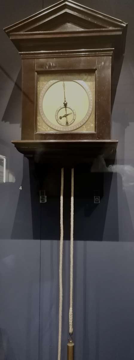

      My brother has unknowingly presented me with another mystery !
      They are visiting St Andrews, and he thought I might be interested in the little wall clock that they have in the museum … It was purchased from Joseph Knibb, by James Gregory.
      My ‘research’ so far identifies this as a split-seconds timer, but I can find no real technical detail about it.
      I know [conceptually, at least] how split-seconds Chronograph watches work … but can anyone please explain what Knibb contrived to perform this magic in an early wall clock ?
      This snapshot, taken  through the display case, tells us very little … and the one published by St Andrews may be worse !

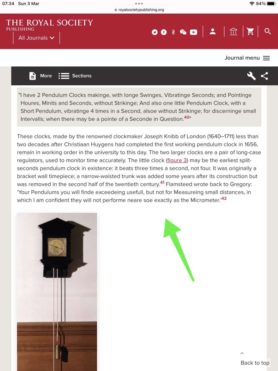

              Note: __ The Royal Society document that I linked yesterday explicitly contradicts the other quotation:
              IMG_9397
              Note: This is from the web-version, but the document is also freely downloadable as PDF
              Confused … Moi ? [as Miss Piggy might have put it]

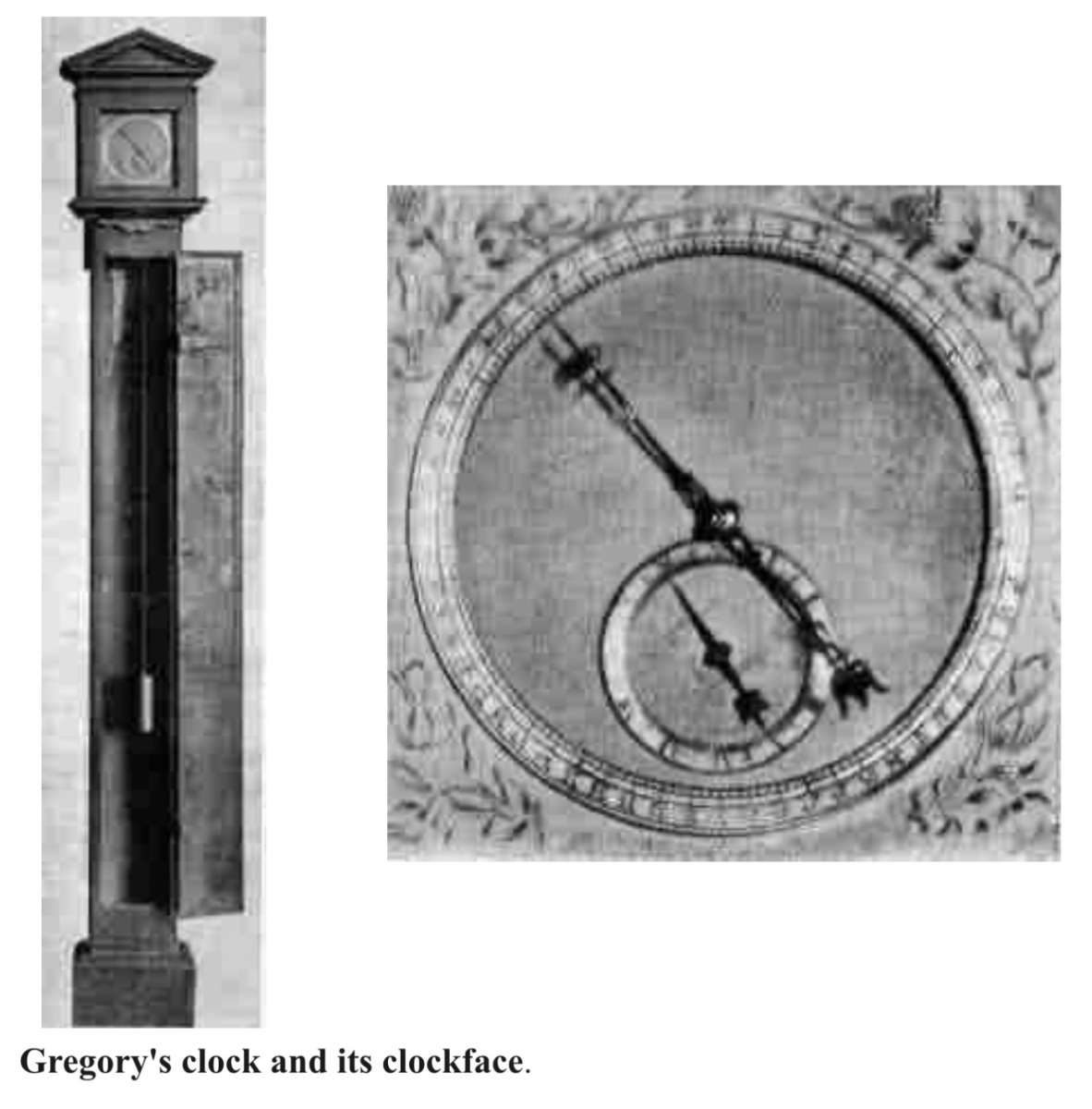

                              This is the most tantalising image:
                              IMG_9398
                              … but the jpeg artefacts mask the detail 🙁
                              I am guessing it comes from
                              H W Turnbull, James Gregory Tercentenary Memorial Volume (London, 1939).
                              as referenced in:
                              https://mathshistory.st-andrews.ac.uk/HistTopics/U_of_St_Andrews_History/

                                Thank you Michael for finding that site. Some beautiful animations to sit are watch – an excellent way to kill an afternoon!
                                I think that dial and motion is definitely taken from the St Andrews clock – or an identical one. Watching the animation full screen – and it does seem to be real time – I think I could, with a bit of practice, time an event to within one third of a second.
                                I am still unsure about the  method of communication however. I still think the observer would identify the “mark” while the assistant got the time. Most people speak at up to 200 words/minute. With one word per tick of the clock you could achieve one third of a second. However once past twenty you start to need two words per tick and that would slow things down!

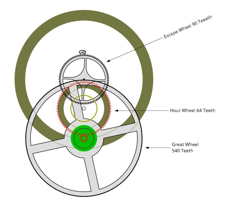

                                    Michael, if you ever find out from the University how it works, please let us know.  You set me a puzzle.
                                    Scaling from the pictures and animation, it is possible to deduce certain factors. The drop of the weights looks like about 60″ and the two ropes are about 1″ apart, so a great wheel drum (turning anticlockwise) one every 90 minutes would give about 30 hours running – which gels with the once per 24 hour wind.
                                    If the great wheel rotates once per 90 minutes, then the minute wheel need gearing up 1:90, and the hour wheel gearing down 8:1. The only way I can see to do that in a three wheel clock would be to have a very high tooth count great wheel driving the minute arbour, and have a second pinion on the great wheel arbour driving the hour hand. All three wheel arbours are in a vertical line.
                                    One possibility is
                                    Train Annotated
                                    The Great wheel is 540 teeth (about Mod 0.2) driving a six tooth pinion on the escape arbour.
                                    An 8 tooth pinion also on great wheel arbour drives a 64 tooth wheel (Mod 0.8) on the hour wheel (in red).
                                    The escape wheel has 90 teeth.
                                    The dark green circles are the positions of the main dial chapter ring and subsidiary dial, for positioning (taken from the animation), and the bright green disc is the great wheel drum.
                                    It would be a great project – although that great wheel could be a nightmare to cut.
                                    I hope this was interesting. Do let us know how Knibb did it if you ever find out.
                                    PS apologies that the gears are involute – hat is the only kind my CAD program can draw

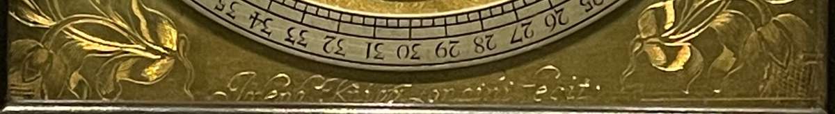

                                      A prompt [and as-helpful-as-she-could-manage] reply came from Natasha at the Museum … but frankly we are not much further forward.
                                      [ I will send you a Personal Message shortly ]
                                      What she did kindly include was a considerably better photograph of the dial, a small crop from which I am including here:
                                      image_67192577
                                      I was quite astonished by the elegant simplicity of the engraving on that chapter-ring … it looks like the best of modern work !

                                        Sorry Michal that you can’t see the image. I can see it  on the machine I took it from. However I did upload it using the click and open file approach. This time I will try to drag and drop it.
                                        Try again – if this works we may have found a bug!!
                                        Train Annotated
                                        #718264
                                          Excellent, thank you Peter
                                          This new copy is visible
                                          … the first one is still not.
