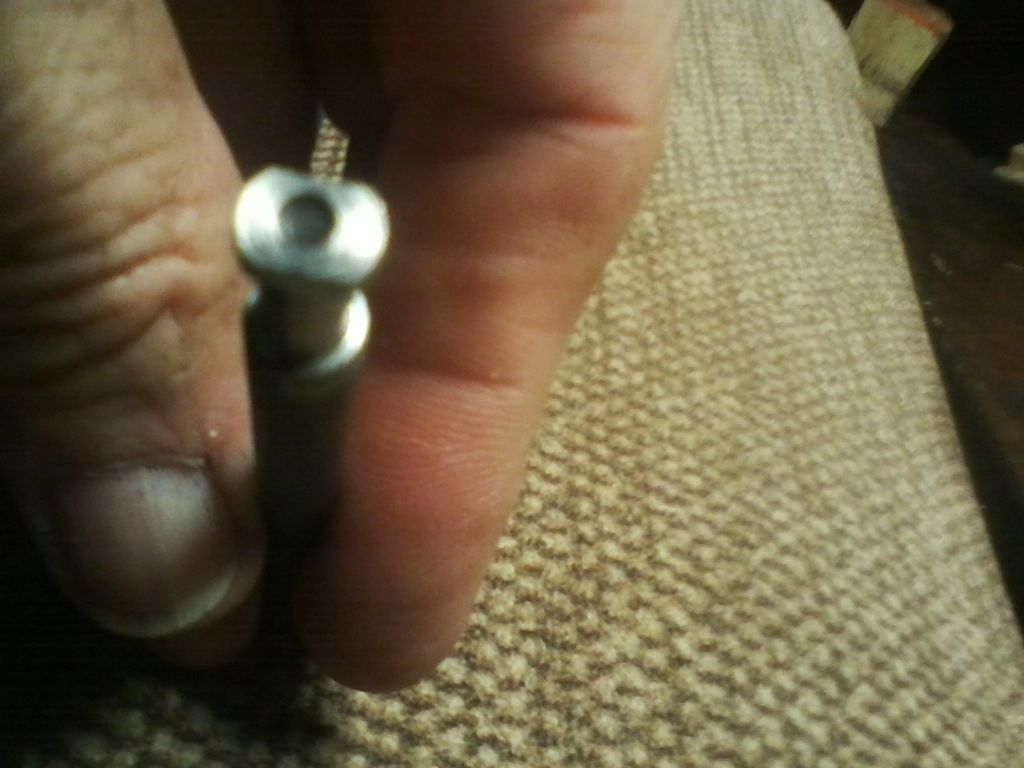

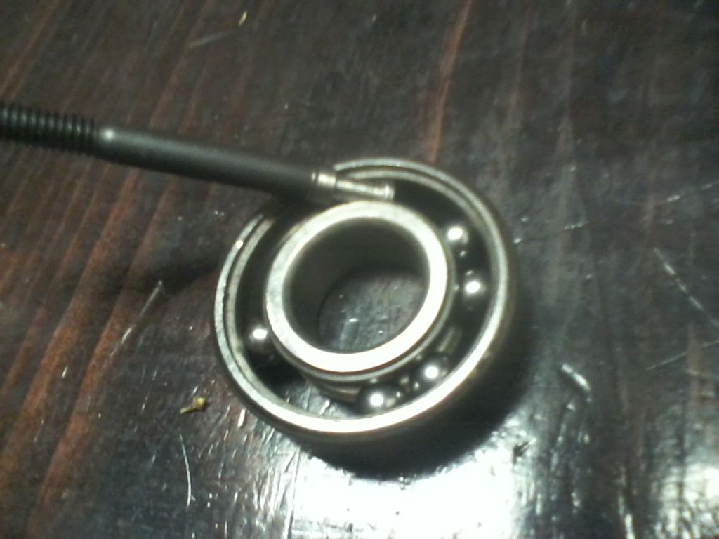

                        0425182223-00.jpgHere is a bearing removal tool that can remove a bearing that is in a housing with the shaft still in place.0425182222-00.jpg
                        #352213
                        mark costello 1
                          @markcostello1
                          The puller is made from a socket head screw using the hard head for the business end. It did not distort from the pulling. Made 3 but found out I needed 4 hands to use it, so I used 2 and only needed 3 hands.Used a standard pulling plate on the end of the shaft.
