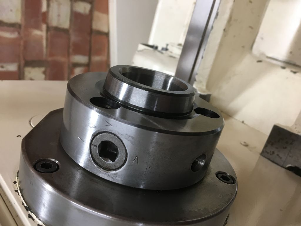

          Lee,
          I may not have selected the exact model of Boxford, but this is representative: **LINK**
          http://www.boxford-software.com/spares/NewImages/X10/02-9A.png
          The part labelled 02/010 is the main spindle.
          With apologies if I have completely mis-understood either your intentions or your ability: I think it would be wise to have a good look through these pages before you go much further. **LINK**
          http://www.boxford-software.com/spares/x10Menu.html
          P.S. … hopefully, at some more civilised hour, Nick_G will see your question:
          http://www.model-engineer.co.uk/forums/postings.asp?th=117193

            Question is why do you need to remove it are the bearings shot?
            Yes Nick has pulled his out, there are photos in his album

              Reading Lee's previous posts, I suspect he wants to take the spindle nose off in a chuck related fashion, not take the spindle out.
              My advice (having a Boxford 280) is don't do either if you don't have to!

                And to clarify, I believe that whilst there is only one part number listed by Boxford for the spindle and nose complete (02/010, as Michael shows), the nose screws off the spindle.
                The parts diagram linked only tells part of the story, as accompanied by this on Boxford's website is a listing of the parts and their description too.

                  Once again thanks for all the advice and links. I really don't want to get as far as Nick did and replace bearing etc this is just to clean it up and remove previous owners swarf neglect etc
                  I have cleaned the visible swarf just wanted to do a good job and essentially learn as I go cos I'm not one to not have a go.
                  I will take your advice and leave alone on this one but would be good to know for future ref.

                    I did try last night to unscrew but it was so tight and I couldn't get the spindle in a locked position tight enough for the pressure needed to unscrew it

                      Posted by Lee Goulding on 21/06/2017 00:49:55:
                      How do I go about removing this 👍
                      You don't.!
                      It's part of the main spindle and made as one piece. Unless there is a very, very good reason leave it alone.

                        Hi Nick
                        At least thats cleared that one up.. thanks for the advice i can now move on to the next task.. lol
