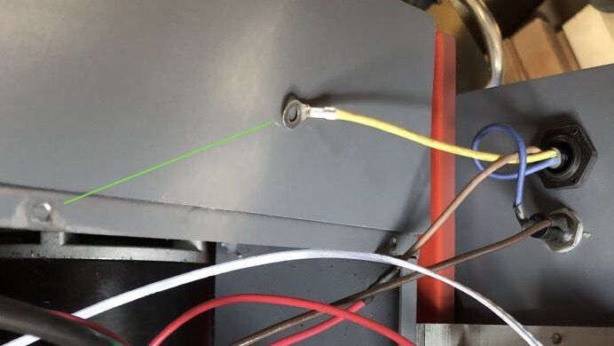

      Hi all, I wonder if anybody has any ideas on this problem. I've just bought and received a new mini lather: MosaicAL 600w 7×12 2500rpm with variable speed.
      Everything is absolutely fine apart from the issue i'm about to explain.
      I switched the lathe on and it worked perfectly. I adjusted the variable speed control to speed it up and then reduce speed and it was great for about 20 seconds. The there was a pop like a fuse blowing and the lathe went to full speed. No matter what i did with the speed control knob it stayed at full power.
      I have contacted the supplier but any ideas would be great.

          Sounds like the switching transistor has popped and gone short circuit . I have had IGBT 's do this but that was because i didn't pay attention to the gate voltage i was supplying it ! If it is new then claim warranty but get them to fit the new board or parts required to fix it then test it before you accept it back .

            Thanks XD. I took the back of the lathe off to look at the board and there was an item that had blown. It could be a transistor. It has the words MIN below it and the one next to it has the words MAX below it. This one is sound. I also noticed that the earth strap that should have been connected to the lathe was just hanging loose!!
            I've got in touch with supplier to get it sorted anyway. Thanks again.

                      Are you sure that earth lead was not sandwiched between the main body of the lathe and the cover, probably in teh hole far left of first photo.
                      They are adjustment Potentiometers
                      #370743
                      Derek Leggott
                        @derekleggott56008
                        Hi Jason
                        There's a screw in the main body bottom left that it should be attached to via a nut. It hadn't been fixed and was just left floating around.

                            No, it's a preset pot. It will be used during manufacture to set a limit (minimum looking at the silkscreen) that the actual speed control pot will work between.
                            To blow the preset apart like that means something is seriously wrong. I suspect it's had mains, or the output voltage up it, which is worrying. One would hope that it's an assembly fault rather than a design flaw.
                            Don't even think about getting the board repaired; the supplier needs to replace the whole board.

                              A much more worrying aspect about this is that it appears that the NEUTRAL line is fused instead of the live line. If the fuse was to blow it would leave all the electronics at mains, 240VAC, potential which could prove lethal.
                              In this state the lathe will not comply with basic standards and certainly it will not comply with european/UK regulations. I would demand a full refund and get the seller to collect the lathe. If UK based then I would also raise this with the relevant trading standards authority.

                                I think you might find the 'unattached' earth lead was sandwiched between panel and housing using one of the fixing screws.
                                Not a very good idea as it could be insulated by the paint.

                                      Some serious power needed to blow a pot that spectacularly and only one component is effected, so the problem might be local to the pot. I wonder if the board is incorrectly stood off from the heat-sink – short pillars, or missing insulation underneath? I vaguely remember another example where a board blew when it touched the metalwork due to a simple installation error. It's the kind of assembly mistake where everything tests OK at the factory but…
                                      Martin's concern about the mains wiring needs checking out; the wire colours imply it's the wrong way round. The 'Live' pin on the plug should connect to the fuse, not the neutral. (This risk of having a fuse in the neutral line is that the equipment is still connected to mains power after the fuse blows, which might be a nasty surprise. )

                                            I doubt it's long enough to reach that point with the panel in place, I think it went with the one to its right – which seems to have intact paint…
