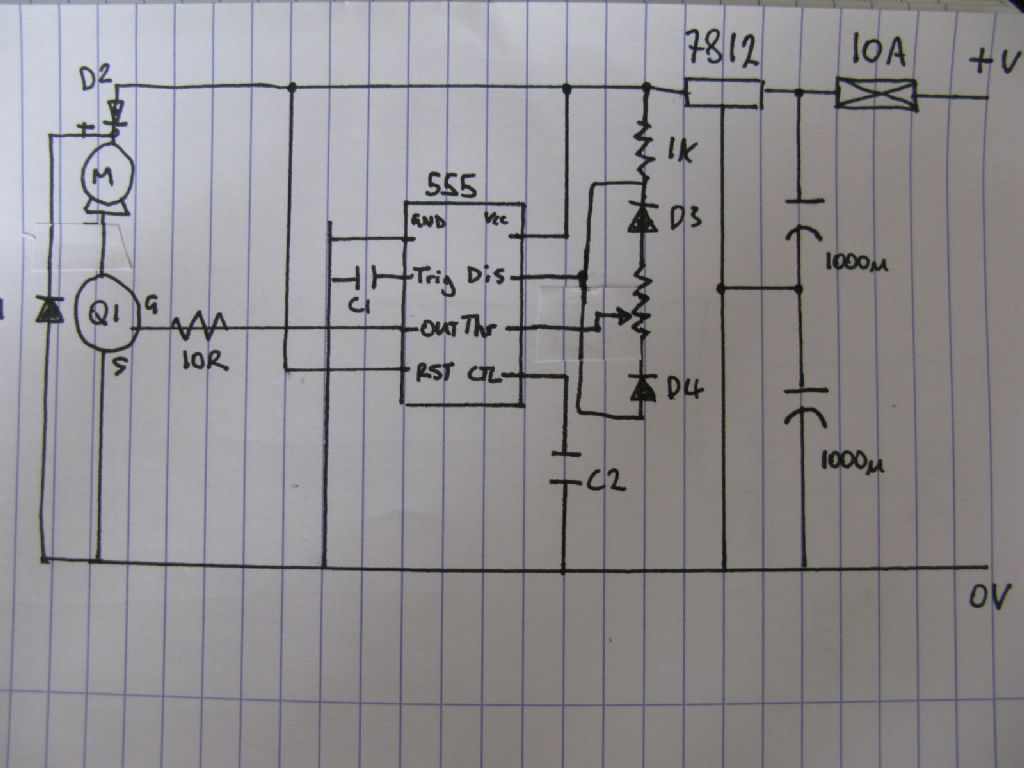

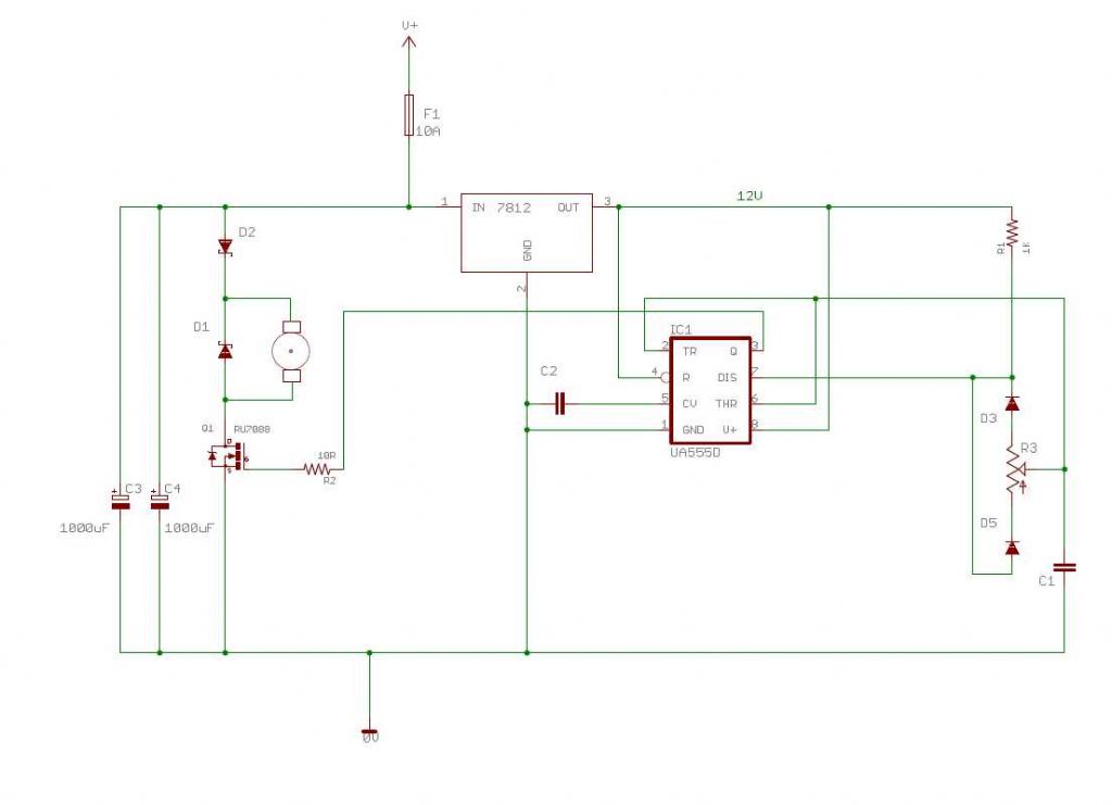

Confession time,
No the 10A fuses have never blown
I checked the Schottky – OK
And there was no short on Q1 D to S
So I checked the output of the 7812 OK at 12.1 V and concluded that with all the other diodes ok unless the 555 was dead there couldn't be much wrong so I bypassed the C/O switch and … It works
The C/O switch is dead.
I definitely blew one up as I shorted the output, but perhaps the second one is ok and the switch fault was intermittent.
The motor is a Parvalux PG4568 rated at 1A continuous 14W, 21W 15 min , 17.5W 1hr. It barely gets warm when powerfeeding
In terms of the basic design I take the point about no over current but I'm using a laptop PSU which itself has in built protection.
Now some questions
If I wanted to fix the dead one what device would you recommend to replace q1 ?
If I did want to change direction whilst power-feeding is it vital to ramp down the PWM before switching through zero?
Is there anything else that one could add easily to further improve it ? To me it does not look that different to the Inchanga design apart from the bipolar drivers.
