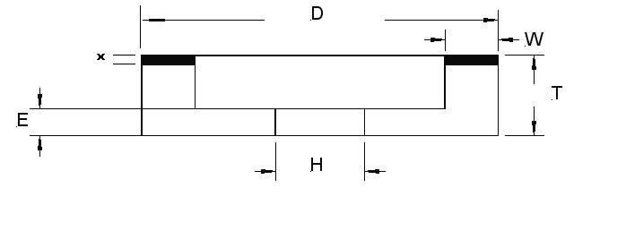

                                Well I've learned a lot from the responses, but I have not got to the point where I can order up something that is listed on a hobby suppliers or other site as it seems they don't give the full specification of the wheel.
                                This is what I have today and I expect that I want to get a D9 version of this D76 wheel
                                E= 10mm, D=150mm, W= 10.5mm (ideally this can be much wider), H=63.5mm | 2.5" (not critical as I can bore it out), T= 38.4mm, x=3.25mm
                                Failing another option on Monday I will ask for a quote for a special "D9" version from http://www.abtec4abrasives.com but there must be something close as a standard product thats easy to buy. All hints appreicated.
                                Steve
                                Edited By SteveI on 25/07/2015 15:55:10
