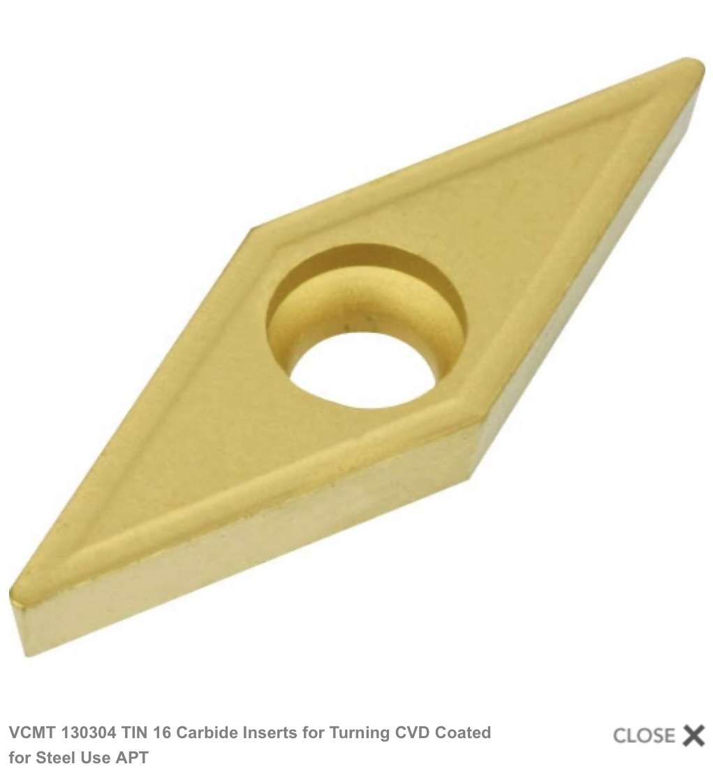

                          Vic
                            @vic
                            On JasonB Said:
                            Square don’t work well on ball turners, even triangles start to have too much of the side engaged. DCGT with their more pointed corners will give you a smaller diameter “stick on your lollipop”
                            This is the type I used. It seems to give better clearance.
                            https://www.shop-apt.co.uk/carbide-inserts-for-turning-apt/vcmt-130304-tin-16-carbide-inserts-for-turning-cvd-coated-for-steel-general-use-apt.html
                            IMG_3554

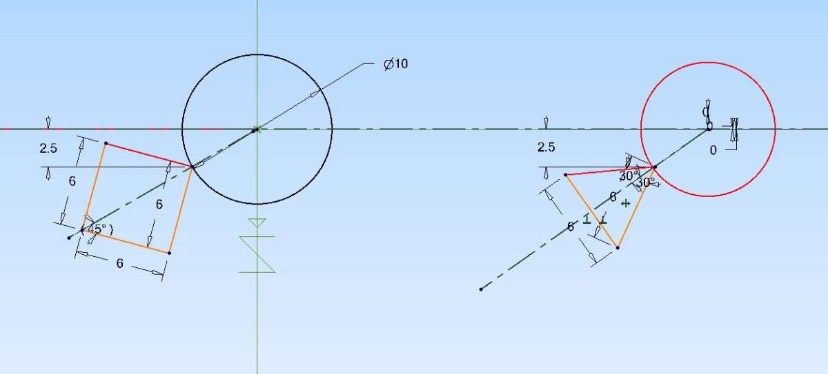

                                  As a few others have said the square inserts can often limit the diameter of the supporting shaft when turning a ball. Does depend a bit on how you mount the insert but most seem to have then mounted centrally so you can cut in both directions.
                                  The example below shows a 10mm dia ball being turned on a 5mm shaft with the triangular insert on the right. Try that with a square and the more obtuse angle cuts into the supporting shaft.
                                  I’d be interested to see how you have your ones with square insert set up.
                                  sq
