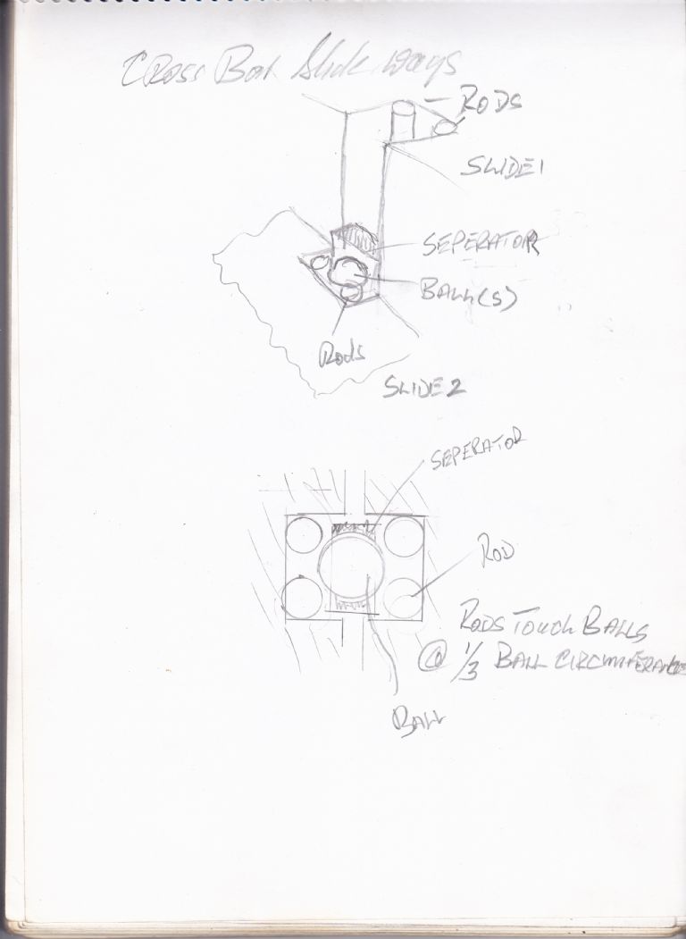

                                  Richard Parsons
                                    @richardparsons61721
                                    Do you mean something like the drawing. I am working on them to use on a small planer I want to build. The original I want to use as the stage on a micro drill (if ever I can get a picture of the mechanism of the Boley model
                                    #71743
                                    Richard Parsons
                                      MikeG Yes I know about the gib. I am only going to use this type of slide way if I can get the necessary rod/wire and channel. As to the problems of swarf that is the least of my problems. I plan that the ‘balls’ will contact the wires at 1/3 of the balls circumference. Does this sound too wide a contact angle?
                                      I will be using channel because I am going to build the rest using Epoxy-concrete mixture
                                      Rdgs
                                      Dick
                                      #71746
                                        Dick,
                                        Could I just mention that I much prefer to be called Michael.
                                        With that off my chest … 1/3 of the ball circufrence sounds quite reasonable to me.
                                        I’m delighted to hear that you are using Epoxy-concrete; it’s something I have wanted to try for years, but never got around to. There was a lot of good work done at Cranfield in the late 1970s / early 80s. … If you haven’t already done so; try a Google search for Granitan.
                                        Please let me know how the build goes.

                                              Richard Parsons
                                                Michael Sorry about that. I just cut and pasted the name on your post.
                                                Actually has a look at this thread ‘New technology in Model Engineers Workshop’ it is a long thread. I am thinking of using the techniques as metal over here in Hungary is very difficult to get, but I have a large garden full of the most wonderful sand. I want to build a planer. It’s size will depend on the materials I can get. If I have to use the classic machines slide ways I am limited to about 16” (406mm) with a table of about 7” (178mm). If I can get 3-4mm hardened rods and can find or make suitable channel steel I will build a 24” (610mm) long machine with a 10” (254mm) table.
                                                At the moment I am trying to calculate what and where the stresses are on the guide ways.
                                                It all depends on getting everything I need locked away before I start. By ‘locked away I mean ‘locked’!
