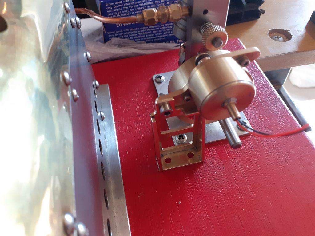

            Hi Mark welcome to the forum. As to the soldering of brass parts the colour of the solder may not matter as much as you think. The method and use of the solder, it's strength and ease of use is more of a quandary to what colour it is. You should get a few scraps of brass and have a practice as the type of solder what flux you use will be better practised and will become more apparent with trying diferent solders for diferent jobs. Here are a few pictures of a small generator made from brass strip both lead and silver soldered in diferent parts. You can't see the solder easily after cleaning up.

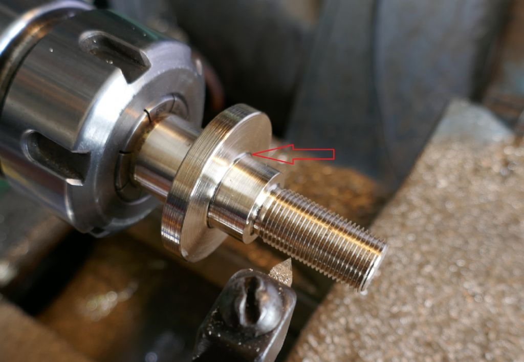

              As mentioned, the lower % of silver in the solder is more brass coloured. The higher % grades flow better and has a lower melting temperature. The Donatus kit looks as though it is made with lots of turned parts and if finish machined after soldering, the small amount left will be hard to see.
              This is a brass spindle that I am making, the large flange has been joined to the spindle with 45% silver solder. The silverish colour is hard to see because it reflects then colour of the surrounding brass.
